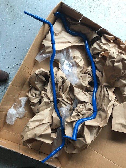

I got these in today. Any tips for install or pretty straight forward.

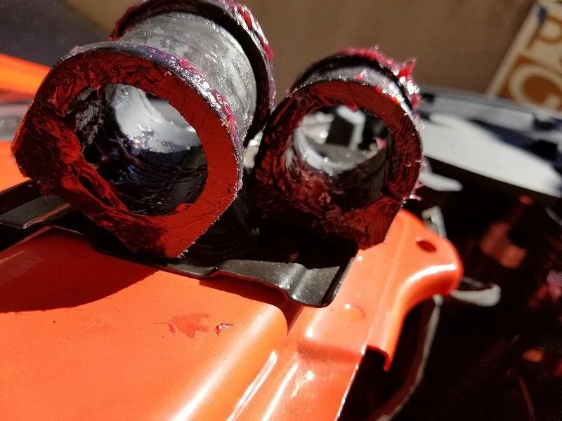

Also, he sure to seriously grease those bushings. I had to remove and re grease mine 3 times to get the squeaking to stop.
The results will be well worth the effort.
Literally this much lube:
20170622_092835 by chefjpd, on Flickr
