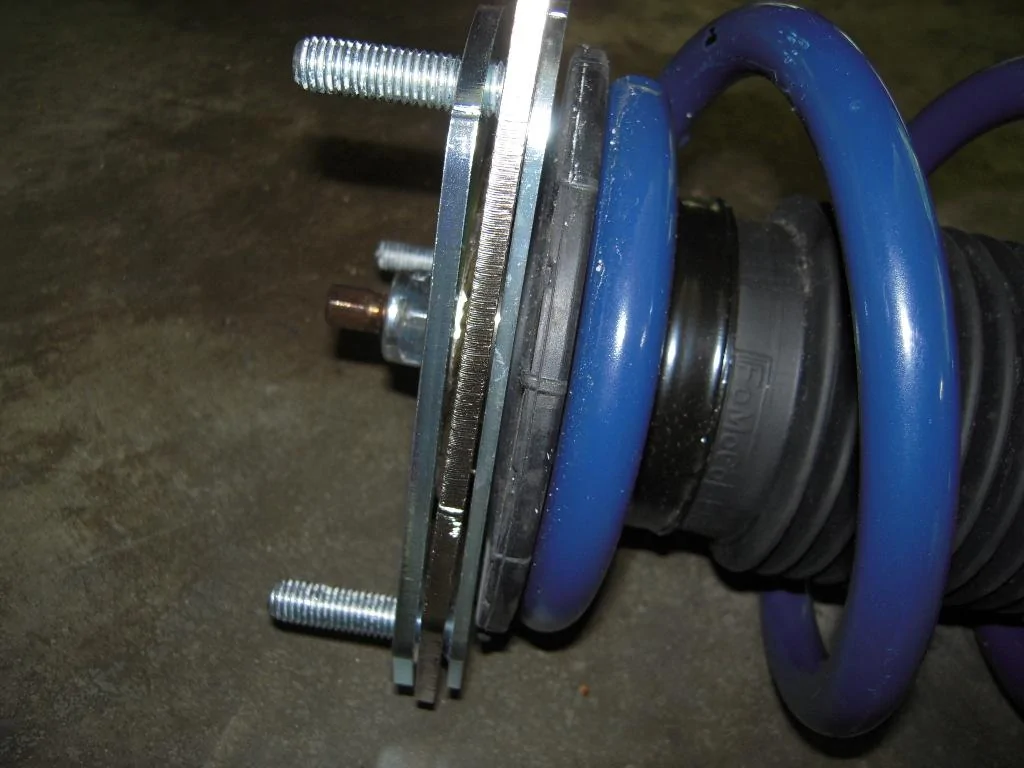

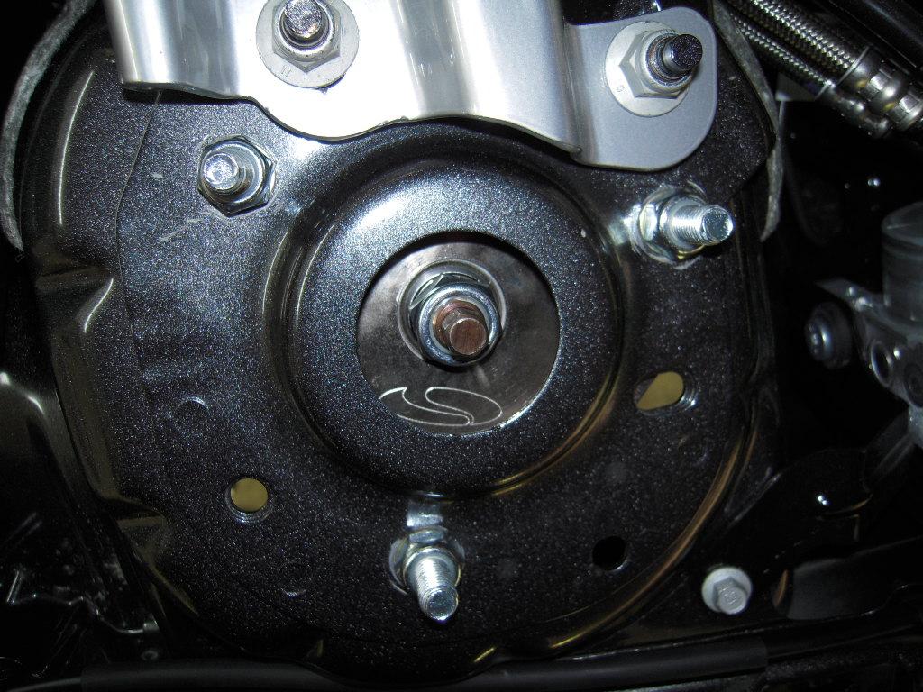

Did this install today... total time was about 2.5 hours, taking it easy. It's really a buttermilk install in case anyone is on the fence. Beautiful product.

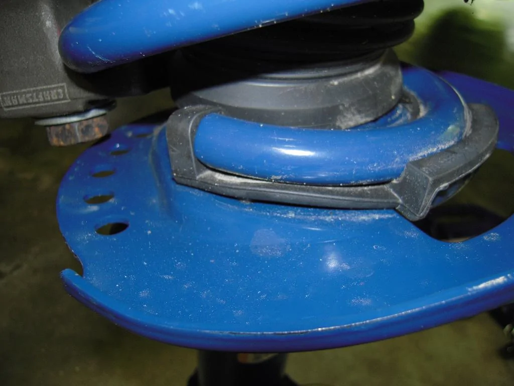

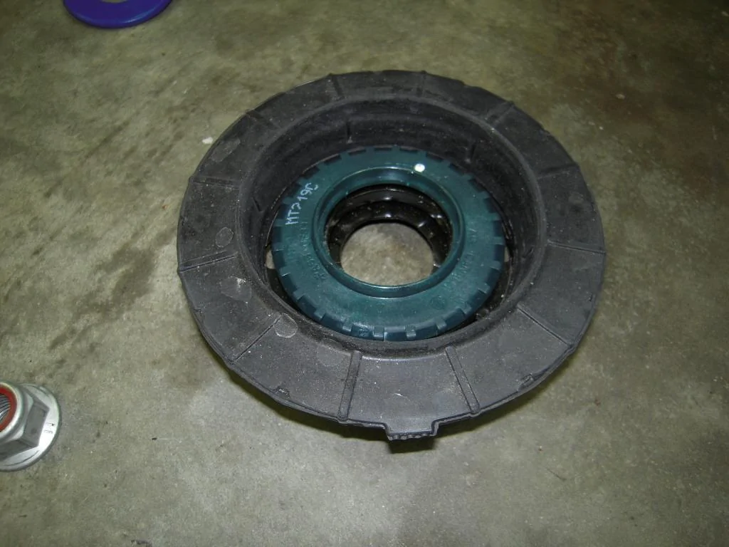

The only thing you have to keep an eye on is the lower spring perch when you're putting it back together. I also took a rough frame of reference on the strut to hole before disassembly to get it back pretty close for the trip back to the alignment shop. The factory upper spring seat/bearing separates very easily from the top mount. The steeda plates are pretty beefy - adding a little over 1lb per side. That's about the only downside to installing these that I could see.

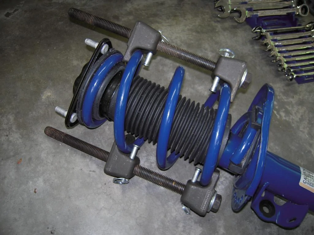

I just installed mine about a week ago and agree. It really wasn't bad and I had never installed struts before. The closest I've come was to remove the entire assembly and take it to a shop and have them disassemble and reassemble them for me and I just installed. I really liked how the camber plates came pre-assembled, then zip tied together in the proper configuration. I used the same spring compressor too that I rented at the local auto parts store for free for up to 5 days. I didn't want to drive it much until I got to the alignment shop. Looking at the alignment, I didn't do too bad. I just kind of centered the strut nut in the top opening and they came out to -2.0 and -2.1 and I wanted -1.7.

Just installed these this morning, I could not for the life of me get the spring compressed enough (clamshell type) to put the top nut in place on the strut. I ended up loading from the bottom. It went quick but wondering if there's any issues with doing so, FYI it's done and I've driven it about 30 miles already with no issues...just looking for feedback if anyone has done it this way?
I can't figure out what you mean, how you assembled it. Can you describe what you did? I can't imagine getting everything lined up properly and assembled without the spring in the way and then easing the spring out with everything aligned. It sounds like you're saying you assembled everything loosely with the spring uncompressed and used the weight of the car to compress it?
Correct. Spring uncompressed and then compressed with the weight of the car and lined up from below using a jack and jacking it up slowly.
Wow! I can't imagine doing it that way, trying to keep everything aligned but if you managed to do all that and keep it aligned, you should be fine.

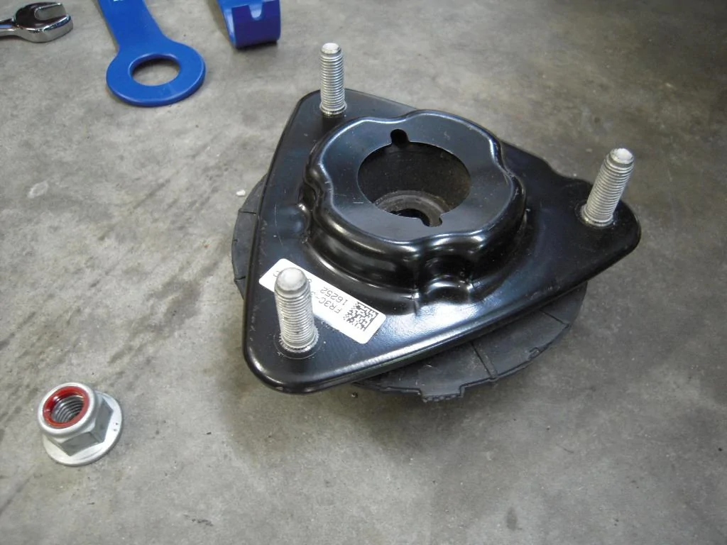

Has anyone reused factory strut tower nuts?
The ones steeda provided are shorter. I prefer the factory nut look.
