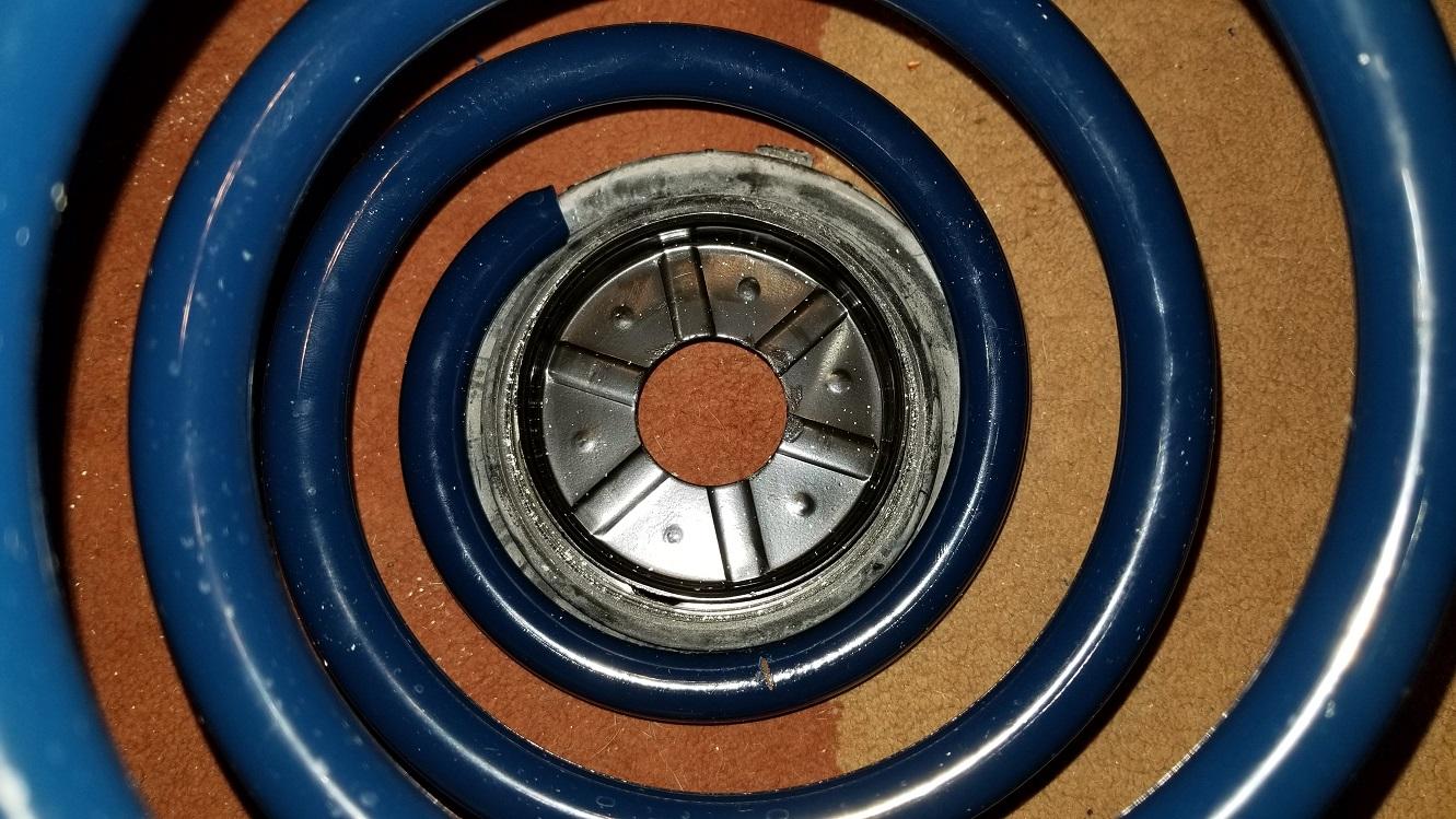

I've been playing with the stuff I have at the house too..
It's concerning how sloppy the spring is in the upper rubber insulator.
Why is it this way.... Is the slop gone or is it just not a problem once installed?
Seems like if you were to go over something big enough to unload the spring it could certainly move around on there..
I have another brand here and it just seems like it's made exactly for the strut and insulators..

Mike - [MENTION=25806]SteedaTech[/MENTION] - from Steeda called me yesterday and walked me through everything. Really phenomenal service from Steeda throughout this entire research/order/install process. It's refreshing to work with a group that doesn't give up on the customer once the sale has been made but follows through and seems to really appreciate the relationship.
1. It is normal for the spring to not seat in the top rubber isolator until the car is on the ground. Make sure you orient the spring such that the larger opening is on the top. Once the vehicle is on the ground, it'll align correctly.
I had Ultralites on for probably 15K-ish miles? No issue. I didn't like it either, and frankly still don't, but... no issue.
The reason they're "ultralites" is because they're lighter. How do you think they get lighter? By not having extra metal on them. :)
