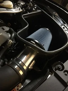

My Online Question to Steeda- A few months ago my wife purchased the Steeda Cold Air Intake (555-3193) for my 2015 Mustang GT Convertible. Now that it is getting warmer I noticed that the inlet temp is much higher during slow driving or while at stop lights. For example yesterday the Inlet Air Temp shows 158 and the Outside temp showed 89. Once the car got up to highway speeds for about a mile the Inlet Air Temp temp went back to within a few degrees of the outside air temp. I think that the CAI seal is not sealing properly and is allowing hot engine temps into the CAI box. Does Steeda have a taller seal that would help seal the CAI box thereby reducing CAI inlet temps? If not any suggestions?
Steeda Response- Hey Roger, the IAT will always be higher and rising when the car is at idle or sitting still. Once you get moving it should cool on down. That is normal functionality of a CAI. Nothing seems to be wrong with what you have explained to me.*
My solution was to purchase a small trash can from Home Depot cut it and then use adhesive / sealant with rivets to fill the gap. I also opened up a few of the hex holes in the grill.
In my opinion, it doesn’t look too bad. Now my inlet temperature does not rise that high(even at idle) and cools much quicker when driving.
It is my hope that Steeda could design and sell a new CAI that will seal against the hood insulation. Additionally Steeda should design and sell a tall bulb type seal kit or other solution that current Steeda owners could purchase to seal the CAI from the hot engine bay.
I have passed this on to our product development team for review & feedback. Completely understand your concerns with the temperatures. We have sold 1000s of our CAIs & they continue to be one of the most popular on the market.
The intake is made to provide more airflow and it does, and the temperatures of the intake also come down as long as there is airflow, so you are not loosing performance as long as you are moving and you have airflow.
If you are moving - you are accelerating which is where the intake is designed to improve performance vs. sitting at idle.
Additionally - we use this same CAI on our test fleet of Mustangs - on & off the track, some meant for racing & they perform great.
As mentioned above, I will provide you feedback for review.

That looks pretty good!
JRENIGAR
Apr 7, 2017
43
Wynne, AR 72396
2015 Mustang GT A6 3.15 premium
I cant tell anything was done to the heat shield. The pic wont blow up any from the posted size. :shrug:
