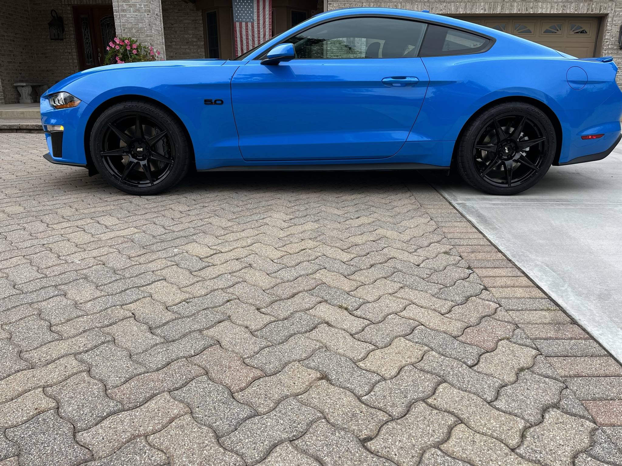

Pics of my setup, stock suspension if you’re a visual person like I am. Lots of pics for 19” in the aftermarket wheel pictures thread too.
