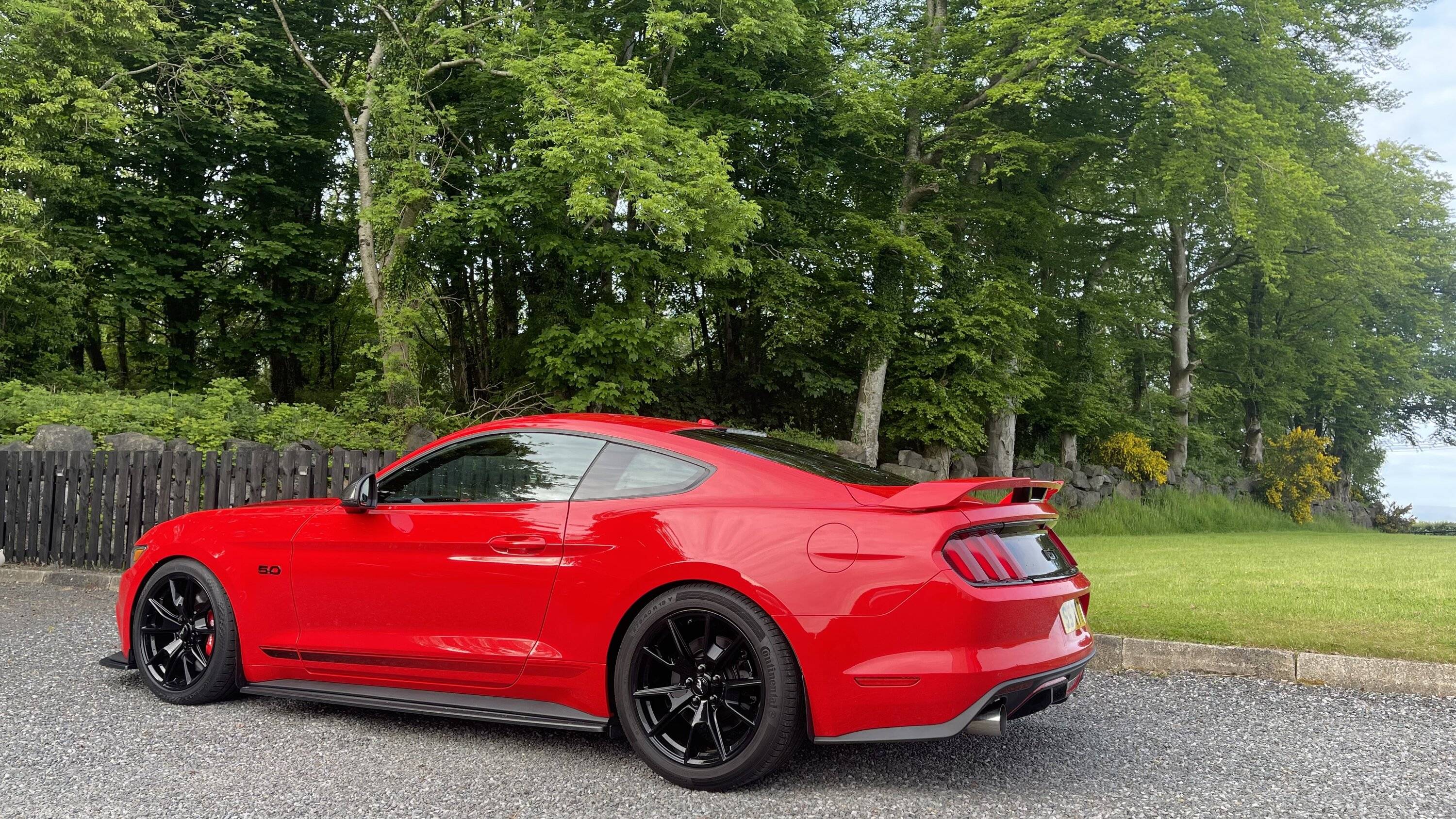

I don’t like the bolt on spacers at all, I went with 15mm spacers and longer studs, much safer option to me.
Ford supplied Eibachs with 15mm eibach spacers, no rubbing.

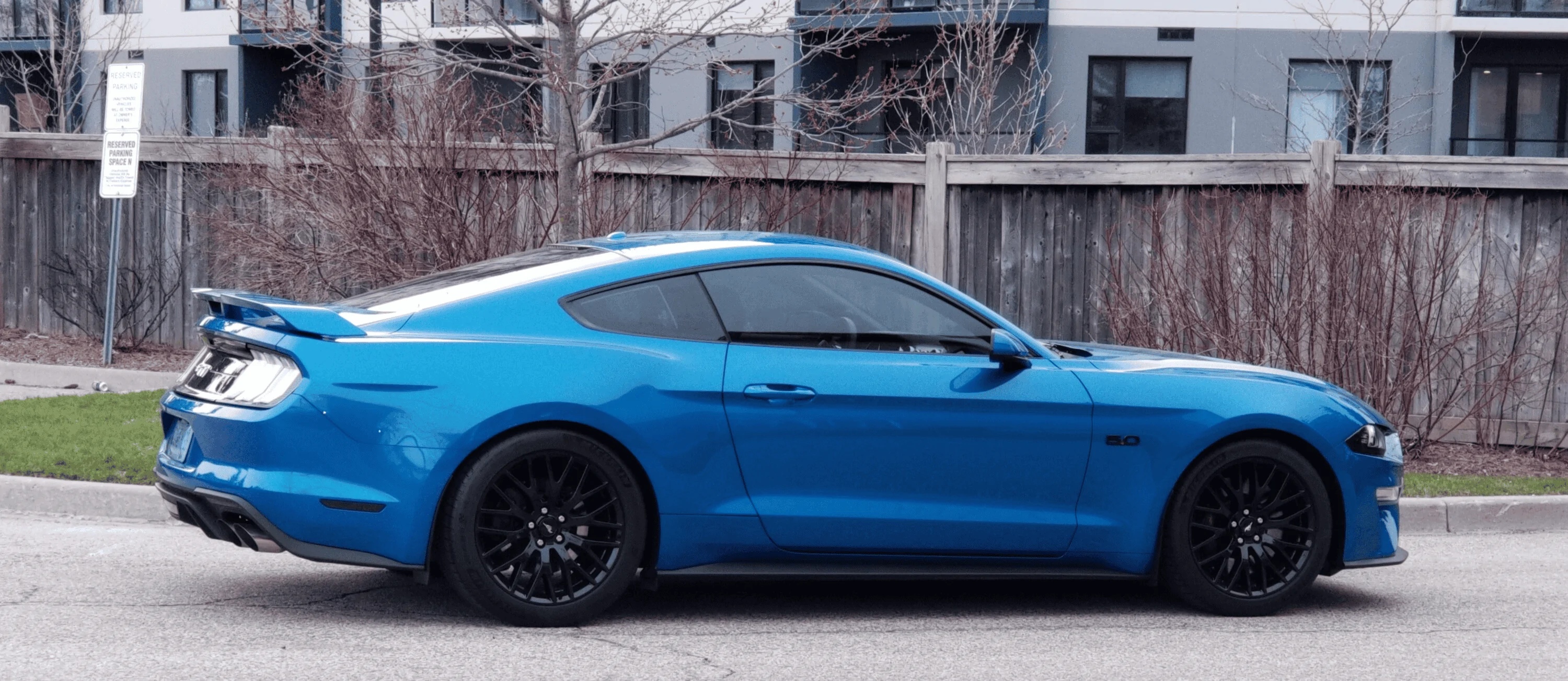

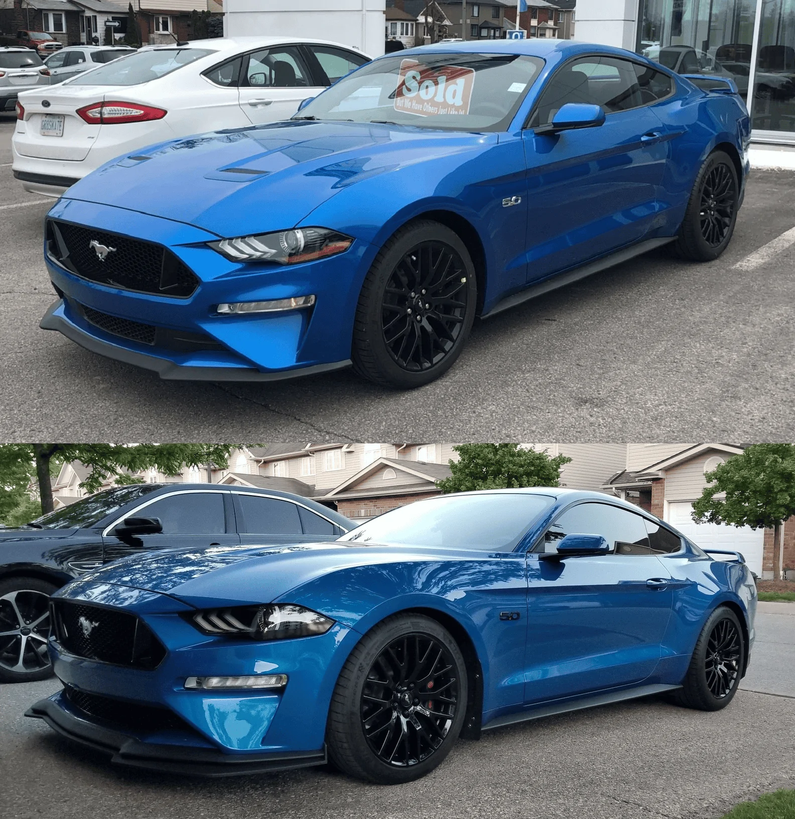

Steeda minimum drop springs. No spacers. I think they offer the perfect amount of lowering and spring rate.
Stock height in the first image.
That does look good, it's just after a while the front will start to bother me and i will be thinking if only i went a little lower at the front.
