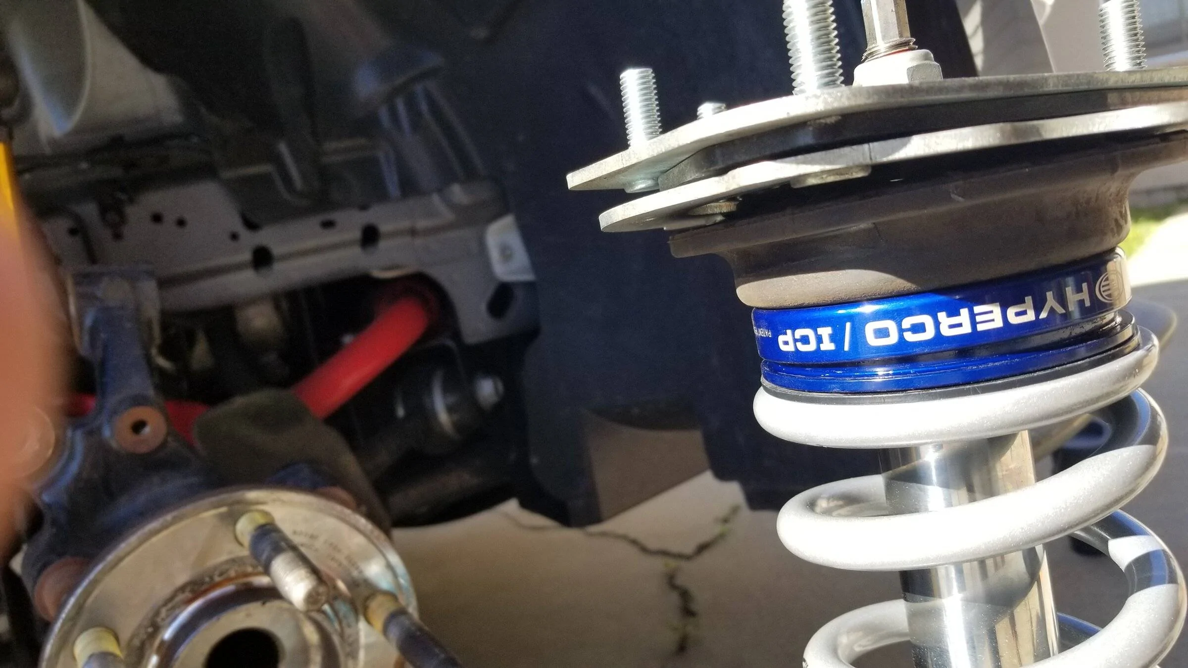

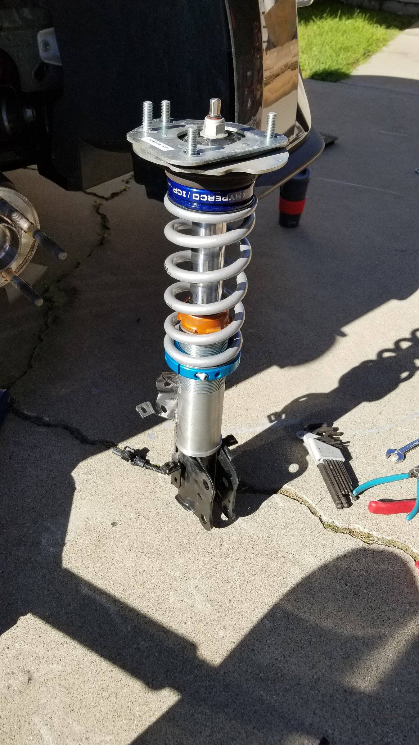

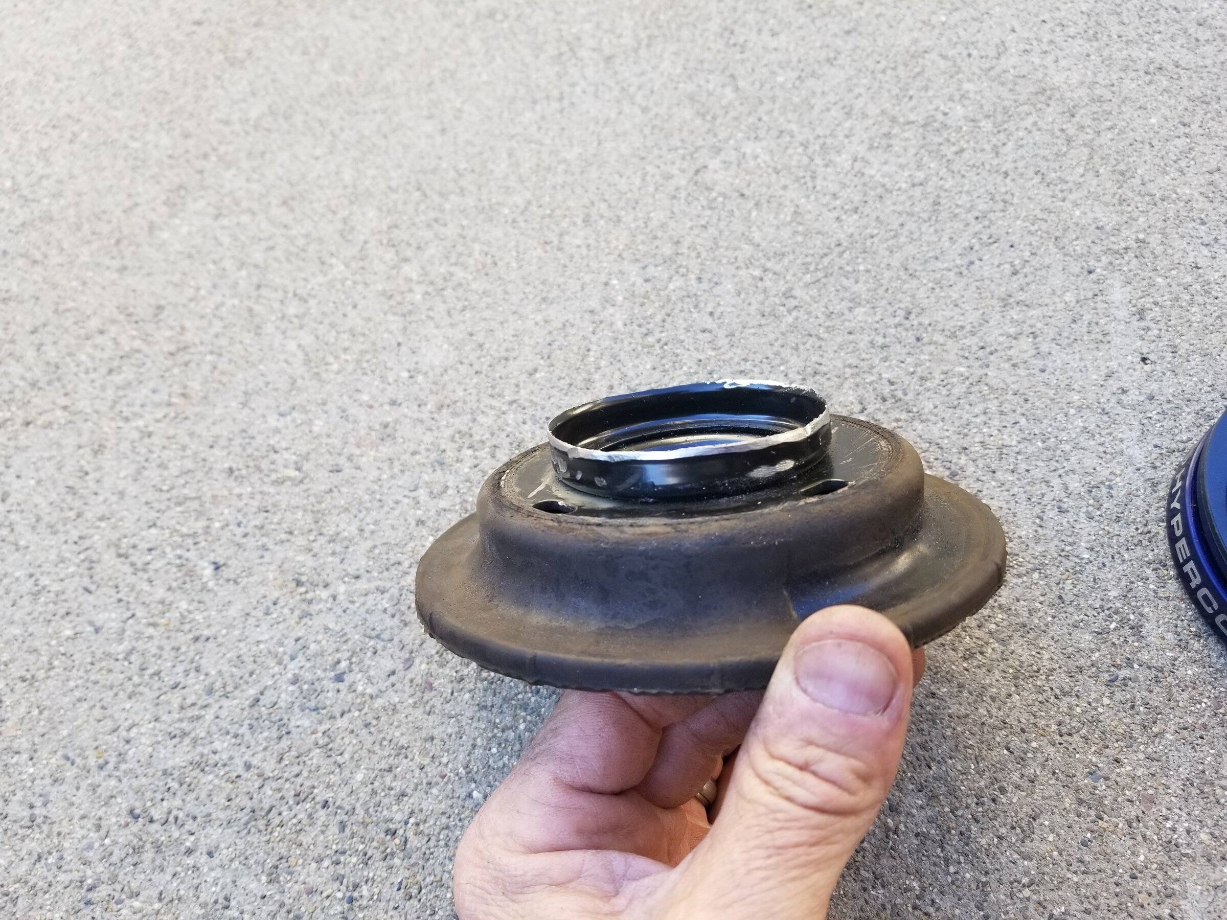

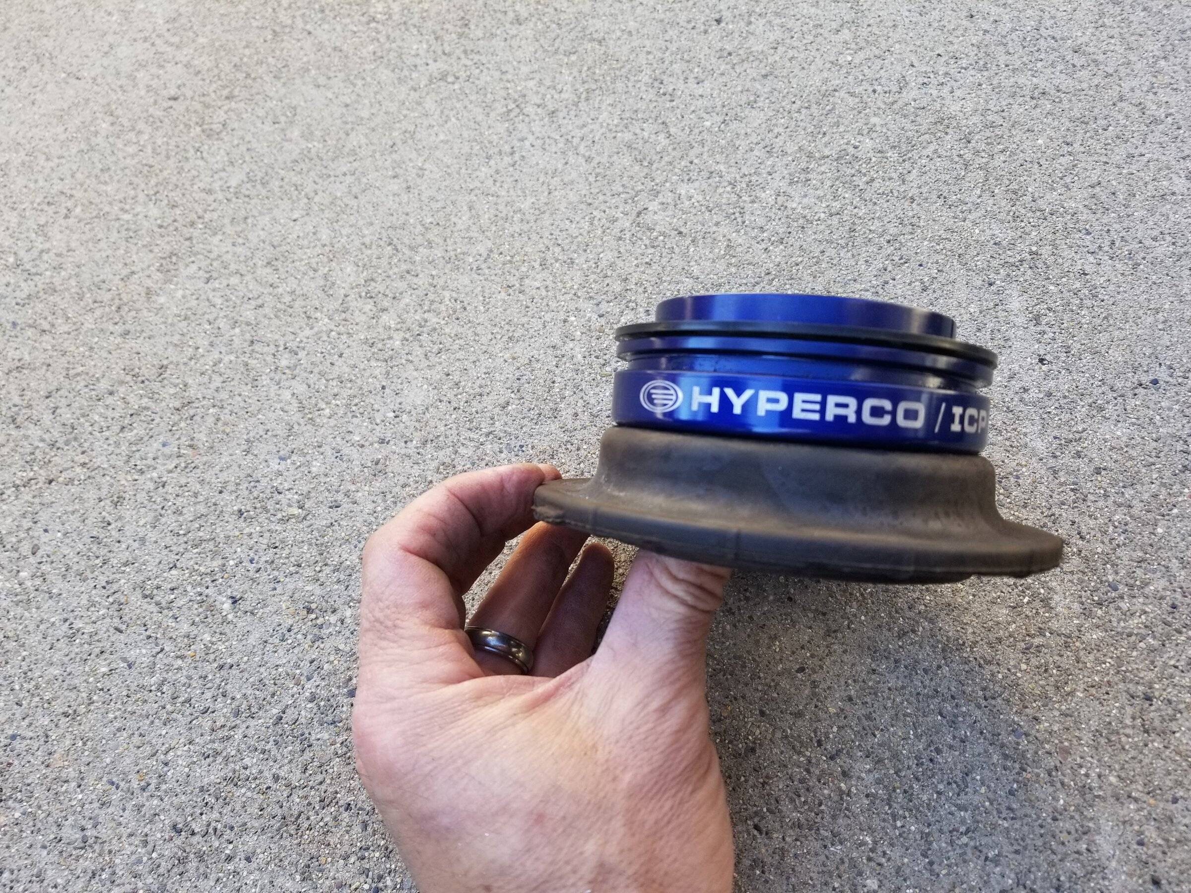

At this point, I had to make a decision. I could use race springs on the back of the car, but the front was restricted to OEM style springs. I needed coil-overs, but I wanted to stick with the MR suspension. Thatās when I got the idea of converting Magneride struts to coil-overs. Tractive is a company that produces very nice MR racing dampers, but they were out of my price range. What I was able to do buy the Shelby 350R struts, which have about double the damping forces of the standard Mag struts (which is on every other model, even if the programming varies). I knew I wanted to throw some spring rate at the car and this was only going to happen if I could match the rate with additional damping. So starting with these struts, I made a pair of coil-over which accepts a 3ā ID springs. I wanted to use 2.5ā ID springs, but the Mag struts are just a little too big in diameter to accept those. Anyway, 3ā ID springs do kind of limit my choices, but itās really not that big of a deal.
With the coil-overs built, now was time to put it on the car. I knew based on the front spring I was using that I wanted a big step stiffer, so I went up 50+% to a 450 #/in spring on the front. As usual, I tried to use too long a spring (8ā) and got bit. The front ride height is OK, but unless Iām running big wheel spacers, the inside of the tire makes contact with the lower spring perch. So, all I should have to do here is use a shorter spring (6ā) which will allow me to move the spring perch out of the way of the tire. The problem there is they only had a 400 or a 500 in stock. There was no 450 available. Which will it be? Why stop at Chicago on your way to New York? I got the 500. As of right now, I havenāt installed these. Mostly because I like the 450ās, but think an extra 10% stiffer might be a little much.
