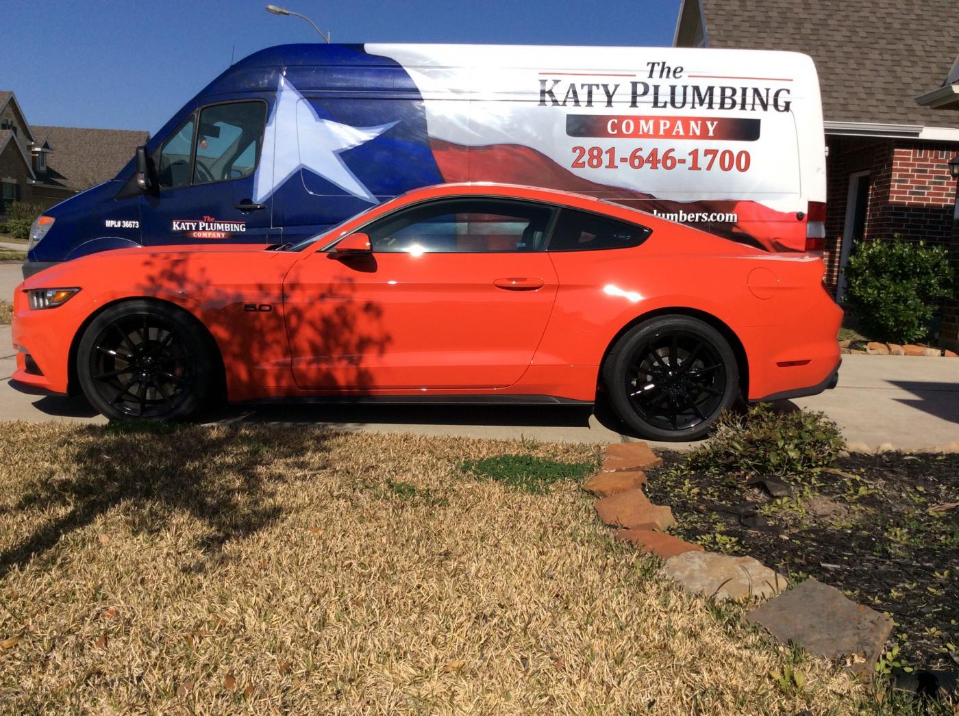

Side

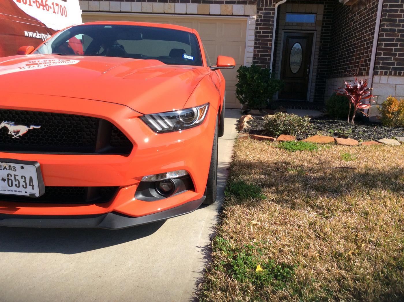

Front

Hmm....
The gap definitely doesn't look small enough, but maybe it is a shorter tire or something.
I would give it some time - and also clock the bushings, and see where that gets you.
I can't really compare the before and after from pictures, as that is very hard to do with .50" drop. It does appear to sit a little lower, but the photos are not replicas of the side shot.
I do think the slightly shorter tire out back is definitely making a difference here - because this is a very rare occurrence. When you are dealing with such a minimal drop, .250" in tire height increase or decrease plays tricks on your eyes when looking at wheel gaps.

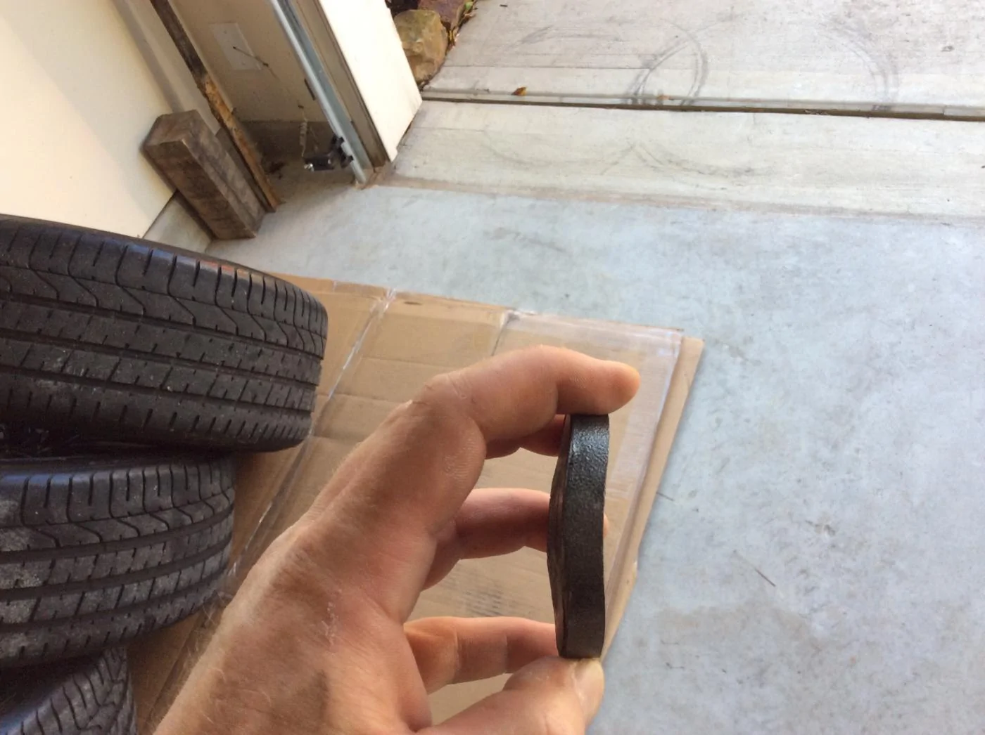

Can you post the picture of where it was sitting on the bushing?
Something isnt right...lol

We had the cup against the bushing trying to push it

I can send you as new plate....but if it happens again, something else is wrong and we need to look into it.
That would be great
