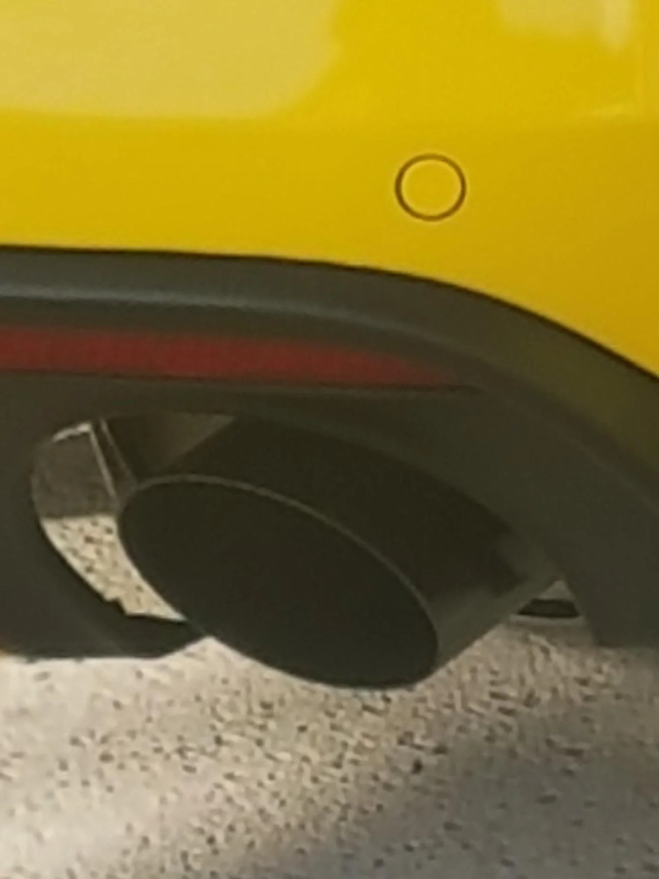

Tips sprayed with exhaust paint... but had too go abroad (work)... so no movement until late next week on fitting etc.

no pics yet -
but seriously - some of the "black exhaust or High temp" paint is just grey - and crap -
hence it has 20 coats on the tips - 4 different types of paint
- still not really happy but will take another look when I get back to the UK
Also folks - dont get too close when you are spraying from a can - a bit light headed and a severe headache afterwards - and that was spraying outside - with a mask etc!

Put a non gloss lacquer over it if you want, i found the same it's a very veyr dark matte grey. Also spray in left to right and then cross hatch patterns to bring the colour up. And finally, high temp stove paint is very thick so you can spray on thickly.

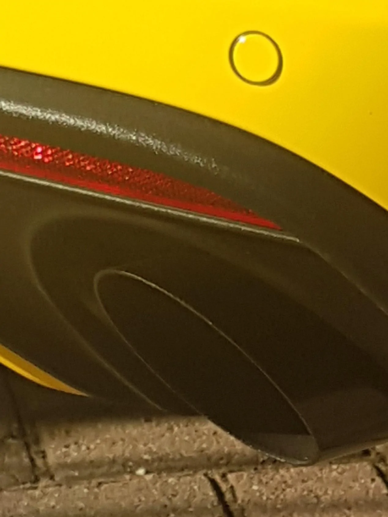

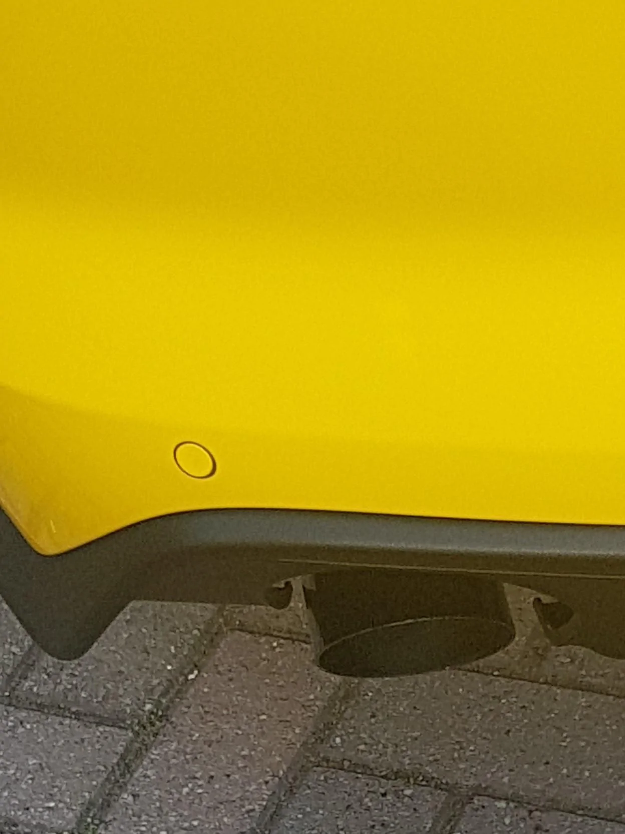

spraying the tips was pretty simple - as the exhaust was off the car at the time!:D
But still - preparation is key, completely cleaned the tips with white spirit and a lint free cloth
then set too with 2 cans of heat proof black paint (Halfrauds) - but as per above - it came out a kind of matt dark grey finish (many many thin coats)
So - I went back to Halfrauds - and got some clear lacquer - and again many many thin coats - it put a gloss on them and protected the whole tip too
but - the exhausts do seem to "disappear" into the rear valance a bit!
