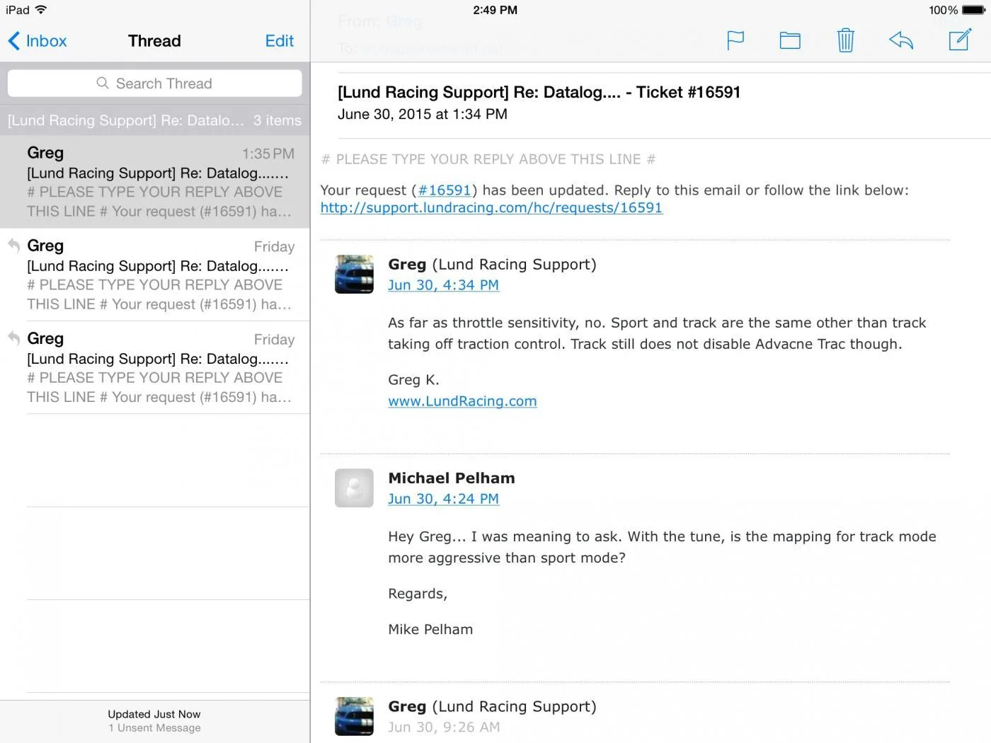

MikeyPee
dissmember
Apr 25, 2015
65
785
214
Commiefornia
2015 IS Premium GT w/PP
I do have one question though to anyone who's running a tune on their car (specifically with the GT PRemium cars). How does the tune get applied to the 4 modes? Do all 4 modes still work? Does the tune get applied to only 1 of the modes and then the other 3 modes default to the factory tuning/ mapping? Can you get 4 different tunes for each setting? Sorry for all the questions but I've been curious about this...
I forgot to ask Greg at Lund about this. FWIW, sport still feels much stronger than normal, and track stronger yet.
MikeyPee
dissmember
Apr 25, 2015
65
785
214
Commiefornia
Guess that answers that...
