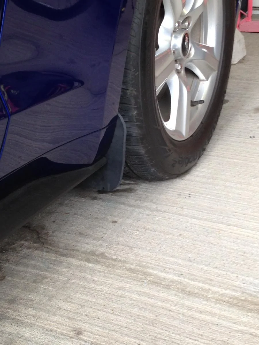

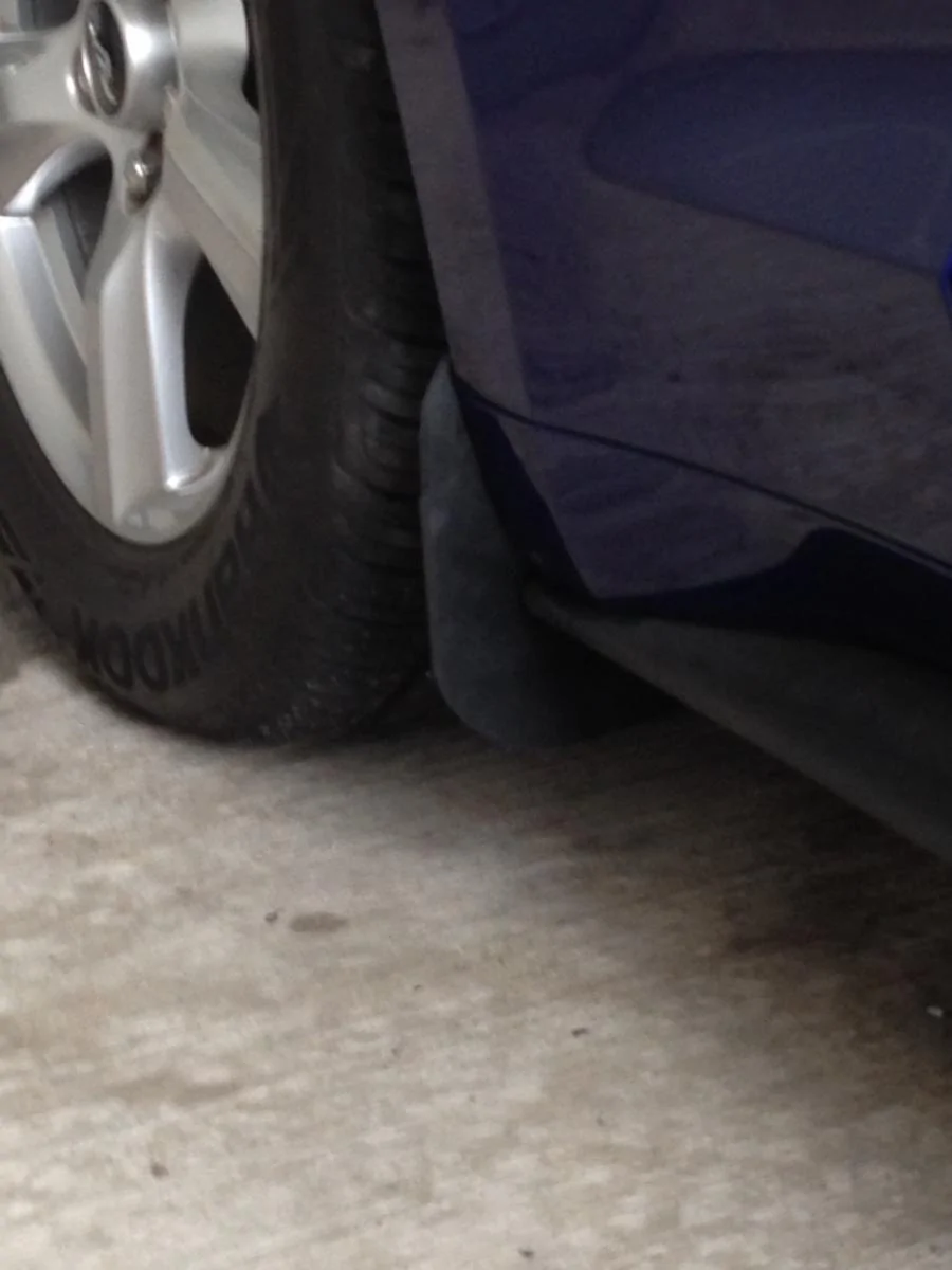

I installed the fronts. Not very happy. Neither of them had the 3M tape in the same position as the other. And once mounted, one of them took me 15-20 minutes using my nails to get rid of the excess tape. In fact, as far as overall usable length goes, the top is inward to the wheel-well 1/2" more than the other-side is that did not require any "Cleanup".
Pretty disappointed overall. Waiting for a warm weekend to try the rears.
Defiantly looking forward to custom fit ones...

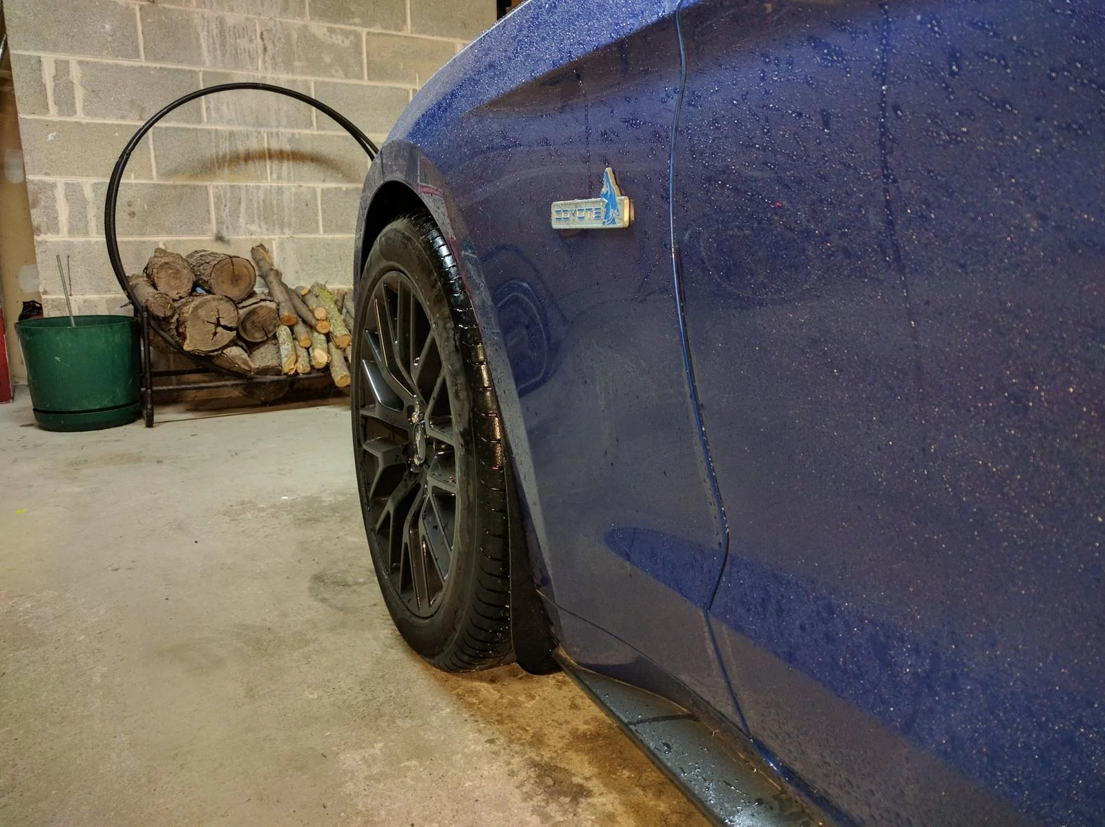

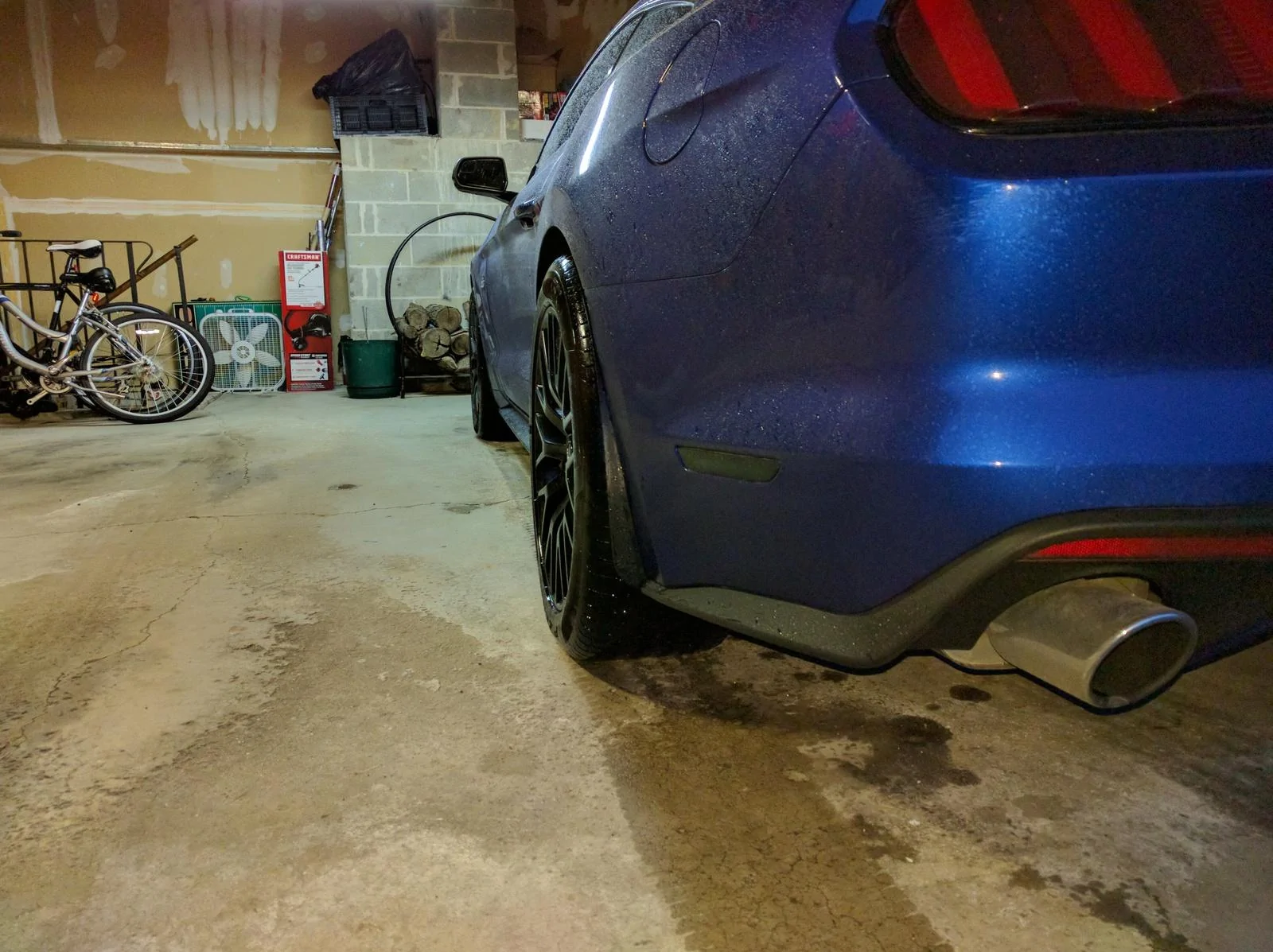

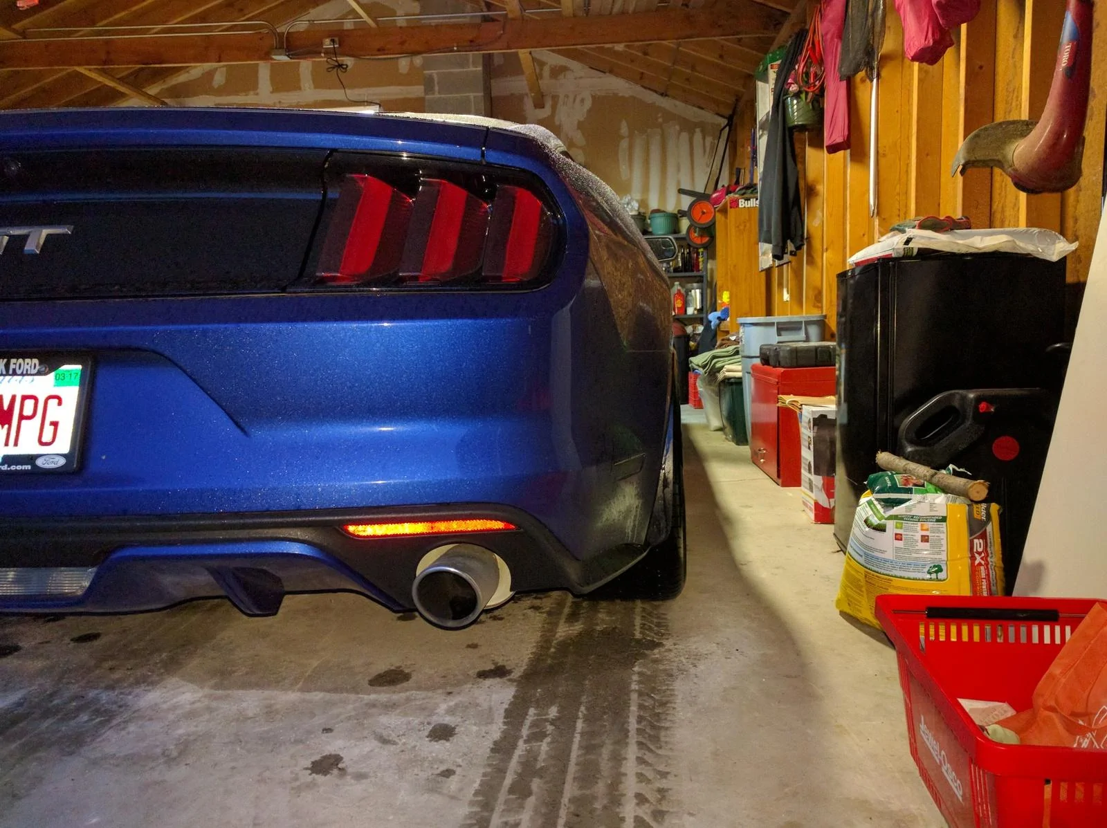

Hey man,
I put on the fronts and rears from ZL1Addons. They look good to me and the install was easy. Here I added some pictures. I have 1" spacers all around so these rock guards will be worth the investment since I daily drive this car even through winter (hopefully this is the last winter)! :cheers:

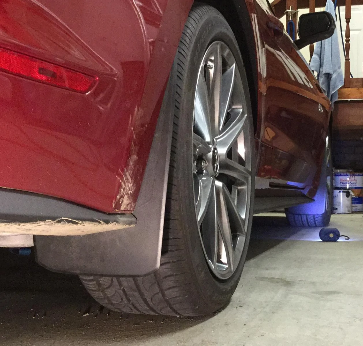

I installed my ZL1addon splash flaps Sunday. They went on pretty easily. I did install the blocks to the quarter panel per the instructions. I put blue painters tape on the outside of the quarter panel where it just bent over to the inside some. I measured straight from the factory push pin to the measurement. Where it lined up with the quarter panel I marked the tape. I put the push pin in the splash flap and the factory hole. With the splash flap in the correct position, I could see the holes in the splash flap lined up right above the marks on the tape. The instructions say put the bottom of the blocks at the marks from the measurements. So it looks like everything was lining up correctly.
I cleaned the inner fender sheet metal with rubbing alcohol per the instructions. Then stuck the locks on the quarter so they were just flush with the quarter. I then put the splash flap up to the car using the factory push pin to locate the flap. This is where I deviated from the instructions. And for very good reason. I used a 1/8 drill bit to drill the lowest hole. Then used the 5/32" drill bit to drill it out. I then used the screw to loosely secure the flap to the lowest block. Then did the same with the next two blocks. The 1/8" drill bit being smaller didn't need really any force to cut into the block. So the double sided tape and my hand were enough to hold the block for drilling without pushing the blocks off the quarter panel. The install was very easy and they look pretty good in my opinion. WAY better than the set I originally purchased from AM and threw away. lol
