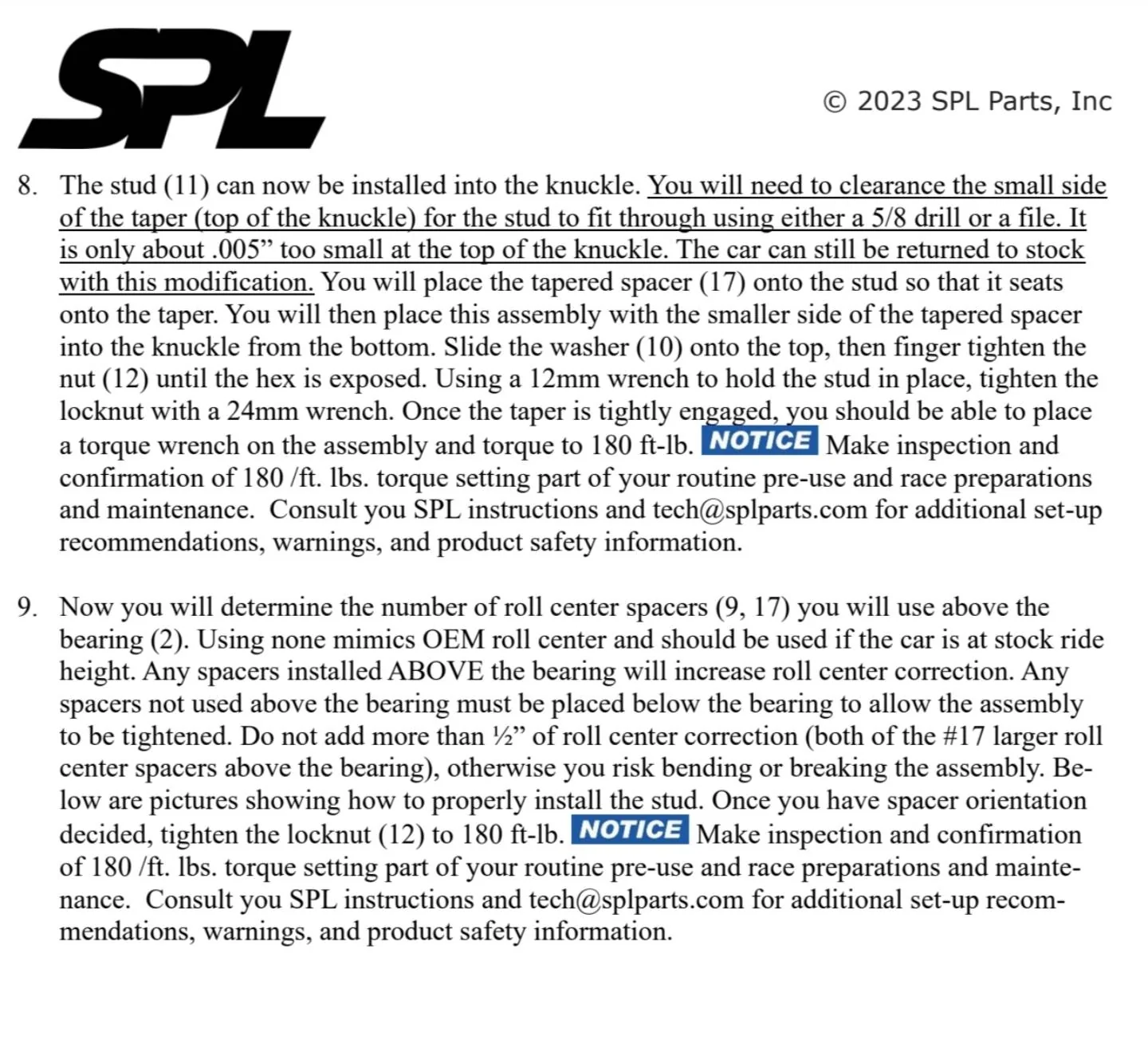

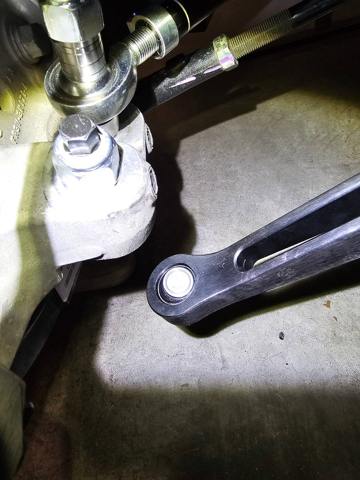

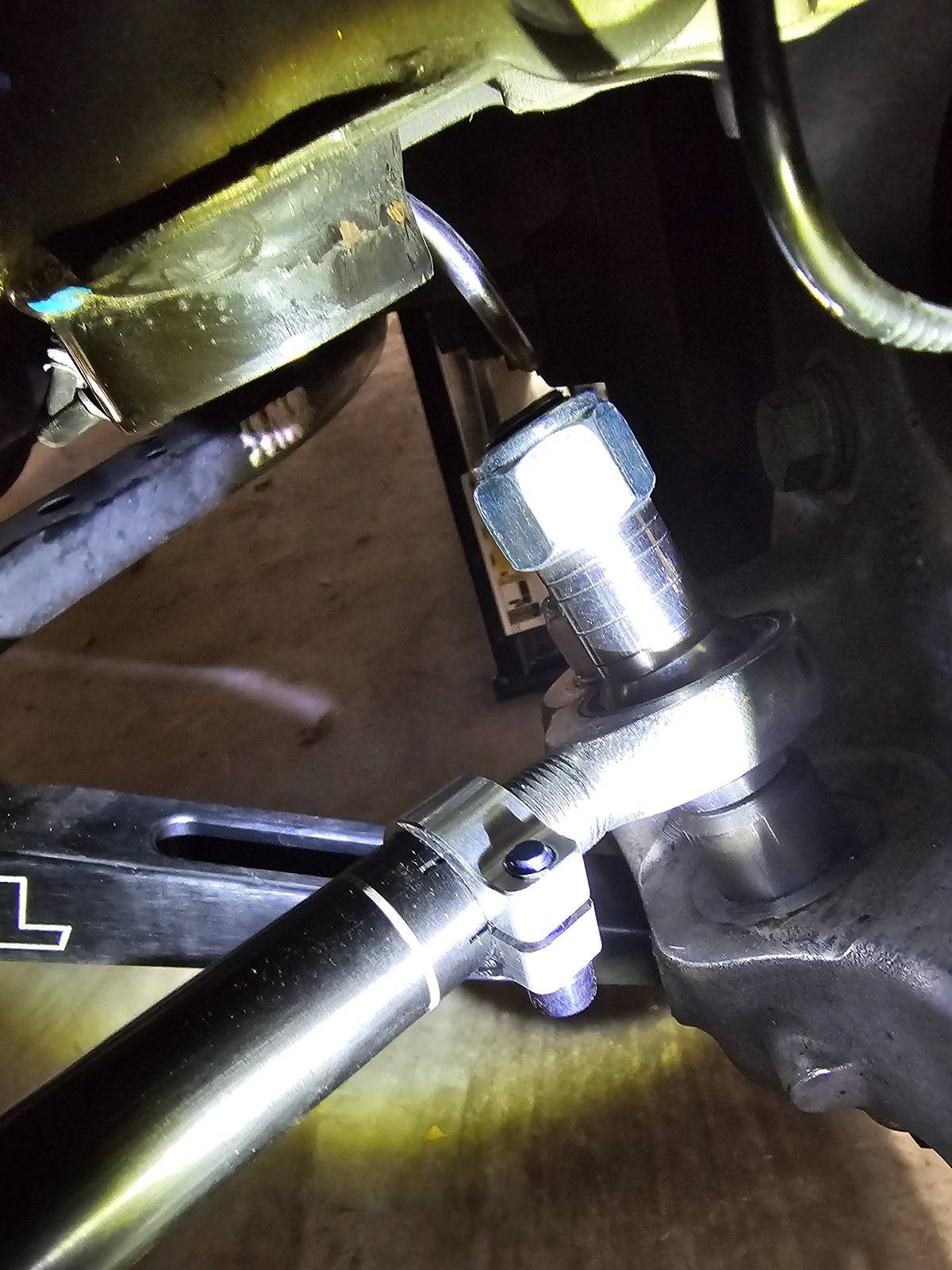

Any ideas how I can tighten this nut to 160 ft lbs? Too tight for any socket to fit better the nut and the bottom of the strut....

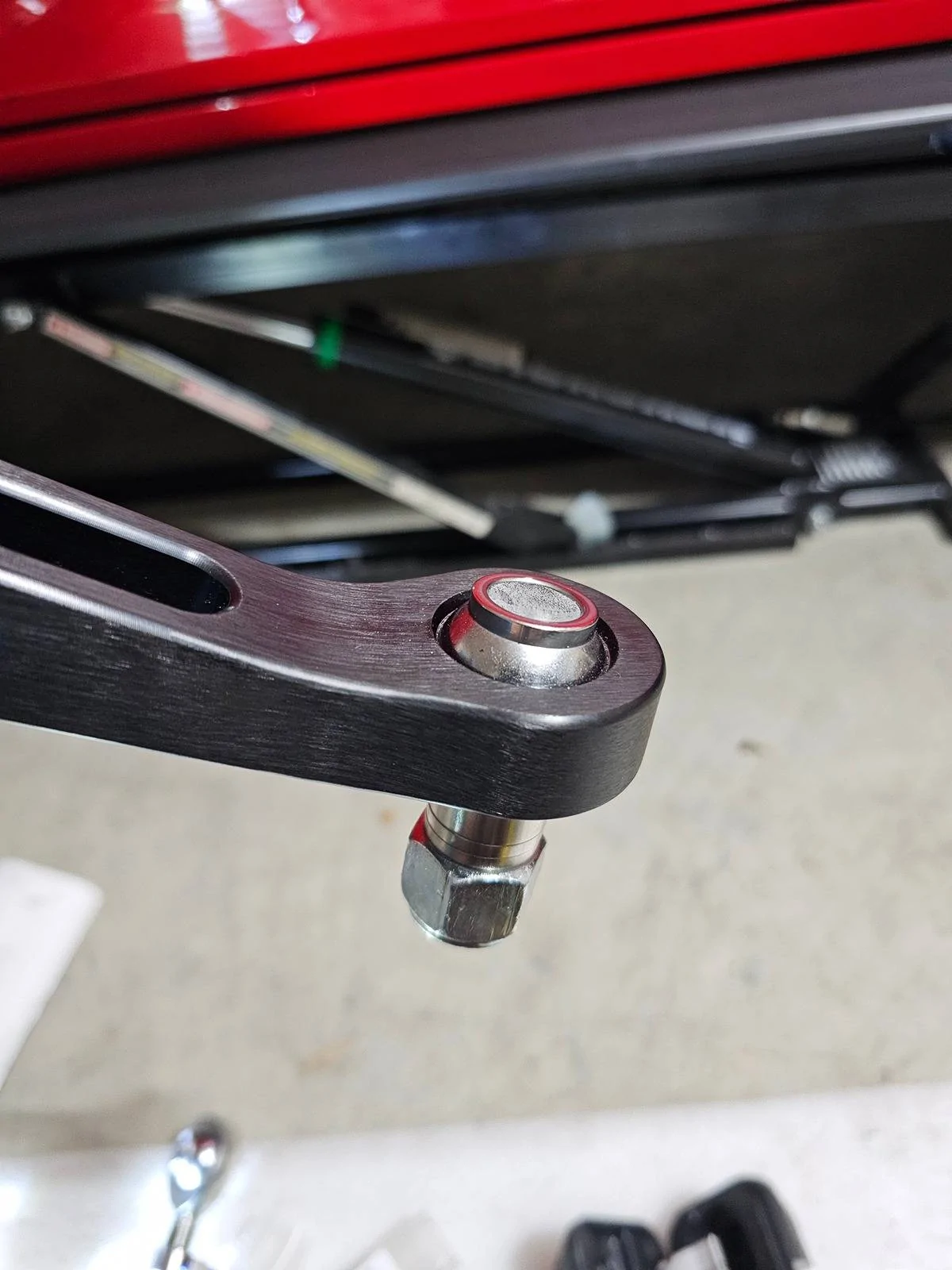

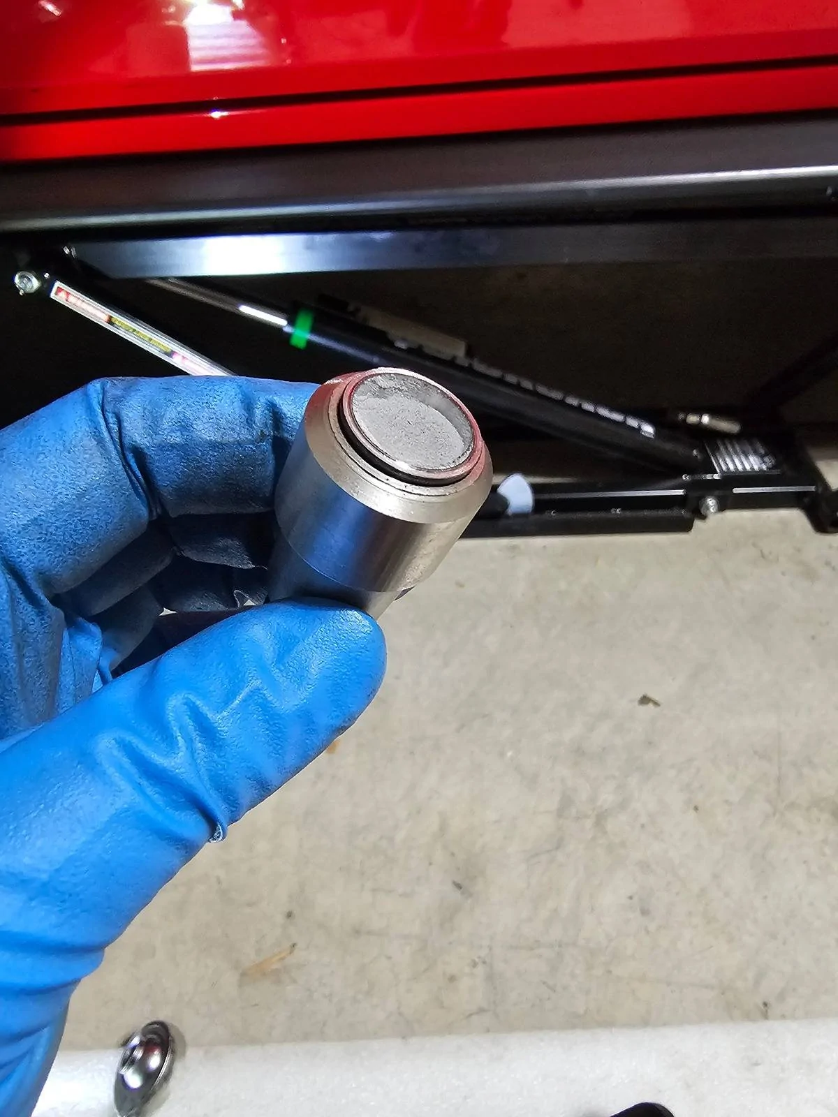

Welp......one of the studs just snapped.....180 ft lbs just like in the manual. Calibrated torque wrench....

Yep I know. SPL installation instructions state 160 ft lbs for the tension rod knuckle bolts and 180 ft lbs for the LCA knuckle bolts....

Either it's a faulty material (sure looks good based on the photos), or the torque spec is wrong. Either the wrench is bad or the 180 is meant for something else.
SPL makes a quality part (the parts you installed are on my wishlist), and their directions seem really clear, so I'm wondering if maybe your torque wrench is off?

I have no reason to believe the wrench is off. I have the calibration certificate and I've been using it without issue for the past year (wheel lugs, caliper nuts, and all manner of other jobs). Also none of the other studs from SPL failed at the same torque.
I'm going to contact SPL this week to see what they say.
This was a GIANT pain in the ass but the car is back to stock now.

Yeah, if that stud was faulty, I'd expect to see some corrosion where it sheared, or some sign of poor quality whatsoever. It looks to me like it was just overstressed.

Yeah I don't know. I'm not a metallurgist. I don't know how or why it would be overstressed. I just went down and conducted a quick experiment. I tightened my wheel lugs with a different torque wrench and then tested the one I used last night and it clicked at the same torque value.
