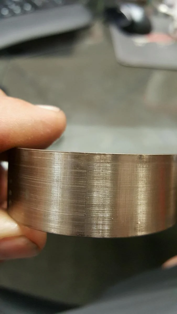

Could you please explain?
Thanks!
I thought you may have been asking is this the car that the twins are going on. Yes it is, twins are not on it yet. We are in the process of tearing down the motor to be sent out. In the tear down process, this was discovered. The build can be referenced ------
http://www.mustang6g.com/forums/showthread.php?t=63174
To reiterate, this was either done by "design" (I certainly hope not and could not imagine why), was poor assembly at Ford which caused them to spin within 7 miles or the car lost oil pressure in the 7 miles it has on it.
firestarter2
Jun 16, 2016
69
3,207
1,163
NYC
RR G350 Track
That pattern looks too even to be done by being spun. Mine when spun looked almost burnt
