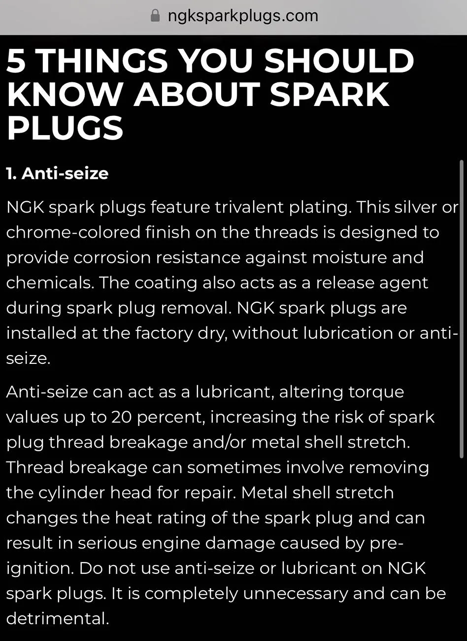

You don't need antisieze. It will artificially increase the amount of torque you apply, and the NGK plugs already have a finish in them that doesn't need it (says so on their website)

LOL. So now we're smarter than NGK engineers ?
