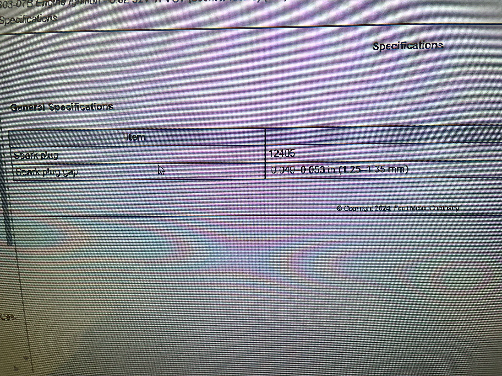

What spark plug gap should I be doing? Also, any other tips for my first time replacing the spark plugs and coil packs?

This is from the service manual. I gapped mine to .051.
The pax side rear cyl will be the toughest one to deal with, but overall, it’s an easy process.

Do stock or a little tighter unless you are running into misfire issues. Had some random misfire issues and tightened gap to like .025 and it fixed it but this was with a higher compression motor on e85

It is interesting that the GT500 and Roush are just a touch under that .040” gap.
Boosted engines are typically gapped smaller than NA engines. All things being normal (pump gas, NA, etc.), best to stick with the factory settings.

Meant to include, torque to 127 in lbs, use a dab of anti-sieze.

Have never had to gap a plug that tight without 15lbs of boost being involved
Ya not common and not sure why and if it was really the gap that was causing the misfire issue. Lund was the one that recommended it to me after I was having some random misfire codes at high rpm. Gapped it tight and they went away and motor was running strong.

I can see that with a conventional dizzy.. there's simply not enough time ( IMO ) to fire off any wider gaps. Even my old GM HEI I gapped them done to .035, much better than the .045-.050 called for.
But coil-on-plug is manmade lightning, so for NA the factory .050 is more than good.
