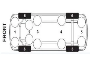

There are slots in the frame on both sides of the car near the front wheel line that are used for towing.
When my PP1 started screaming with a stuck pulley noise on day two of ownership, I called Ford Assist and they sent out flat bed with a driver who understood the front spoiler issue. He babied it up the ramp with a pair of hooks in the slots and used the slots and the tires (not the suspension) to tie it down on the bed. I don't expect to get that lucky with drivers in the future.
You winch using the points labelled as "2". You tie down with "3" and "4".
Great thanks.so the slots are in the frame in front of the tires.i have AAA BUT will use fird assist next time.did you contact them thru Ford pass app.thanks

I edited my post after you replied. See above for the slot locations.
The full page for the wrecker guide (with the footnote for the GT350) is below.
