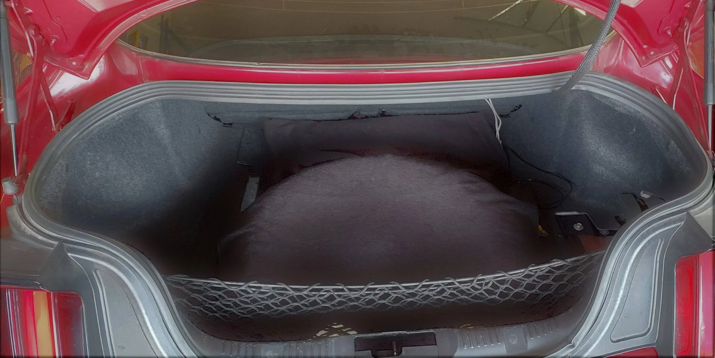

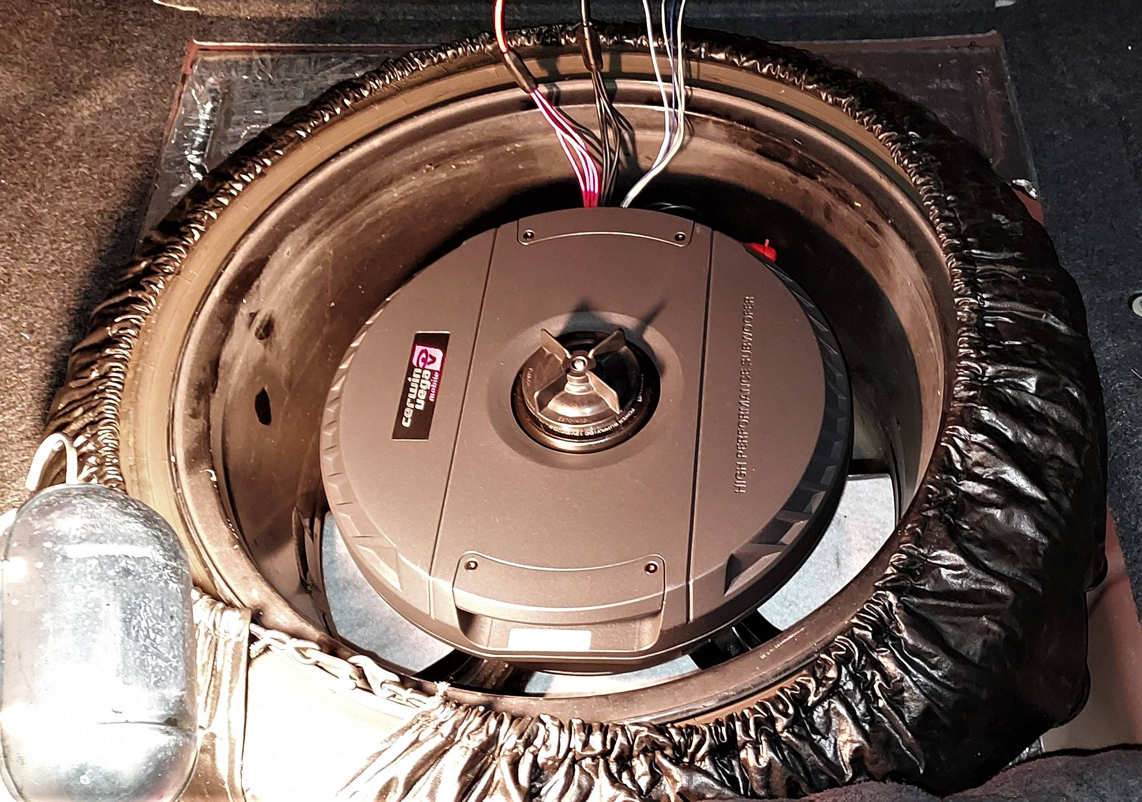

Good news everyone...using the rear speaker leads made a huge difference, so don't use the sub leads. Only problem is, for now, I don't have rear speakers as the wires were so tight I could not tap in gracefully. I'm getting too old for all these contortions, lol
I'll get real world results tomorrow when I drive around all day.
Here's an idea of how it looks and fits...

Where did you get the shower cap for the spare????

Great news everyone...this sub kicks the shaker to the floor. I should have done it sooner is my only regret. The stock woofer only uses 14 ga power wire, so there is your first clue.
I have to tame the beast with the controller for some bass heavy songs by dialing back the gain and/or bass boost. I have the crossover around 75-80 Hz and phase doesn't do much.
So Mike, I can definitely recommend this unit. Just be prepared for some post contortion pain. Note that the screw down threads are 6mm, so the included parts don't work. You will need to fab that to length depending on your spare or no spare.
