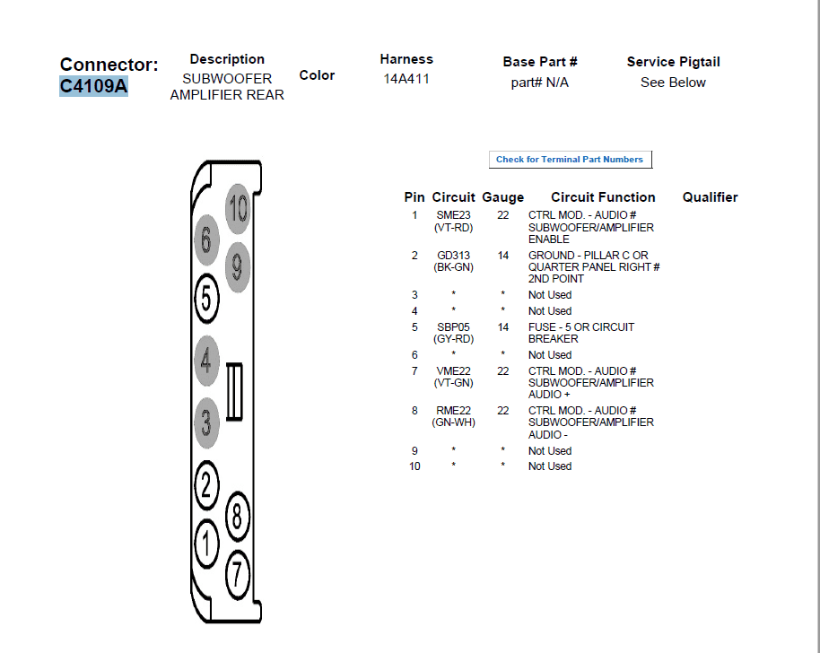

Okay, I spent hours searching, googling, etc. and here is what I came up with.
For the power it's best to run directly from the battery with a fuse, and ground near the trunk.
But I would still like to use the shaker sub connector for signal and turn on if possible.
So which wires on the connector would I use?

This is for a 2016 GT Premium package with Shaker system including subwoofer.

Thank you Cathul!
If I'm reading it correctly;
Pin 1 is the turn on signal
Pin 2 is ground
Pin 5 is power (not sure how many amps)
Pin 7 is speaker +
Pin 8 is speaker -
I wonder if pins 7 and 8 are already crossed over as a low pass?

As far as i know they are.
Crossovers and EQ is done in the DSP module (which is contained in the amplifier in the drivers kickpanel).

I just read that the SW I listed above does not need the remote turn on feed if you use the high level input, which appears to be crossed over at the connector.

Also, if pin 5 goes to fuse 5, that is a 50A relay. But since it is only 14 ga wire, the sub will need a dedicated power wire from the battery.
I think I have a game plan now and the sub has been ordered.
