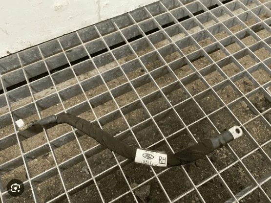

I found a photo of a 2018 EcoBoost grounding cable. (I still haven't found where it is in the engine bay.)

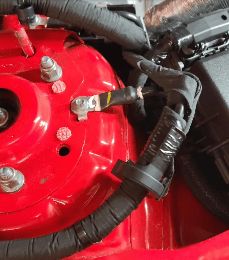

Edit: This might be the connection, on this strut tower:

Yes, that's the shock tower I was referring to earlier (front passenger side), and definitely the ground cable on the Ecoboost I was thinking of. It's often also used as a mounting point for some of the Ecoboost catch can options, where if not installed with care, can become a problem. I also agree with you about a ground issue being less likely in this scenario, since the problem seems very isolated and specific and there seem to be no other issues, but you never know.

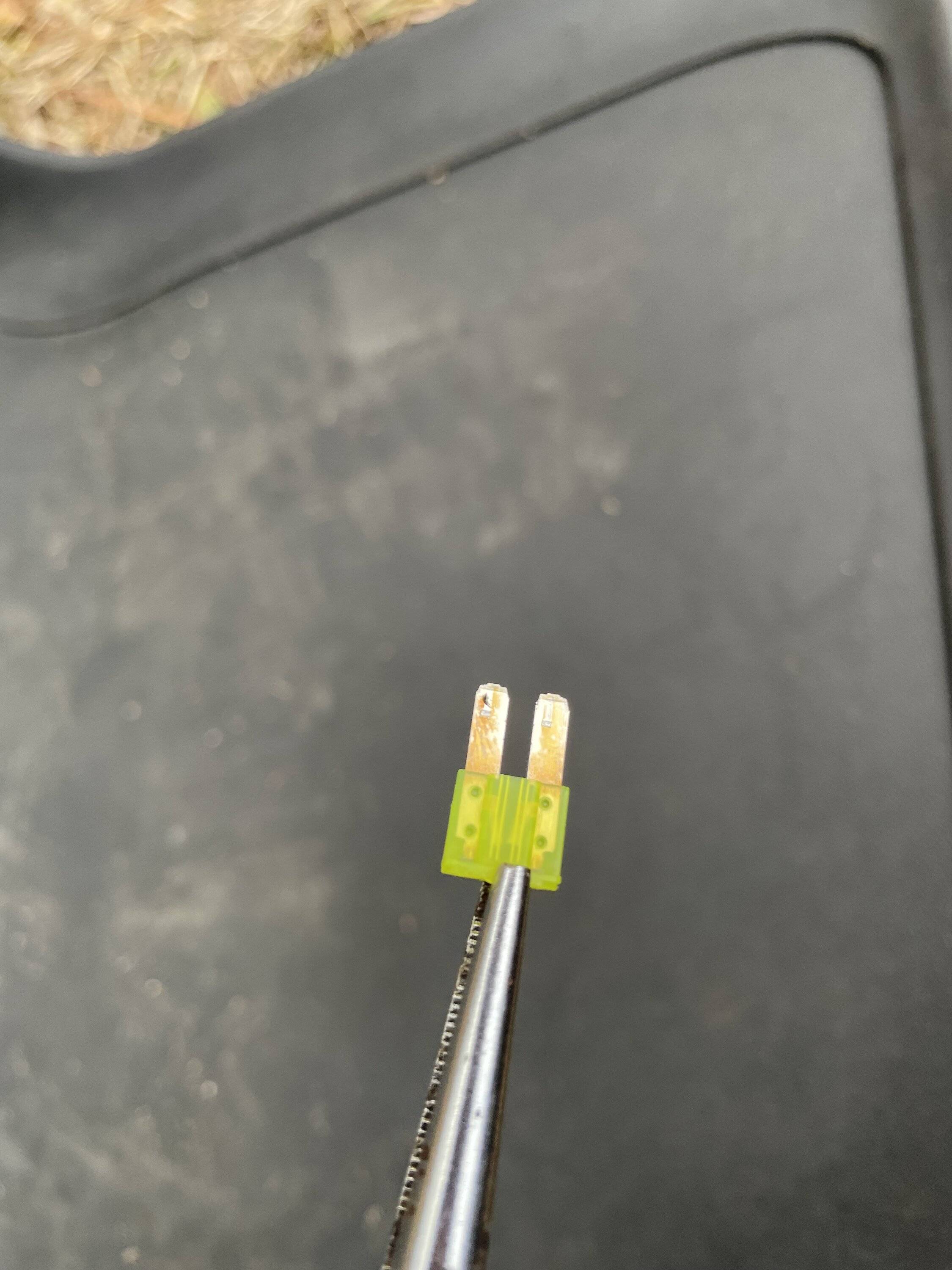

Ok guys I’m finally checking the fuses. Not sure what I’m looking for on them. I pulled this one out.. is it blown or is it ok?
Looks ok. The little "S" in the middle would have a break in it if it were blown, and generally a bit of discoloration

Ok I see what you’re talking about. Let me check some other ones and see if the S is separated.

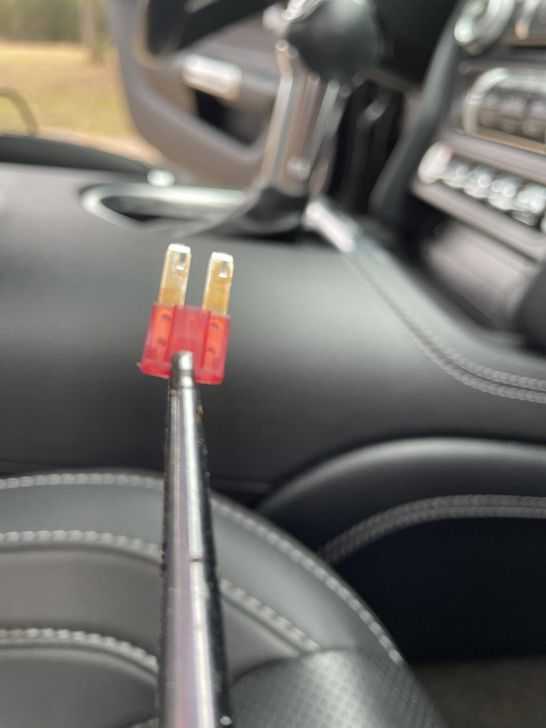

What about this one? Doesn’t look like it’s connected at the bottom of the U.
That looks blown, you can confirm with a Multimeter. Instead of pulling them one by one you can use a Multimeter as well much easier for future. You just place the probes at the back end and look for a beep to confirm connection.

If you don't have extra, you can remove one from another area "has to be same size" and test it to see if that fixes your problem.
Yea I need to get me one of those because it’s hell laying down and trying to pull these with my left hand. Lol! So do I just go to an auto parts store and buy a 20 fuse or does it have to be a specific 20 fuse?
There is different types of fuses. Just take it with you and match the correct one.
