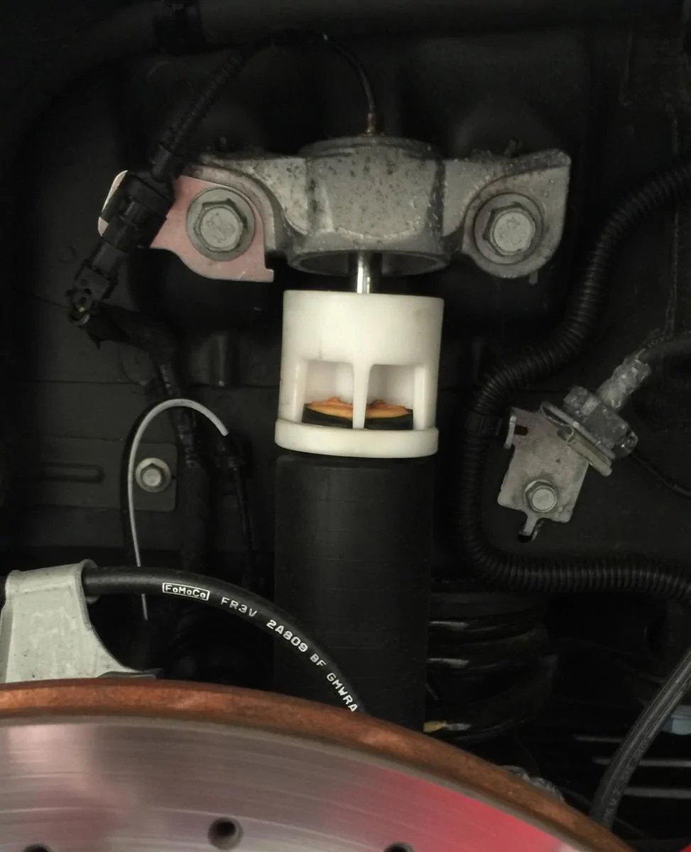

So is a recalibration required or not.
How do the rear shocks come off. Two piece snap together or what?
With the rear hock getting hammered in a way it was not designed, I wonder if there will be a premature structural failure?
So if a re cal is required, is any dealer of my choice responsible to do it. I'm not about to take this thing back to pheonix and back to central coast CA for that
It would be best to remove the spacers, lift the car, allow the wheels to fully suspend in air and then recalibrate.
The shock will be fine... You do not have to remove the shock.

How does it release??
Just reach in and pull them out... They're only secured by compression. If you jack up each rear quarter, or put the car on a lift that allows the wheels to suspend, remove the wheels and reach in and pull the spacers out. It's just That simple...

Sorry, on the lift, wheels off the road, no load on suspension
I think their is a lot of confusion on the calibration of the system as well. The TSB article says to perform the calibration with the wheels off the ground. The actual calibration software says for the vehicle to be on level ground. I was watching as my dealer was about to calibrate and brought that discrepancy to their attention (wish I had taken pic of the software warning). They called Ford Performance and FP said to perform the calibration ON THE GROUND with nothing in the vehicle. So, my car was calibrated sitting on all four wheels.... :shrug:

Has anyone contacted [MENTION=7992]FordService[/MENTION] about these multiple cases? Still feel that running the rear transport block in has to cause some damage. The upper shock mounts fail on regular Mustangs if you bounce it off a curb during a track day, it can't be good using the top of the shock and the shock mount as a hard bump stop. The intention is to jack the car up to clear for transport. Driving around on the street hitting bumps with no travel has to be detrimental to the shock.
