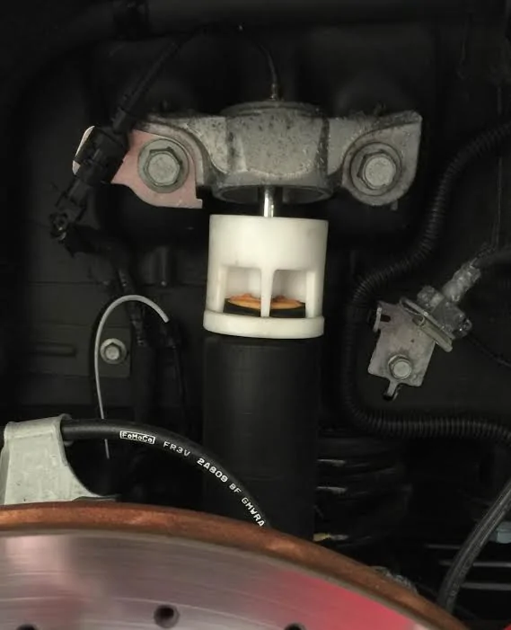

I had never really got down on my R until today. Glad I didn't since the spacers were still in. Now, it's night and day. Stupid crazy how two little bushings make such a difference... Even more stupid how a neglected PDI can make a real street-race car ride like a turd with all the porpoising.

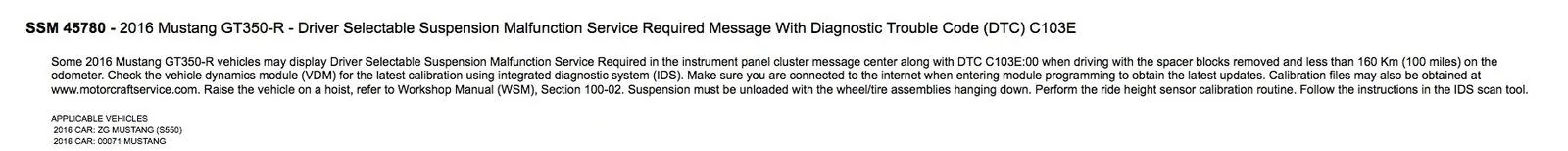

So can someone help me understand this? Do all R's need to do this or get the SSM done? Or is this a case by case deal?
No its case by case; only if your car has the Error message and the DTC. If you think the ride in your car is off, you might be able to get them to do the same procedure.

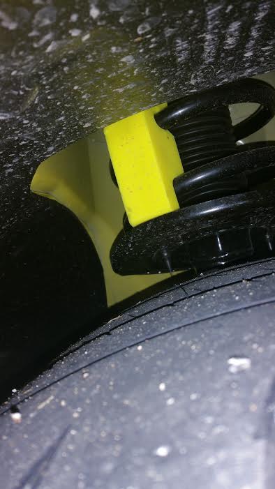

any one have a pic of what the front spacers look like installed I haven't rely drove my car much (weather has been to bad) but I looked and the rear spacers are still there. don't see anything on the front didn't know if you can see then with the wheel on.
You can clearly see them if they are on. Kneel down and look under the fender straight about the tire. They are bright yellow. Can't miss them if there still on.

they were on the springs I guess

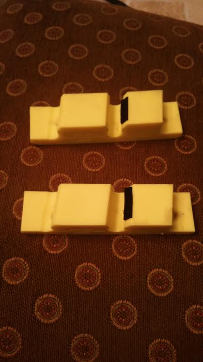

Here you go...

thanks guess you couldn't miss them!

There were several of these, I just posted them in the Roadcourse forum so I guess no one else looked at them. I think I have more on my laptop. There is a bulletin from Ford directly related to the PDI and removing the transport spacers (so they don't scrape)
http://www.mustang6g.com/forums/showthread.php?t=52508

Here is what the rear spacers look like installed in the back for the R's, photo courtesy of "DrumReaper" rear wheels need to be drooping, or wheel removed for easy access. P.S. Mine are still in there...:frusty:
