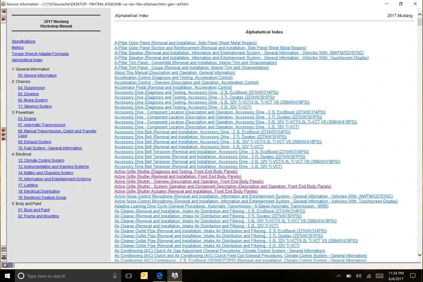

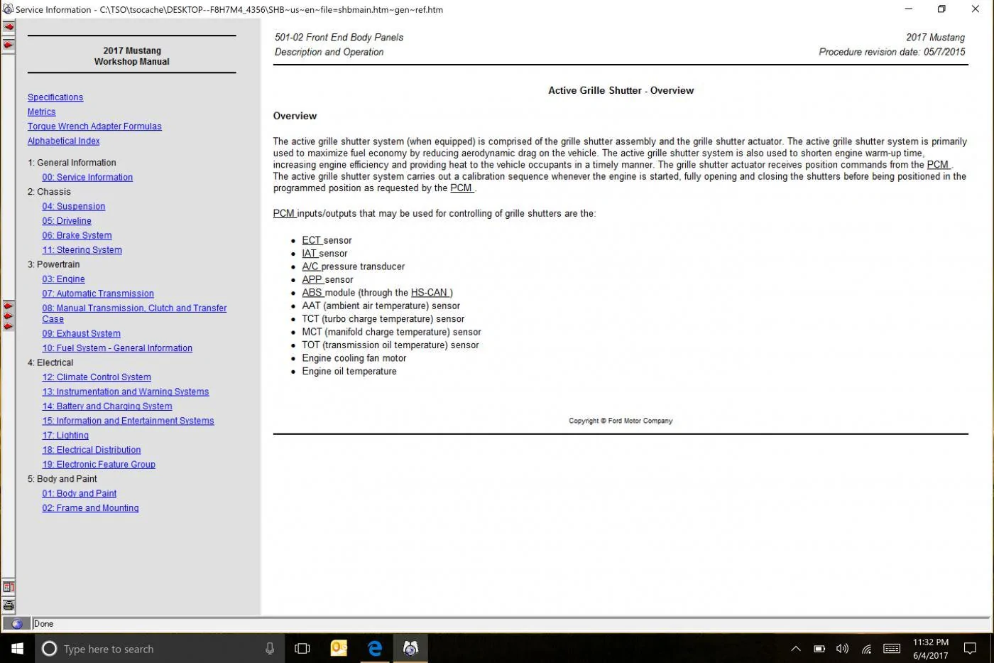

what do the shutters do for the car? Air flow? Manual says PCM monitors 6 items to determine shutter setting

I have the manual too. What section are you seeing this in?

GT350s don't have shutters. Some regular Mustangs do for aerodynamics mainly related to fuel economy.

helm
shutter

That manual is for all 2017 Mustangs. Key words are "when equipped." As said above, GT350s aren't equipped.

Yup. You are looking generically as that doesn't apply to the GT350/GT350R model. My guess is the Ecoboost 4cyl uses it (?).

Yup, only applies to ecoboost cars.
