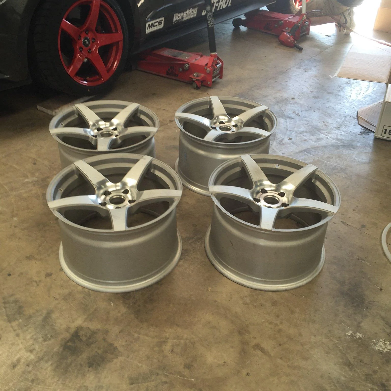

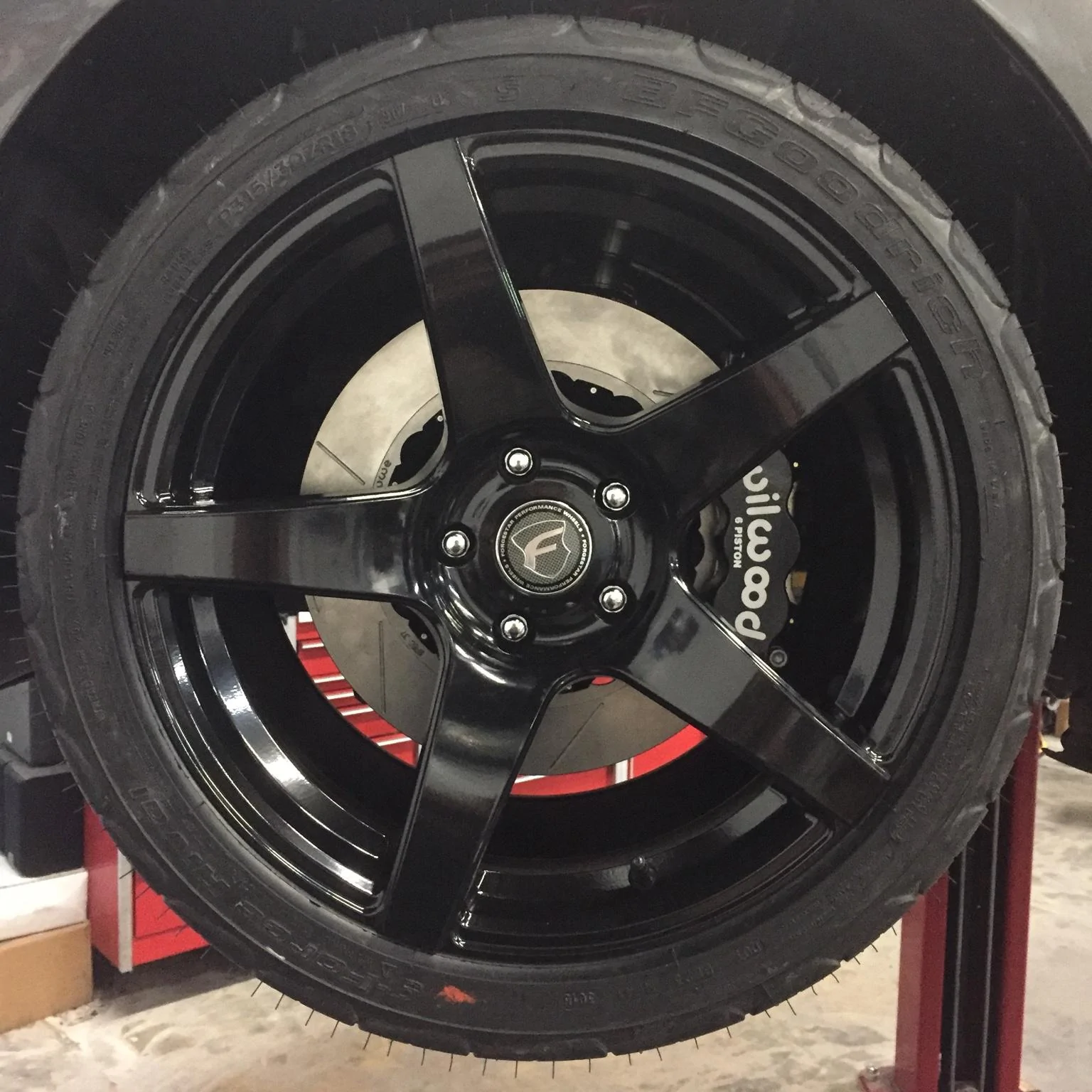

Nice tires!The SEMA 2015 Mustang build for HP Tuners is getting a major tire upgrade! Stock vs. 315 Rival S's on Forgestar 18x11s!
Nice tires!

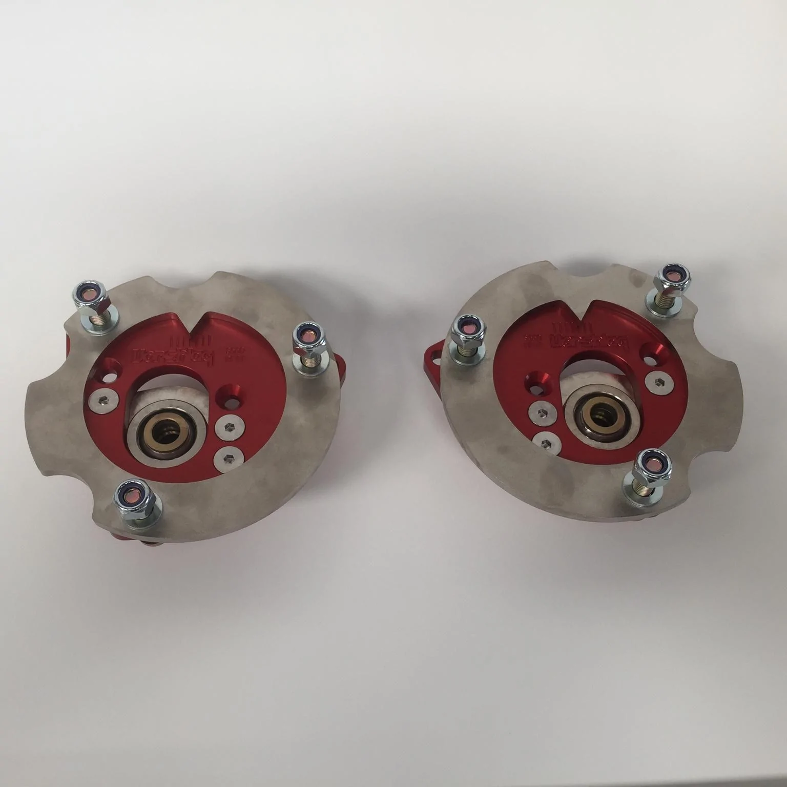

I believe it was asked earlier in the thread but never answered regarding the camber prior to installing the plates. What alignment specs did you use on the car baseline, how much camber could you get without plates? I'd like to maximize my setup as much as possible without messing with plates since I only do 2-3 driving events per year.

What about for the rear camber?Camber is not adjustable in the front without camber bolt or plates. Stock suspension lowered on sportlines normally gets 1-1.5* negative camber.
