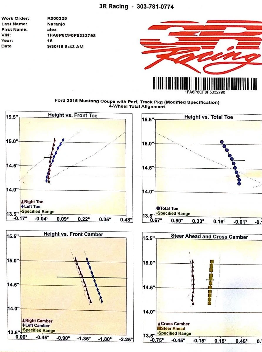

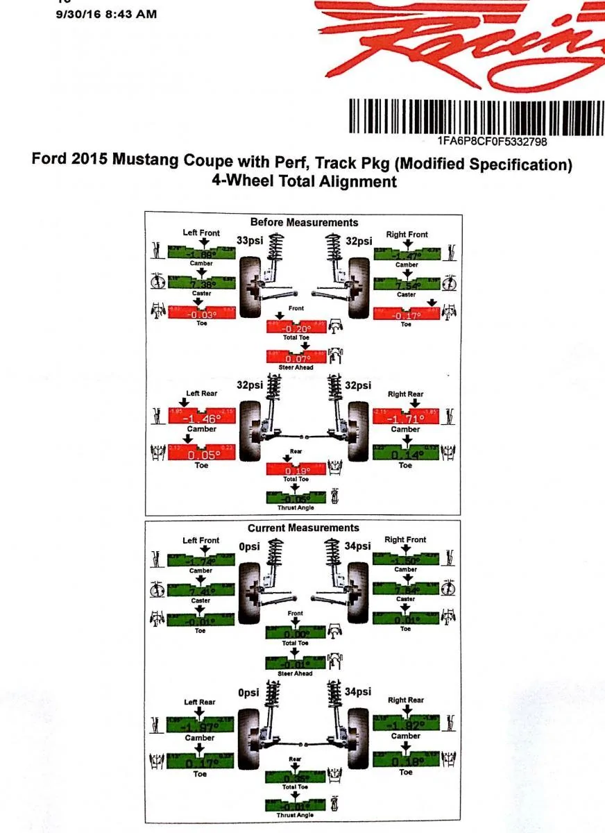

My car just got back from 3R automotive for a bump steer check and alignment. I'm running 0 front toe, 1/8 total in the rear, 1.7 camber up for t and 2 in the back on koni yellows at 1.5 from soft and steeda linear springs. BMR sways set to soft in rear and front. Car is transformed! It's so stable at speed and around corners. Its tight, precise and sharp. I cannot believe the difference.
