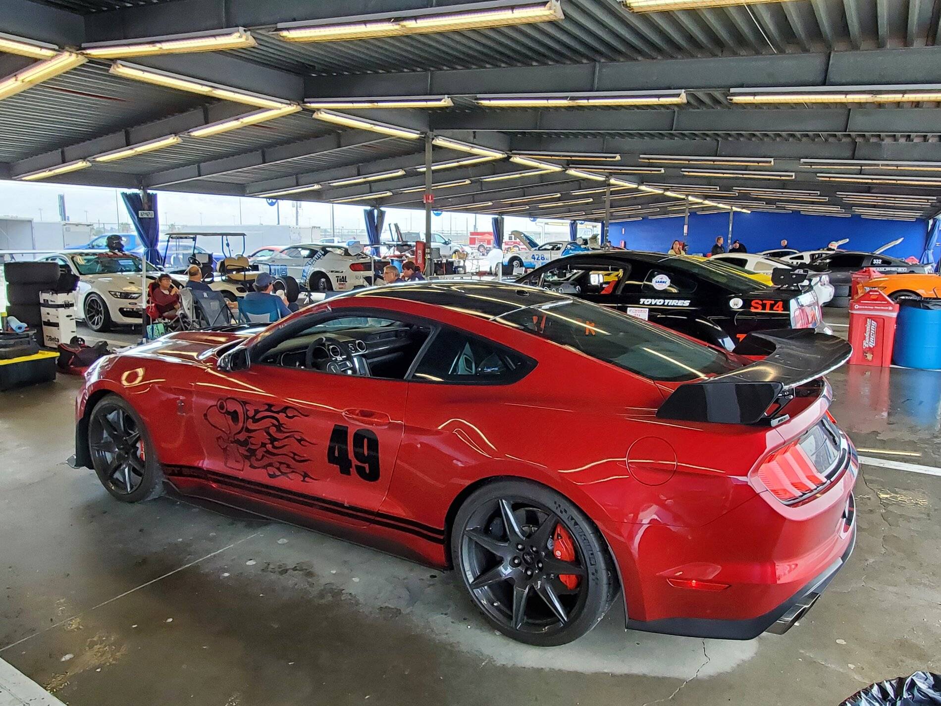

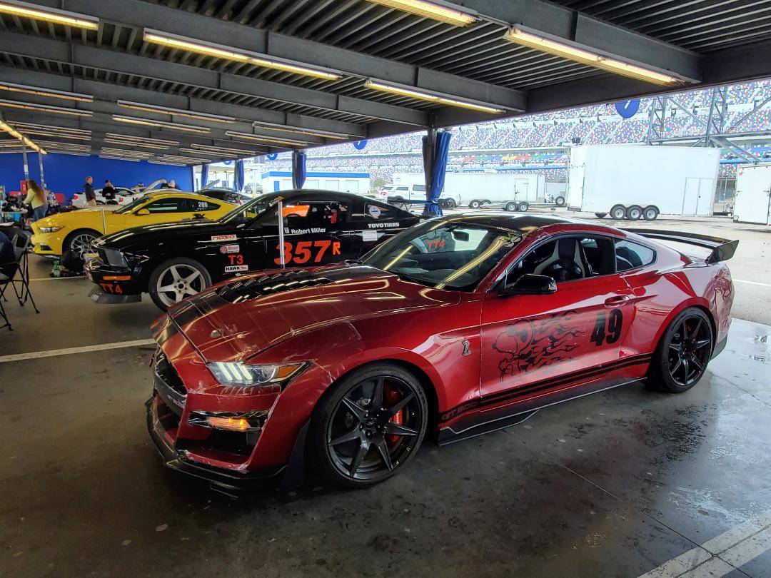

Here she is before the flat bed came to get her.
Edited to add:
I was unable to get a hold of the insurance company to switch my policy over to another car. The weekend is kaput.

Damn sorry all the way around, Tom. But, she'll get fixed post haste and you'll be back soon enough.
The solution is not as easy as it seems. I'm working the problem.
