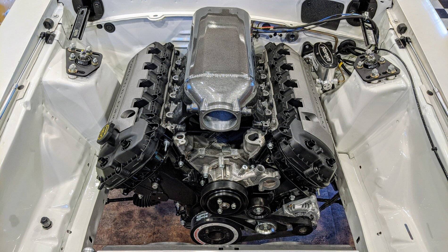

Dang, what shoehorn did you use to get that to fit? Post more pics when you get a chance, or when it's done. Cool project.

I think my '67 with an FE had more shock tower clearance than the new generation "small" blocks. 4valves are wide.

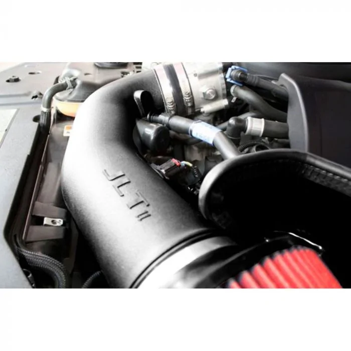

Like this but no barbs...

I can modify one, but would rather run one with those items deleted if that exists. If not ill just build one out of alum. I like the JLT type inlets that are out there because the maf section is large and tapers down smoothly towards the throttle body. That is hard to achieve when building out of aluminum.
