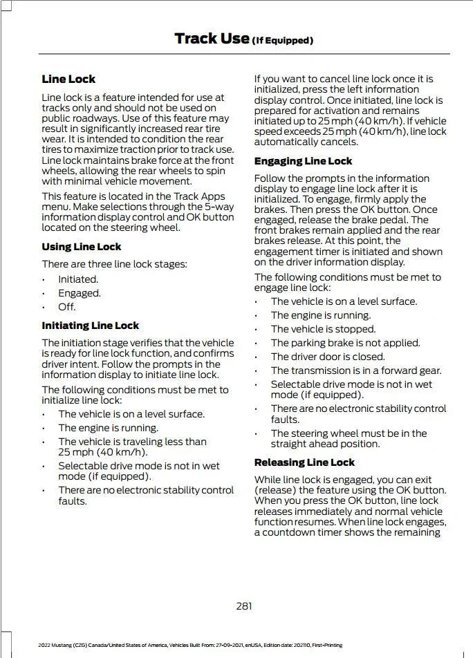

Line loc is the preferred way, but the key there is, you have to dump the clutch to do it right. Failure to do so can result in riding/smoking the clutch as well. It’s a very quick action. It also saves your rear brakes, although some people prefer to just do a quick clutch dump and jump on the brake pedal. This works too, but IMO, it burns up rear brake pads and puts unnecessary heat into the rotors. See video for example of proper use of line loc.
