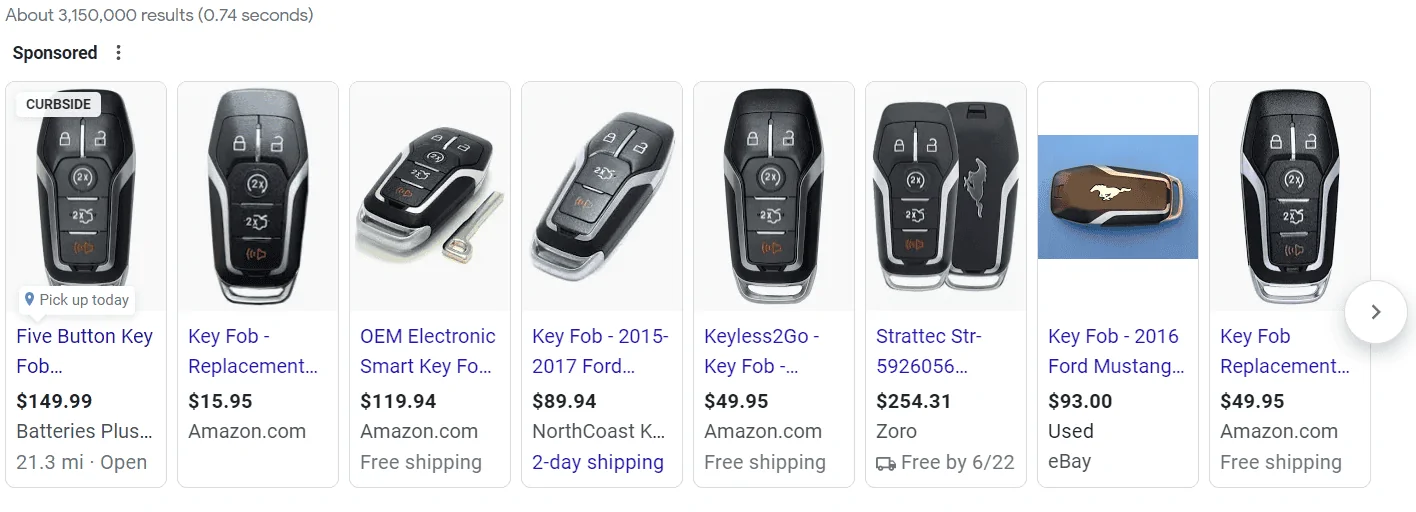

Yeah but these are from America I’m UK based so it’ll take weeks to arrive on top of that mine has 3 button whereas these are 5 so I’m not sure if that’d work either

If the fob is physically identical (sixe, shape, number and positioning of the buttons, etc) then you need to check the back of the new fob for the FCC ID number and the part number. I know that the FCC ID has to match but I'm not sure if the part number absolutely has to.

I programmed a key from an Edge / Explorer / Fusion for my third key. Ford logo on the back, not Mustang. Always have a third key with Fords, super easy to program yourself when you have two others.

Just for future reference: These don't work on european cars out of the box. In the US you're using a different frequency for the remote functions. In order to make these work you also need to change the control module and the TPMS sensors. And I'm pretty sure you also need to adjust some values with Forscan. The upside of all of this: Afterwards you can use remote start with one of these keys (instead only with the App).
