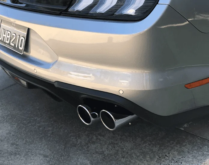

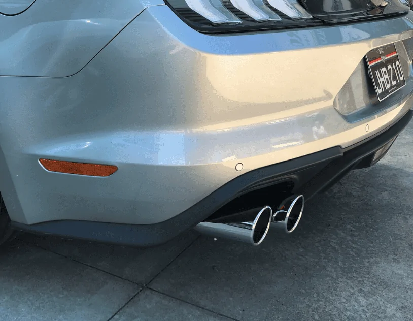

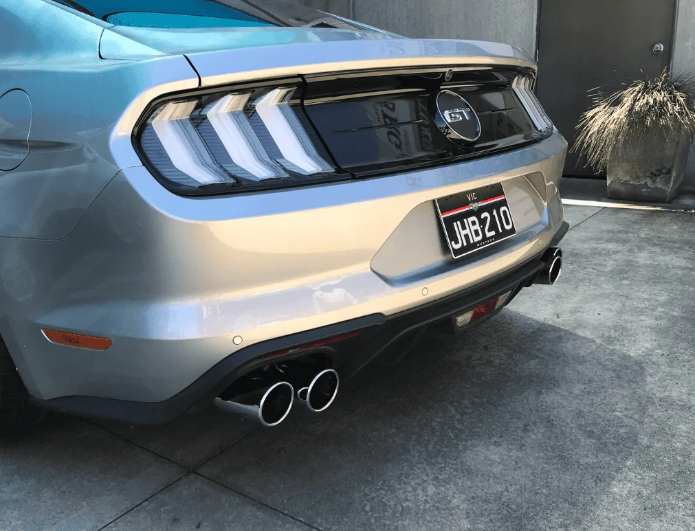

This would be perfect and is the only true slip on that I’ve been able to find, but it’s only available in chrome and the company is based out of Australia:
https://www.burgdesign.com.au/exhaust-tips/ford-mustang-gt-exhaust-pipe-set
Heres a video of the above sleeves that I stumbled across:
I did find this on Amazon but the outlet is 4”. My tips are 3.5” with 1/2” space between, so I’m thinking these will rub together. I’m tempted to just buy them to try it though.
https://a.co/d/f9fkbq3
What do you guys think? Do we as active exhaust owners have any other easy, slip on options for changing out exhaust tips?

I feel your pain, but I also don't like how a lot of the slip on tips look ... :frown:
They just don't seem to fit the valence well or flow with the angles i.e. they look 'bolt on' rather than OE (pictures from your link) :

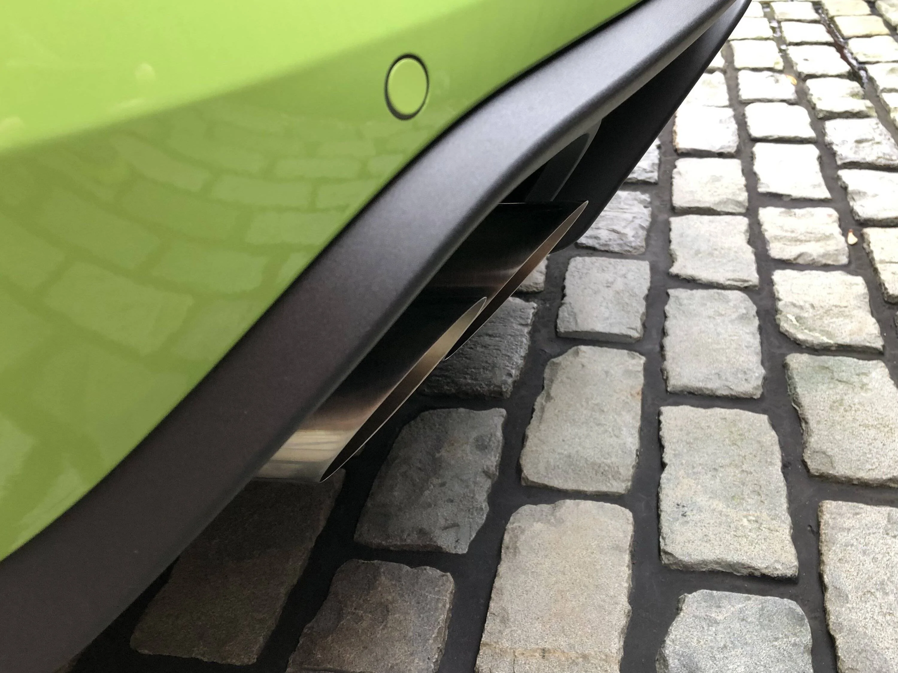

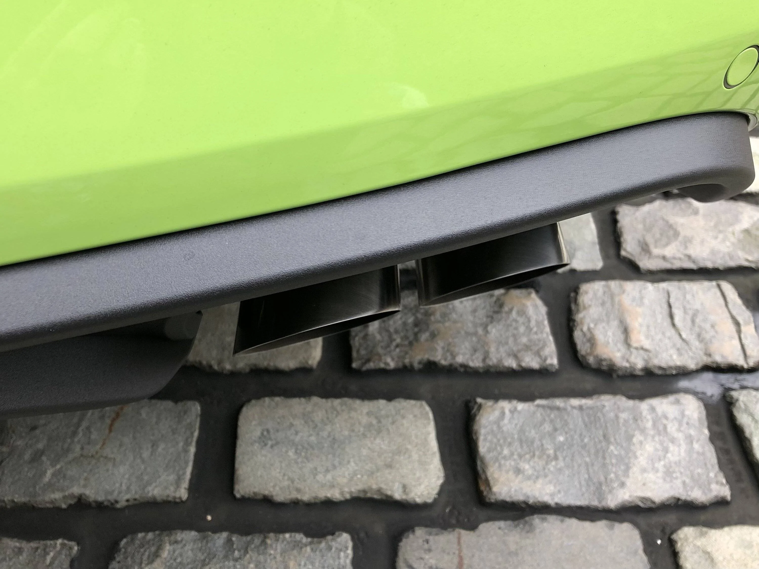

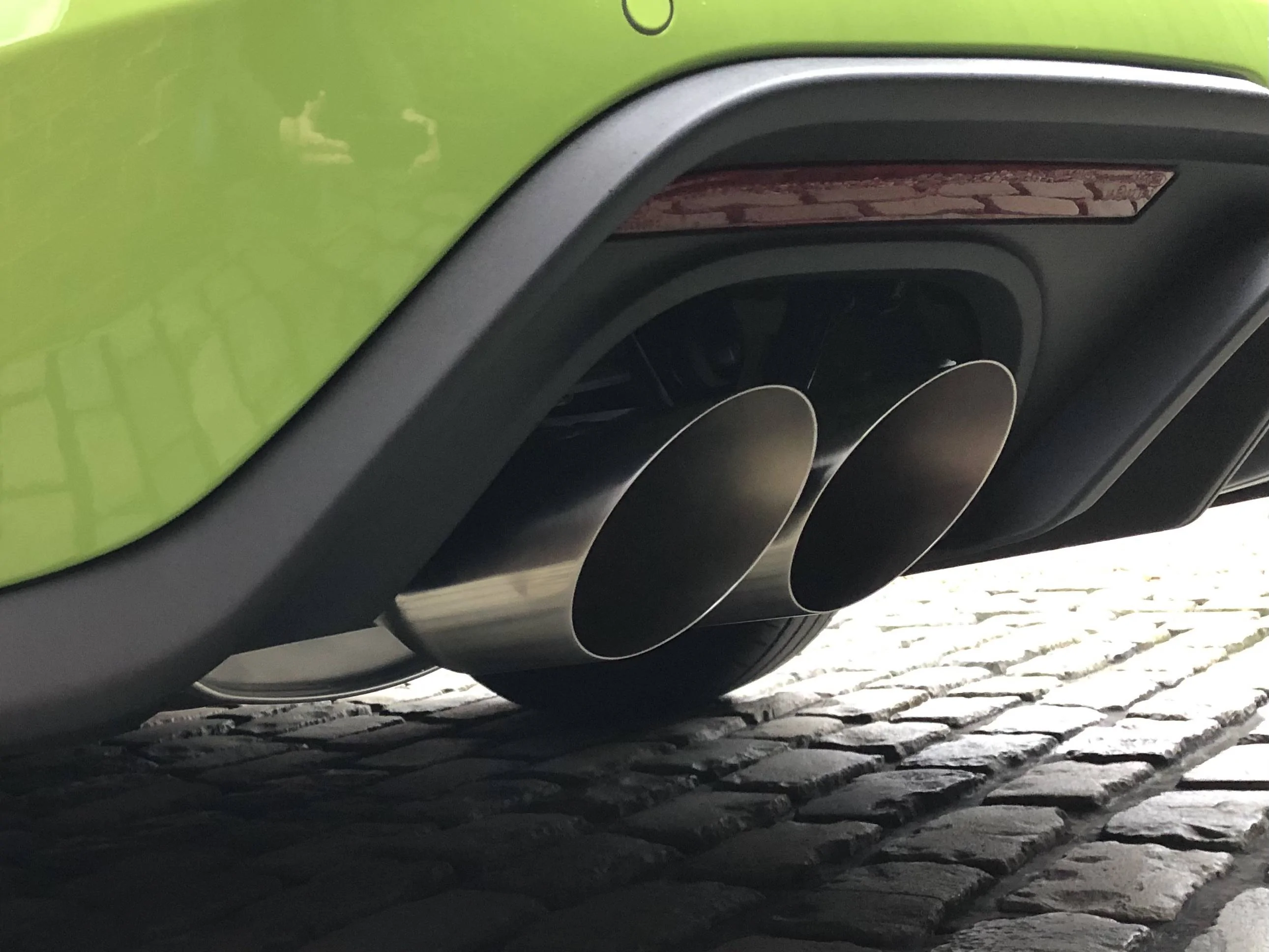

How Ford intended them to fit (be it mine are a little shorter as I gave the active exhaust loom a little more clearance) :

I agree. The slip-on versions look "off".
They look jammed together because there is not enough space between the pipes to do it right.
They don't match the contour of the rear valence so they look staggered, one sticking out farther than the other. You can see the slanted OEM tip inside the end of the slip-on due to the angled cut of the OEM tips. Being able to see the clamps is also a no.

Tailpipe fit is in my option is perfect, the cut angles fit with the flow of the rear valance perfectly :
i.e. I don’t think shortening the cut point and h pipe compromised the rear fit - and maybe even improved it … :like:
Although the standard pipes have some aesthetic weaknesses, the fit and how they flow with the valance is in my opinion very good and better than a lot of the aftermarket offerings, they just need to look a little 'cooler' - I've not totally given up on some form of tail trim just yet ...
