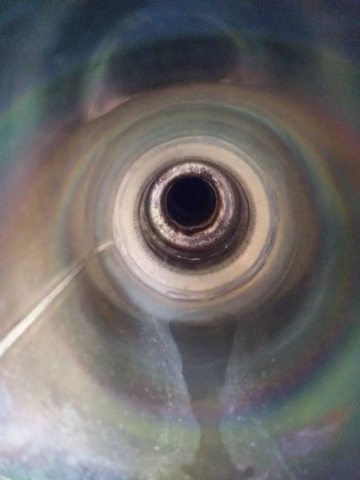

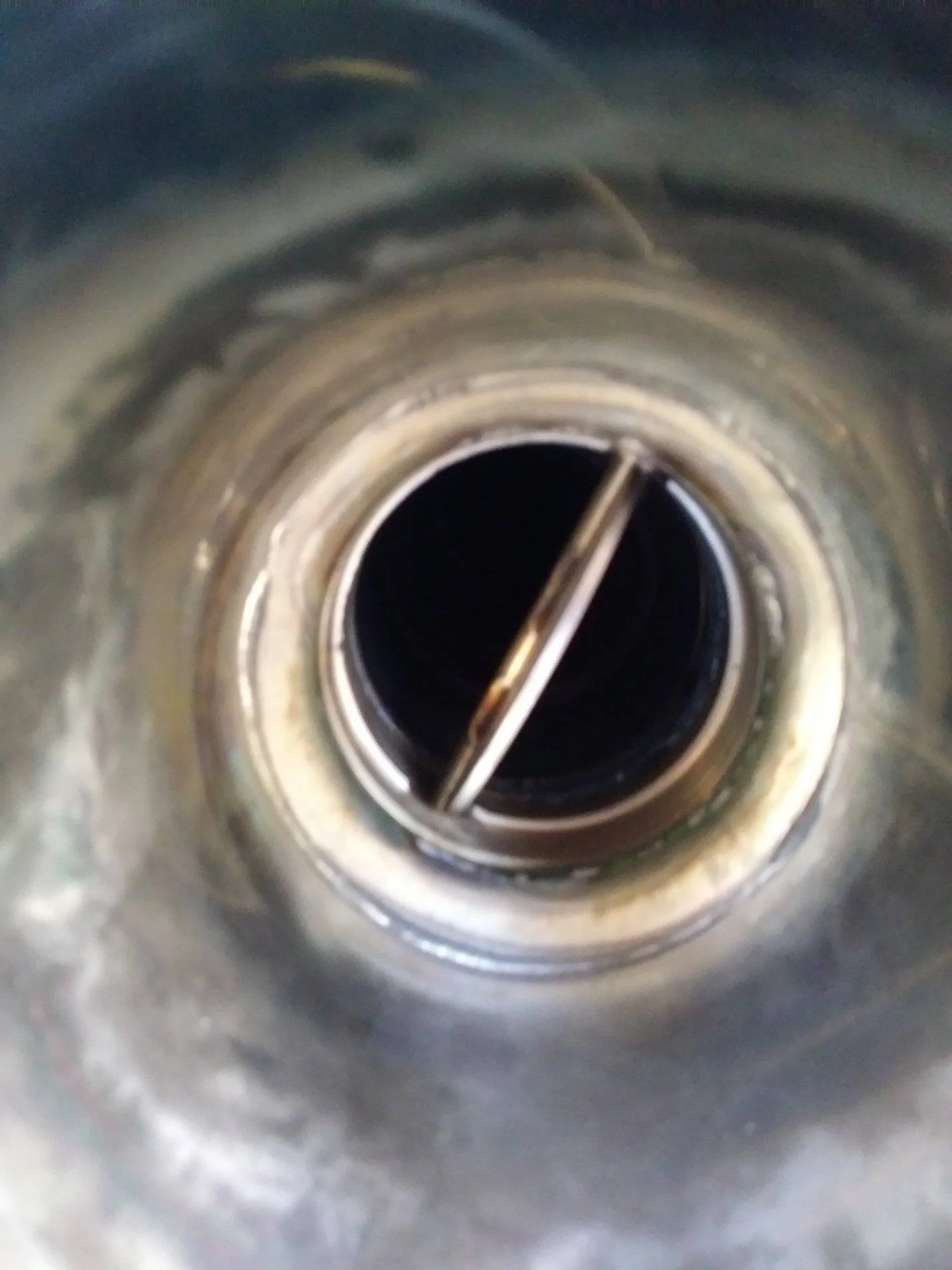

The corsa valves are definitely bigger than 2.5 inch. They are very close to the inside diameter of the pipe. Sorry for the crappy pics. I'm pretty sure the Borla is the same. I'll get some pics later tonight when i head down to the garage

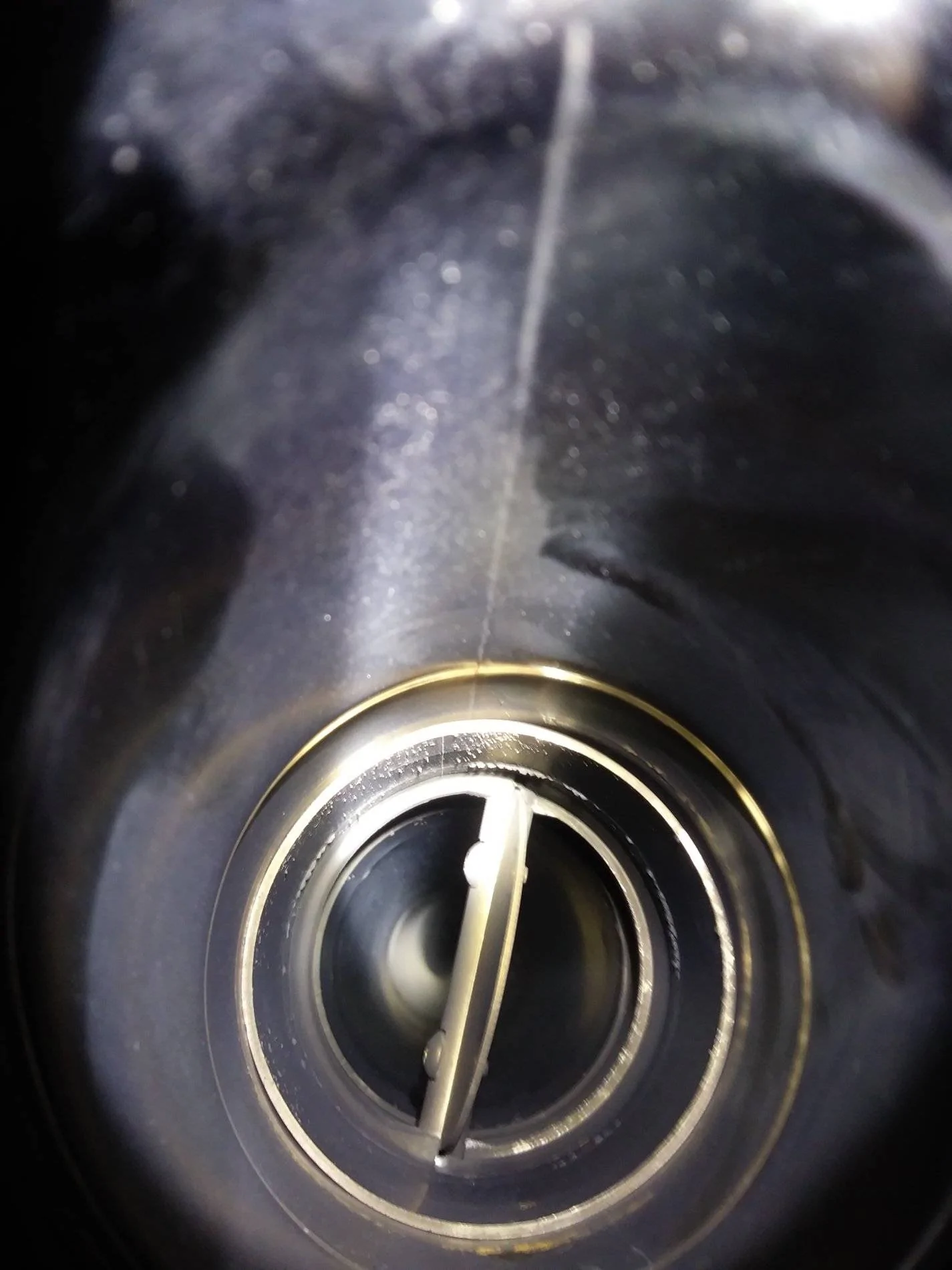

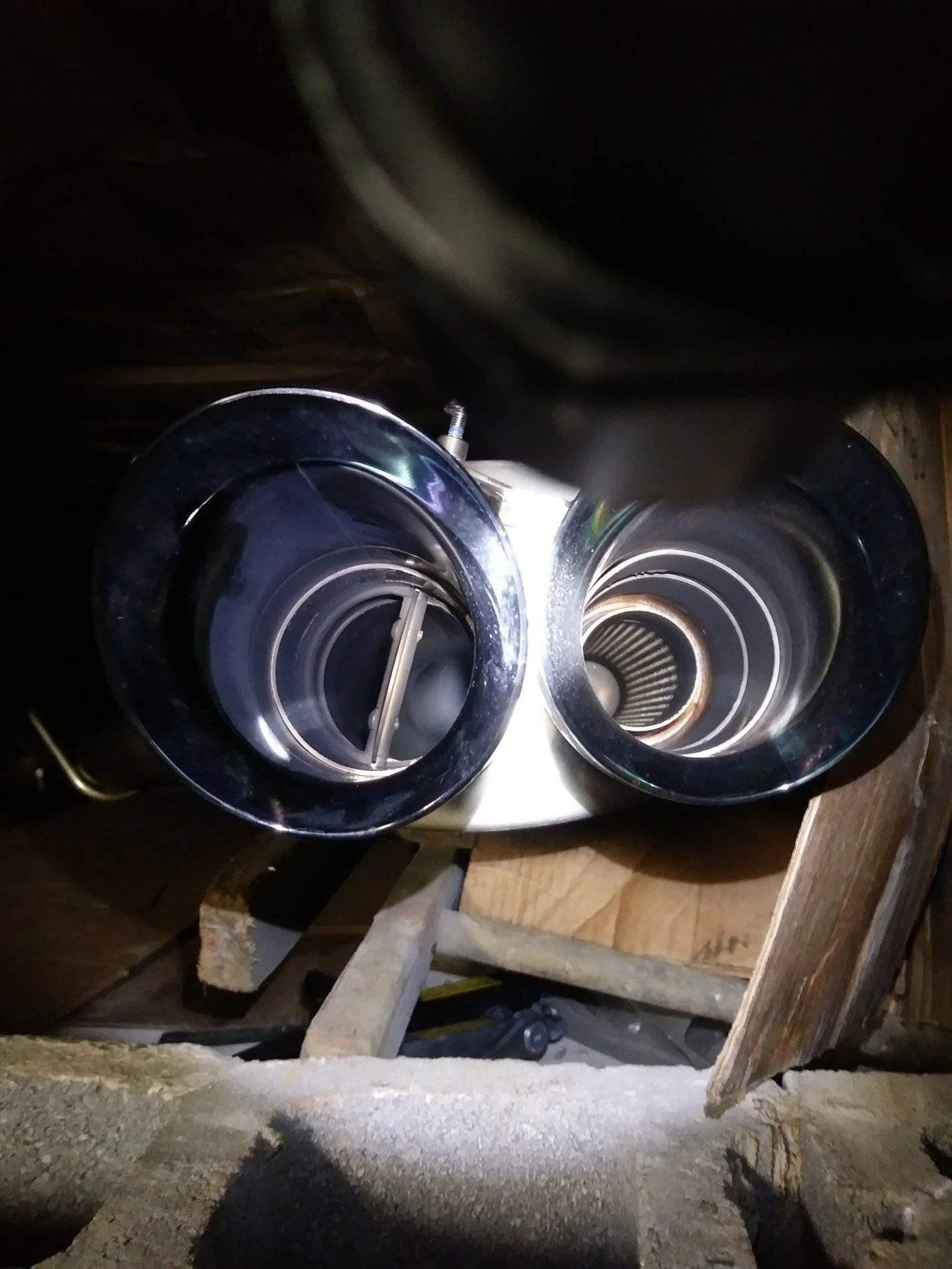

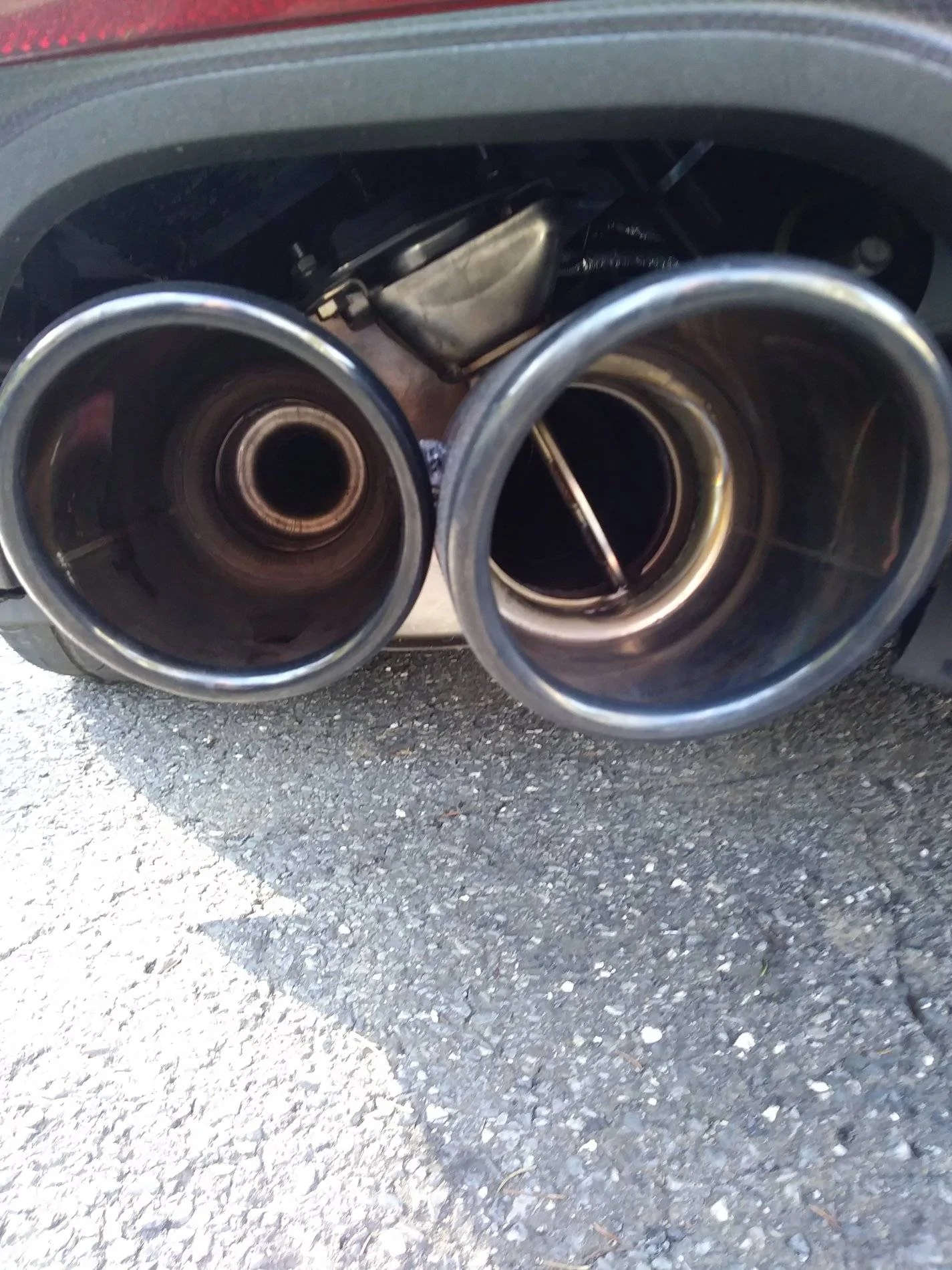

After checking the borla system it too is bigger than 2.5 inch. One thing i did notice is the outter pipe has a very little opening through it. This explains why the s-type non active catback i had on the car had a different sound to it and was louder than the act

Just a bit of a correction- on our 18+ active systems we use 3" tubing for the entire system up to the rear mufflers when it splits to dual 2.5". Our valves look very similar to the ones pictured and are sized to fit the ID of the tubing. There is no real benefit to using 3" tubing for the short distance between the muffler and the tip.
