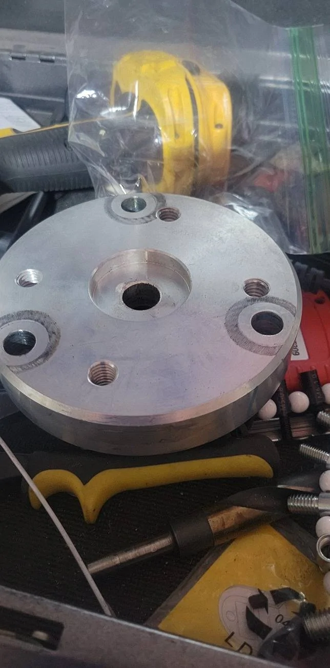

So I picked up a used dss 15-17 driveshaft for my 2015 mt82... it came with the 3 bolts that connect the adapter plate to the trans... but that's it.
I was told the oem hardware should work for the adapter plate to driveshaft (4 bolts) but the diameter is definitely off... any idea of what hardware I need, so I'm not spending forever at home depot.

I got it figured out
7/16-14 1 inch length
