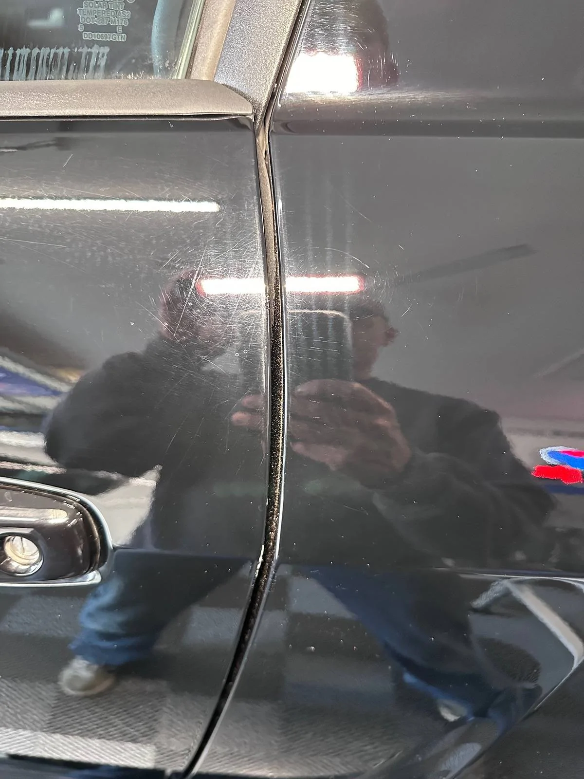

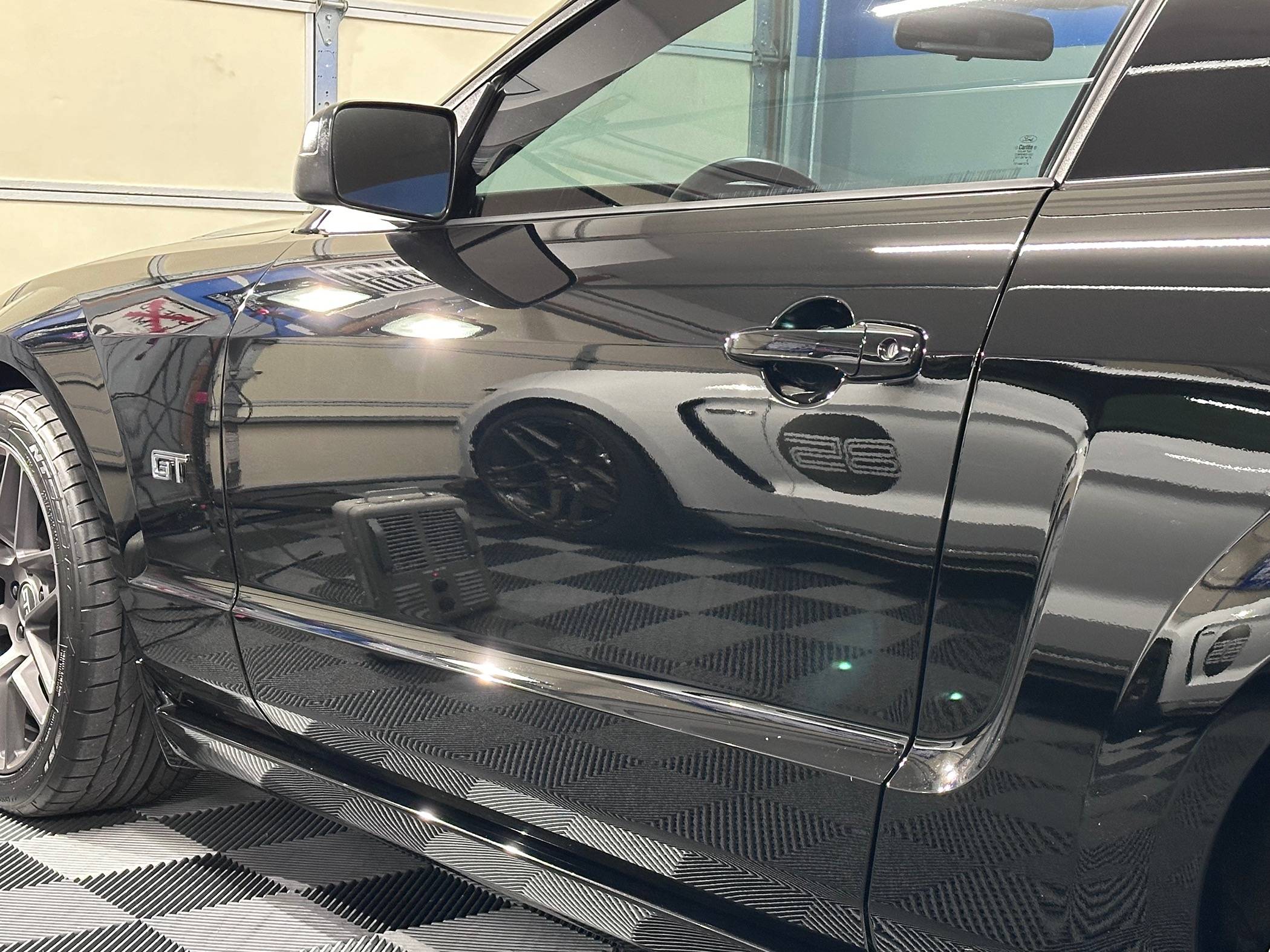

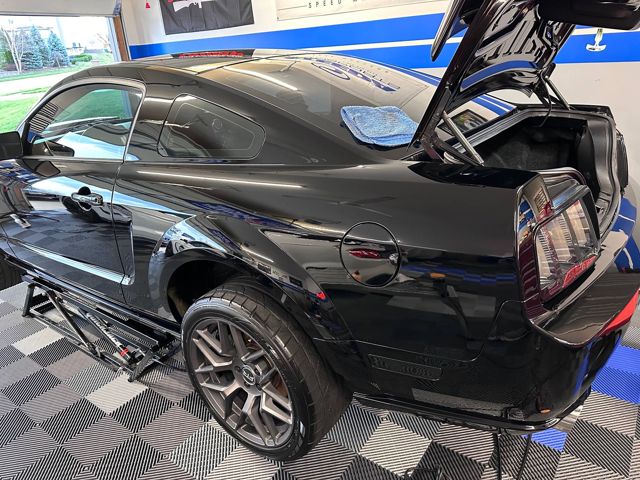

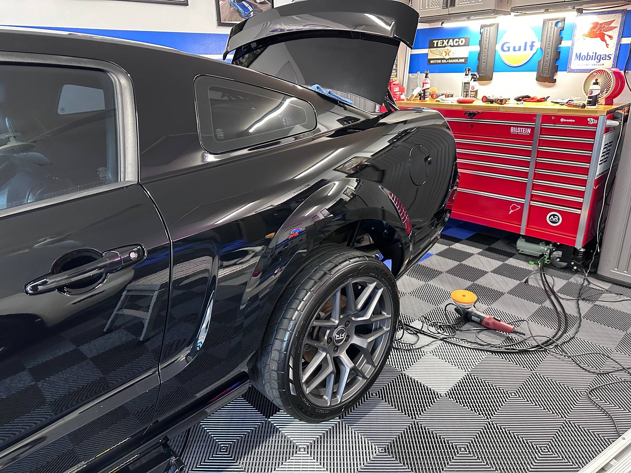

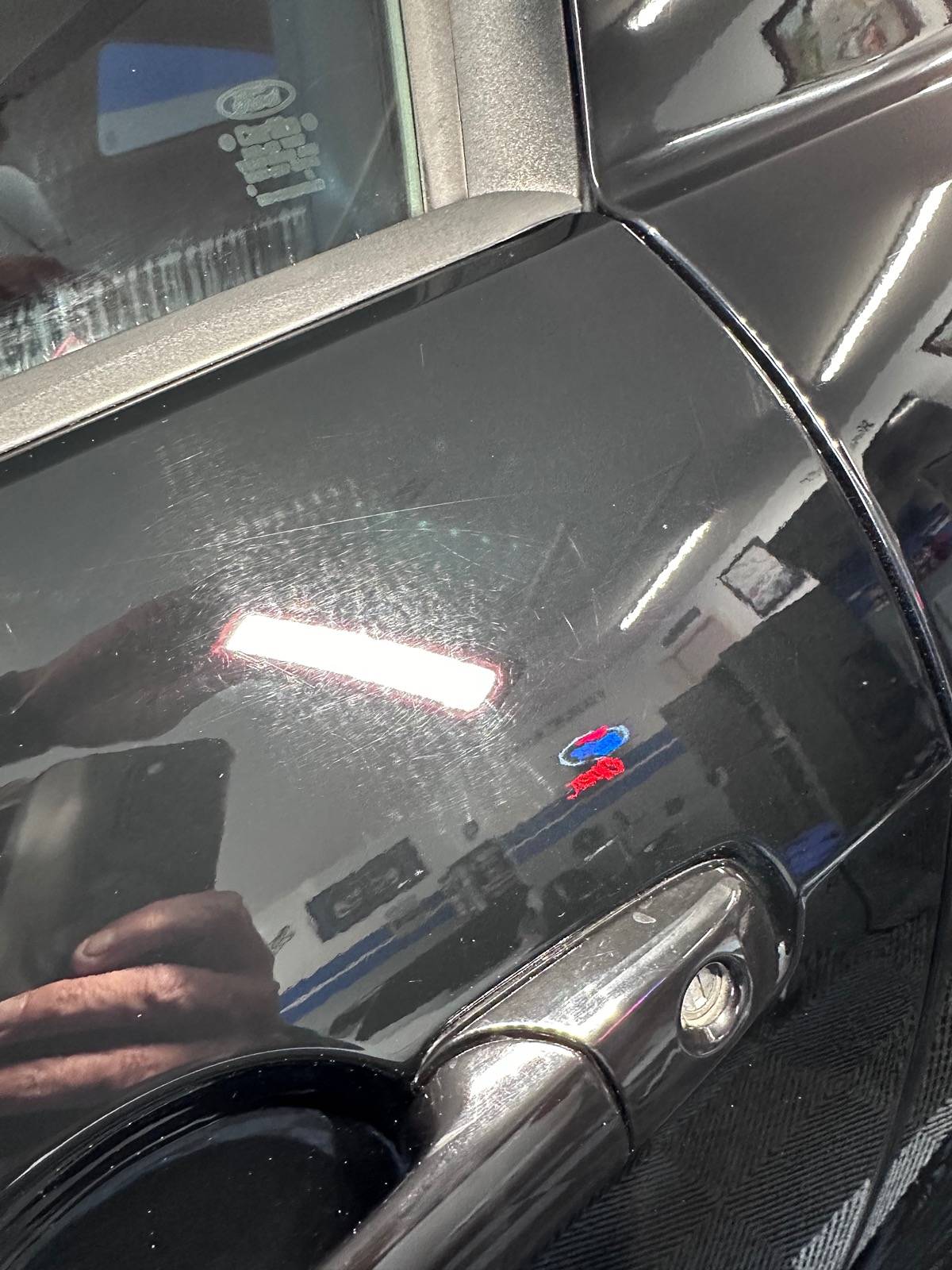

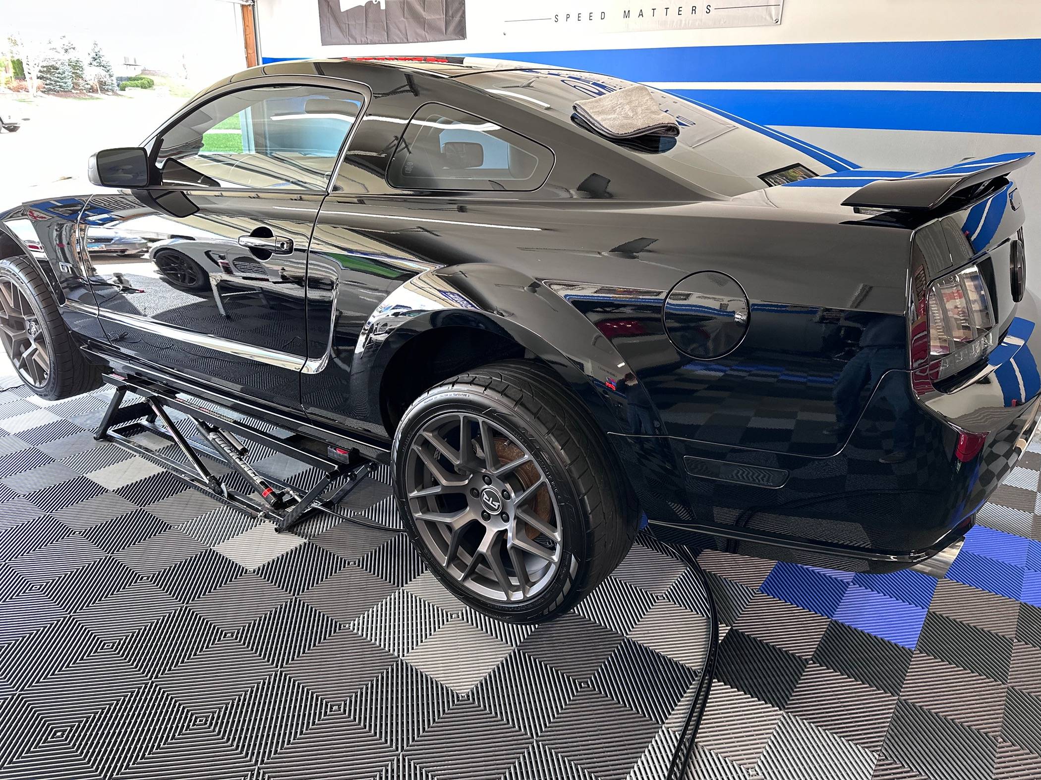

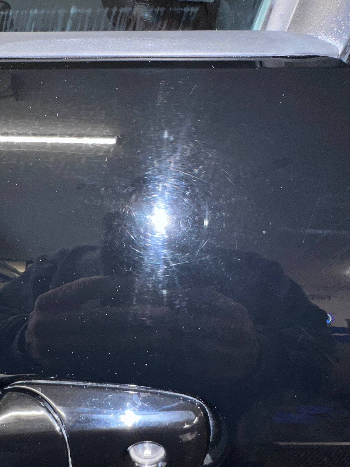

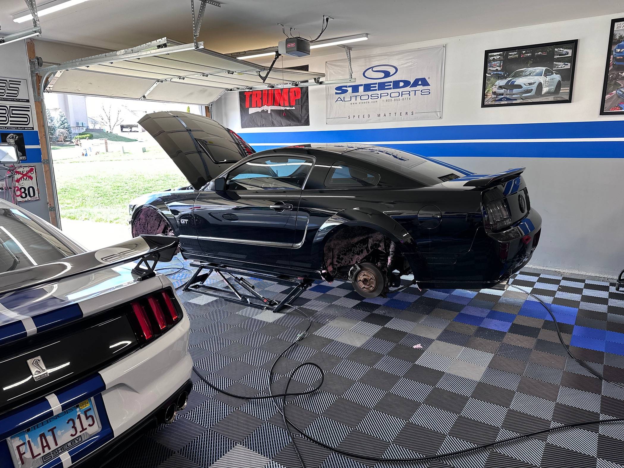

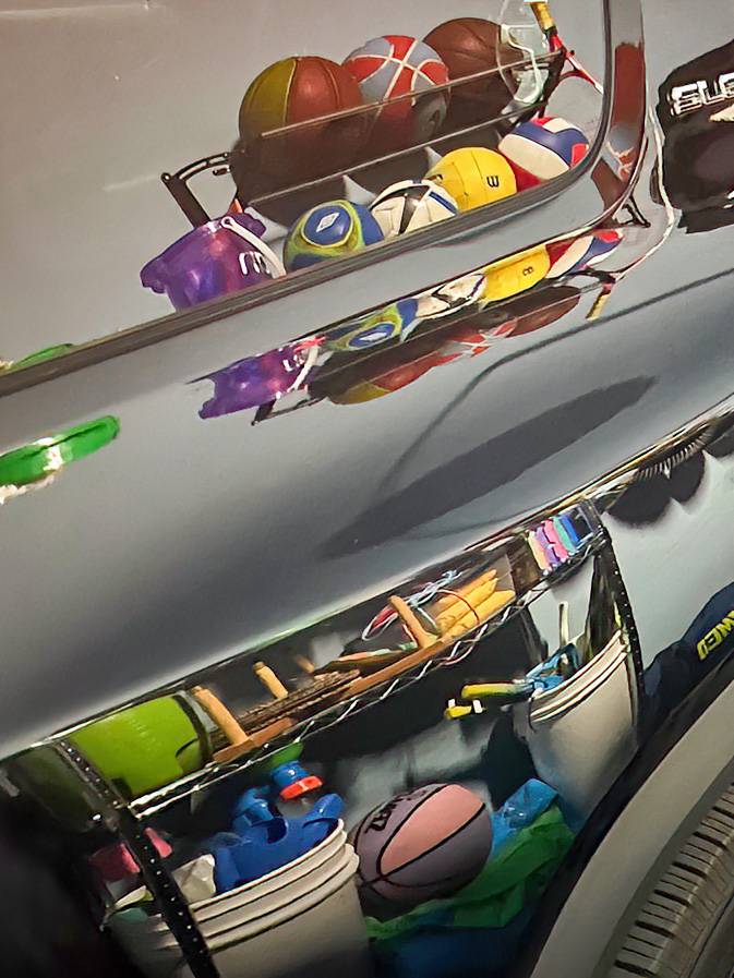

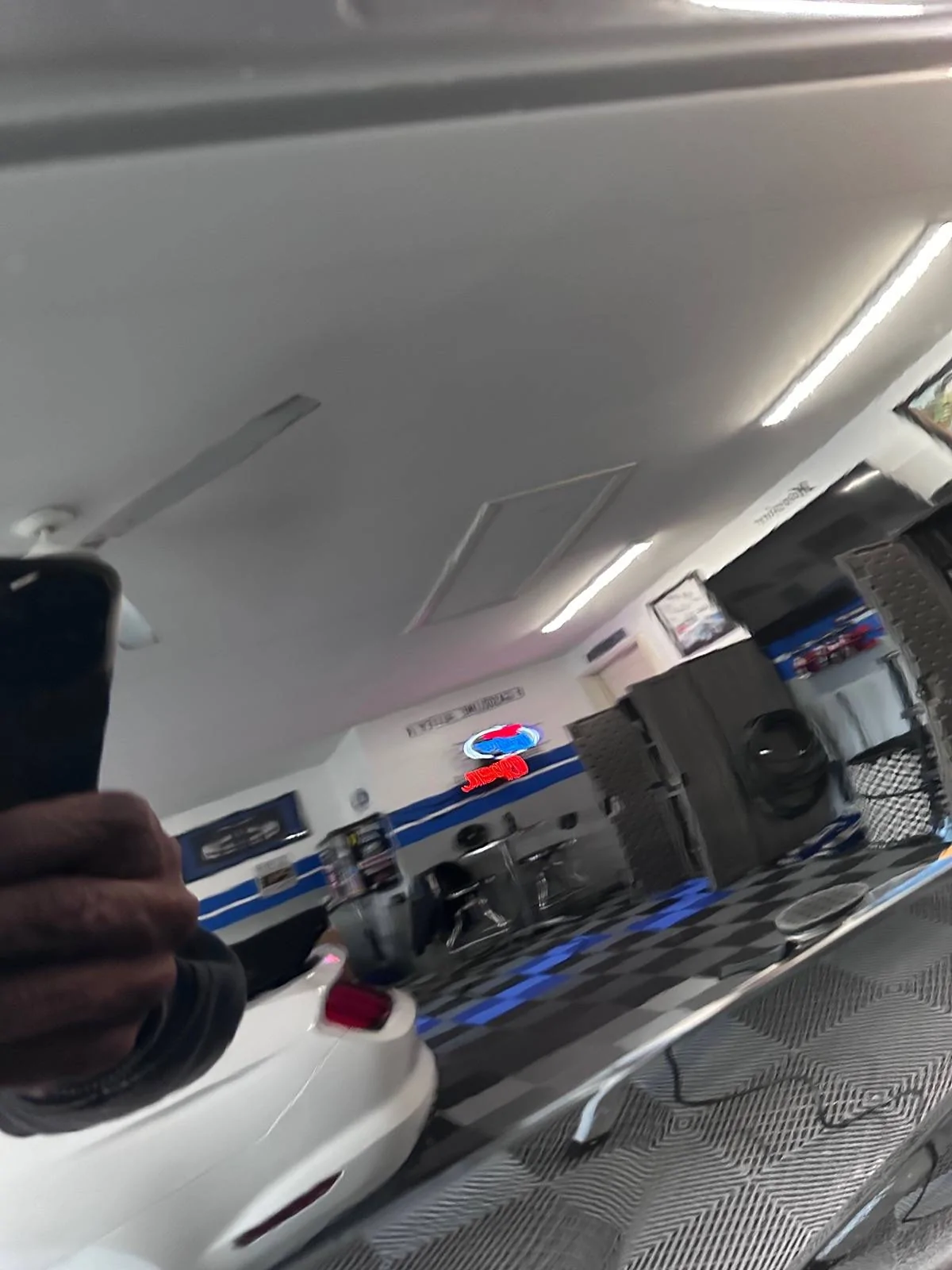

Thanks guys, thanks for the tips. Just to share, here's what I got my 350 to share in the stable. I'm a complete shit photographer, so I did the best I could with before-after shots. The car was done in (the older recipe) Adam's orange Correction Polish and then the white Finishing Polish. I used an Adam's white pad on the orange polish to soften the cutting effects on the black as it was not super horrible. Certainly needed some TLC, but most certainly recoverable. The final touch was the white Finishing Polish on a LC black pad. I don't know how I personally could have gotten it any better.
As a side note, what led to this thread...after the Correction Polish, I took a run with the newer recipe Adam's white Polish on a white pad, and I had pad/buffer trails all over the place. You could see every movement. One pass with the old Finishing Polish on a black pad took all that out. Anywho...enjoy...

They work great, and work the same as they would on any floor. Not that it matters (same concept, but mine are RaceDeck). They probably slide around easier with no weight on them, which is a good thing. But as soon as the car starts up, they're not going anywhere. Zero damage to my floor.

Many thanks for the info. This could get expensive............................................................. :giggle:
