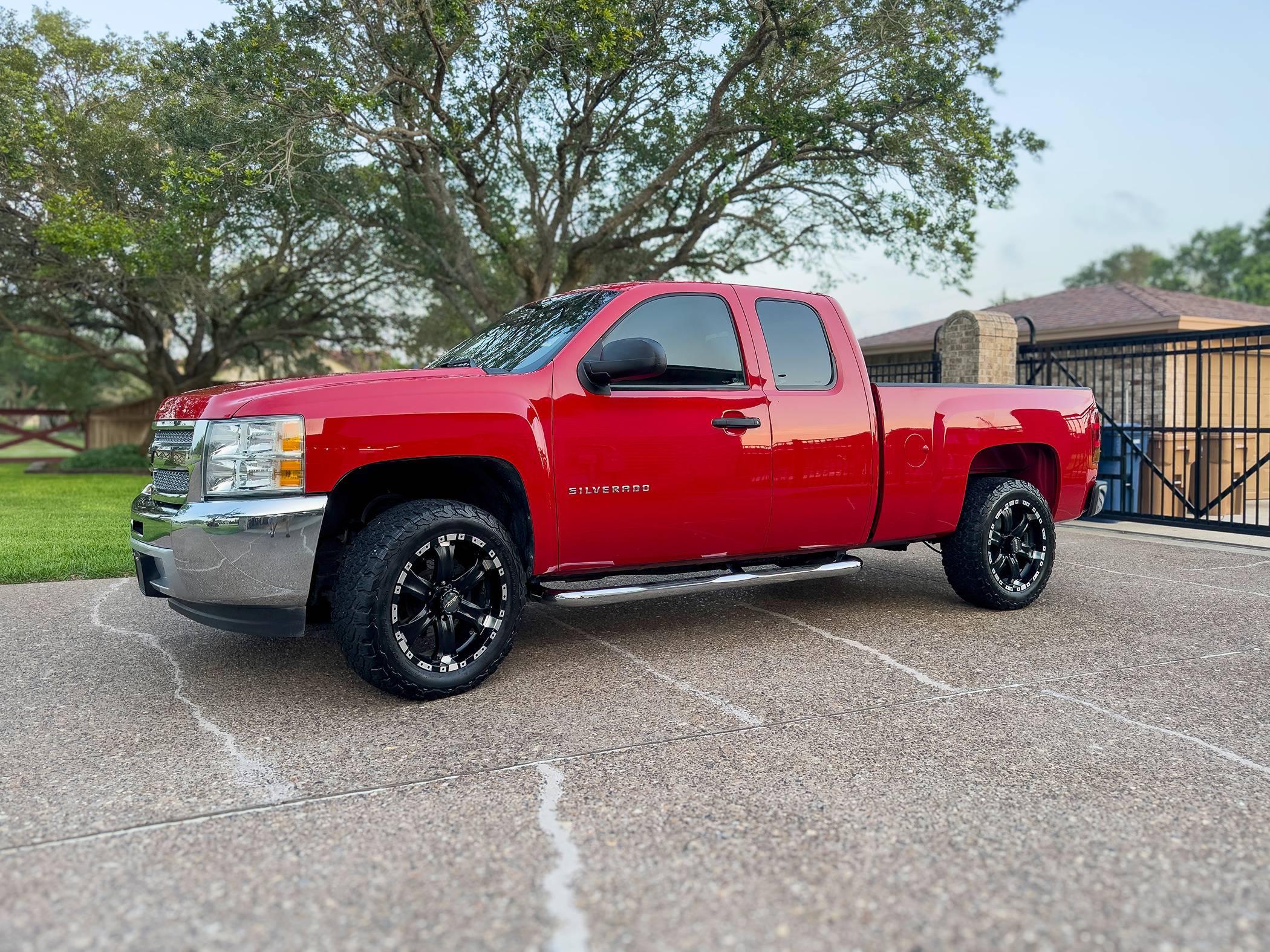

G: The Dmeister is right on, this combination covers a wide range of clear coat conditions. My friend brought this 2012 Silverado over a few weeks ago and while the paint was in decent shape, it still had a whole lot of marring. It also had some severe hazing which made it look dull as hell.
He and I spent the better part of half a day with a 5" BigFoot and while the excellent combo of pad and polish didn't get the heavy marring, it sure put some gloss back in the equation. Therefive, I highly recommend this combination and I'll be curious to read the comparison with Uno but, be sure and use the same brand/type pad that you used with the DA Fine.
Here's a shot of the truck after we finished so as D said, that combo can do some heavy lifting.
