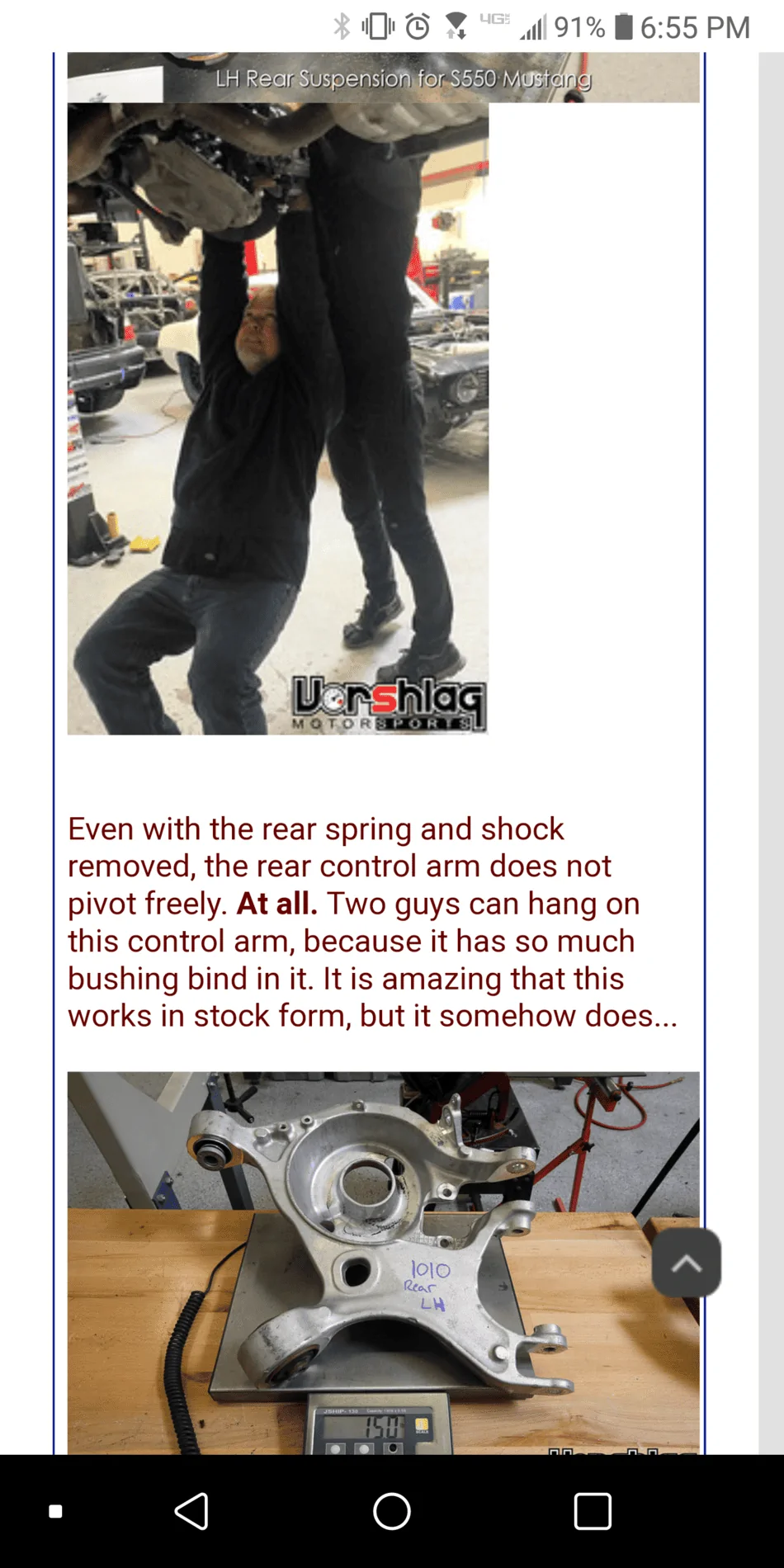

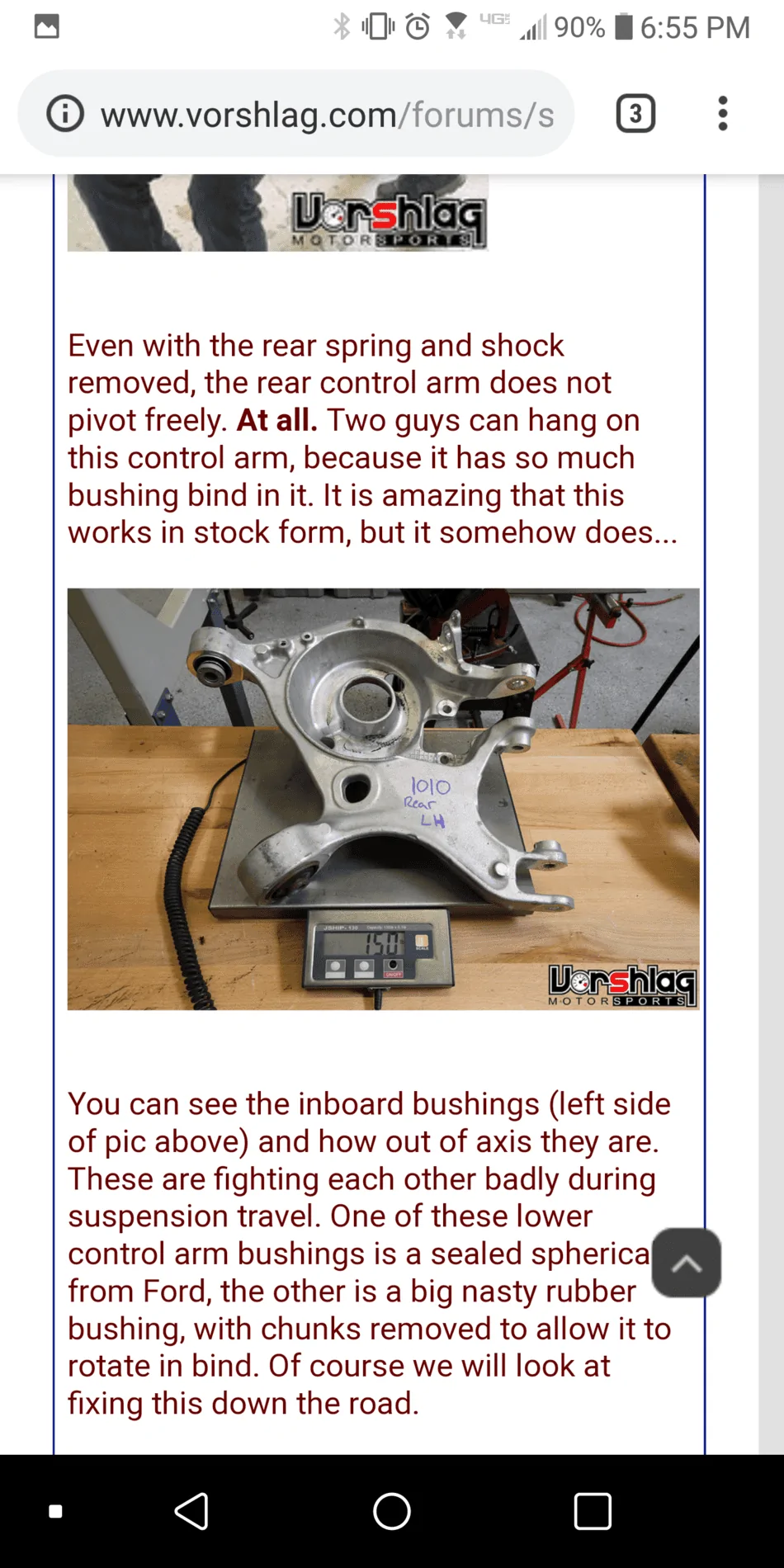

Yes it's for manufacturing primarily. A way to prevent the clunking would be to have a crush tube/sleeve inside the over molded tube, one which has nearly a press fit for tolerances. Enough to allow for rotation, won't bind up the arm when torqued. This would pretty much guarantee no clunking.
This is how bad the bind is (borrowed from Vorshlag blog). It may be taken into account, but I can vouch from experience that removing the bind actually is a noticeable and significant improvement to ride.
Tube inside a tube on the ID of the rubber part? I wonder how much clearance it takes for rod ends to start getting a bit rattley . . .
Seen that picture, and it's just crazy. Hope those bushings are fairly strongly progressive so you're not adding 50+ lb/in wheel rate immediately away from static ride height. I'll have to pay attention to the variation in tire to fender gap next time I'm near an unlowered S550 in traffic that's moving along at a decent speed.
It's on the ID of the rubber, but it's bonded to it, I believe via overmold. I'm not exactly sure on the clearance needed, but the nice (tight clearances) rod ends/sphericals don't rattle much, if any. I think there's a way to engineer it, they just chose the cheap route, despite being worse. My estimate is <$5 per car to change that to something like what I proposed. Unfortunately Flat Rock would complain and they'd cave.
