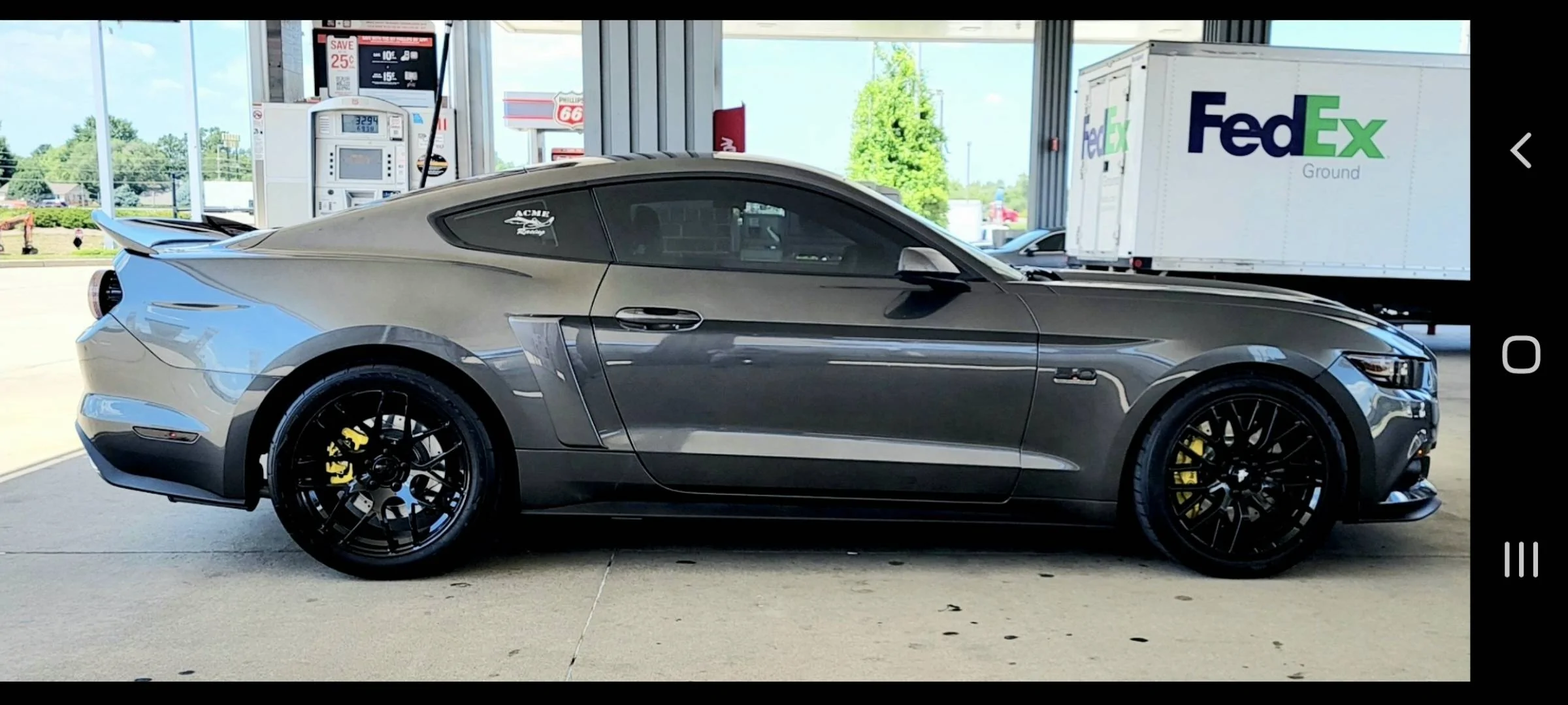

I'm running the pp 275 tires on the front with a 25mm spacer which I needed due to a slight rub when turning. On the rear 305/35/19 on eleven inch rim. I've got a wheel well gap in the rear which I hate. Will those springs you mentioned present any problems in the front? They should close the rear gap a bit. Check out the picture of my car.

I can't say for sure as I still run the OEM PP1 tires (255") up front on mine.
One person's opinion that 275 up front fits and he is lowered 1 inch: https://www.mustang6g.com/forums/threads/255s-vs-265s-for-front-tires.183602/post-3696314
