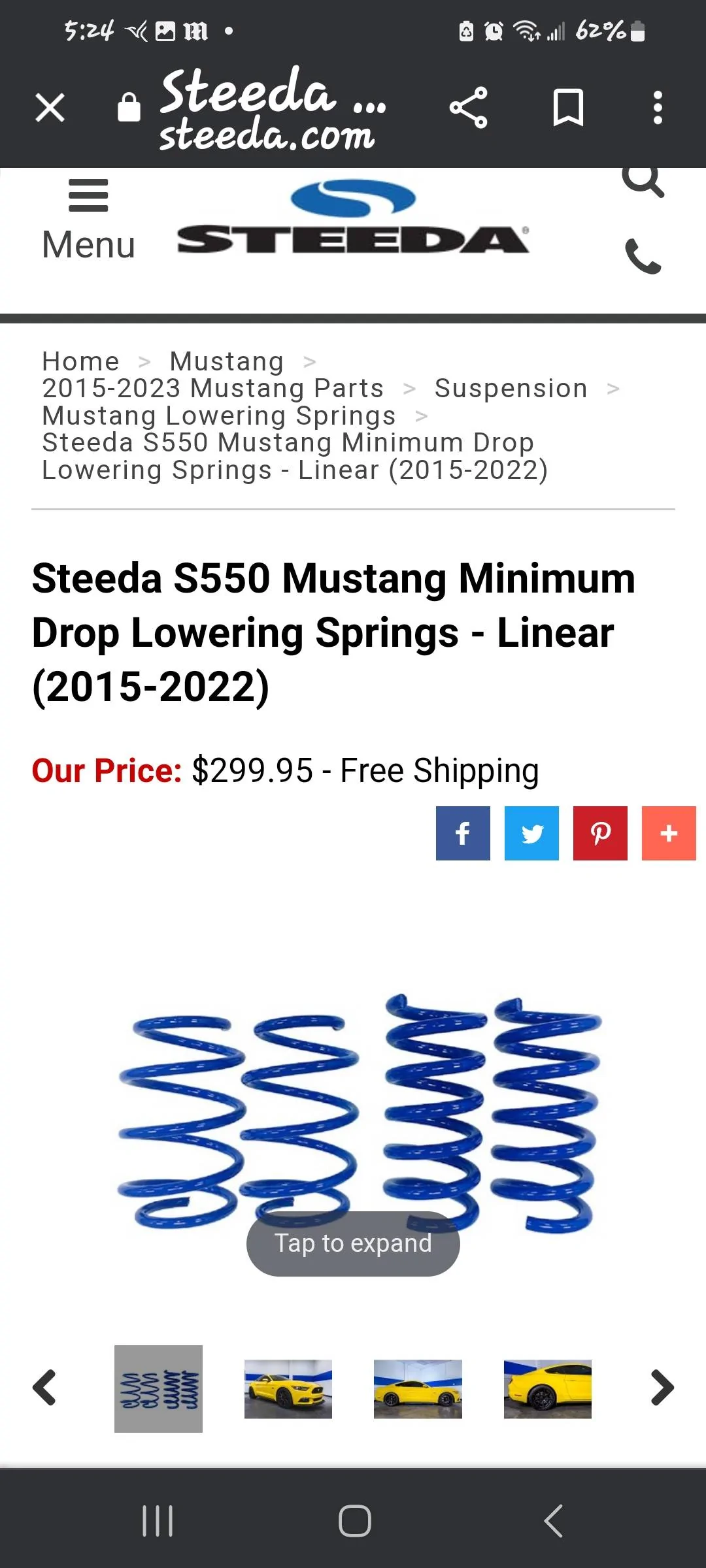

Where do I find the part number for the minimum drop springs? Is this the animal?

That would be correct. If you scroll further down that page you should see 555 8223 as the part number. :like:

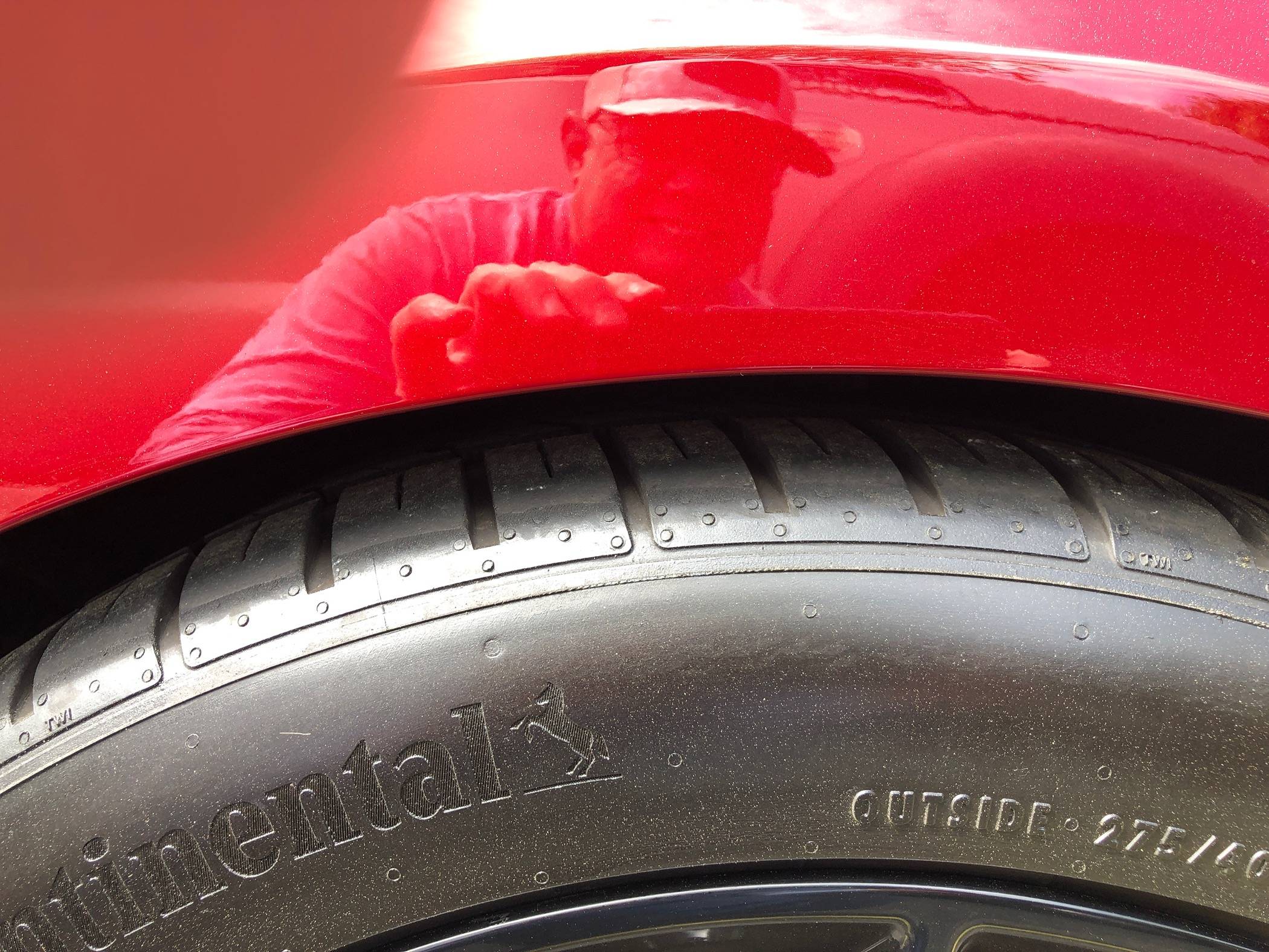

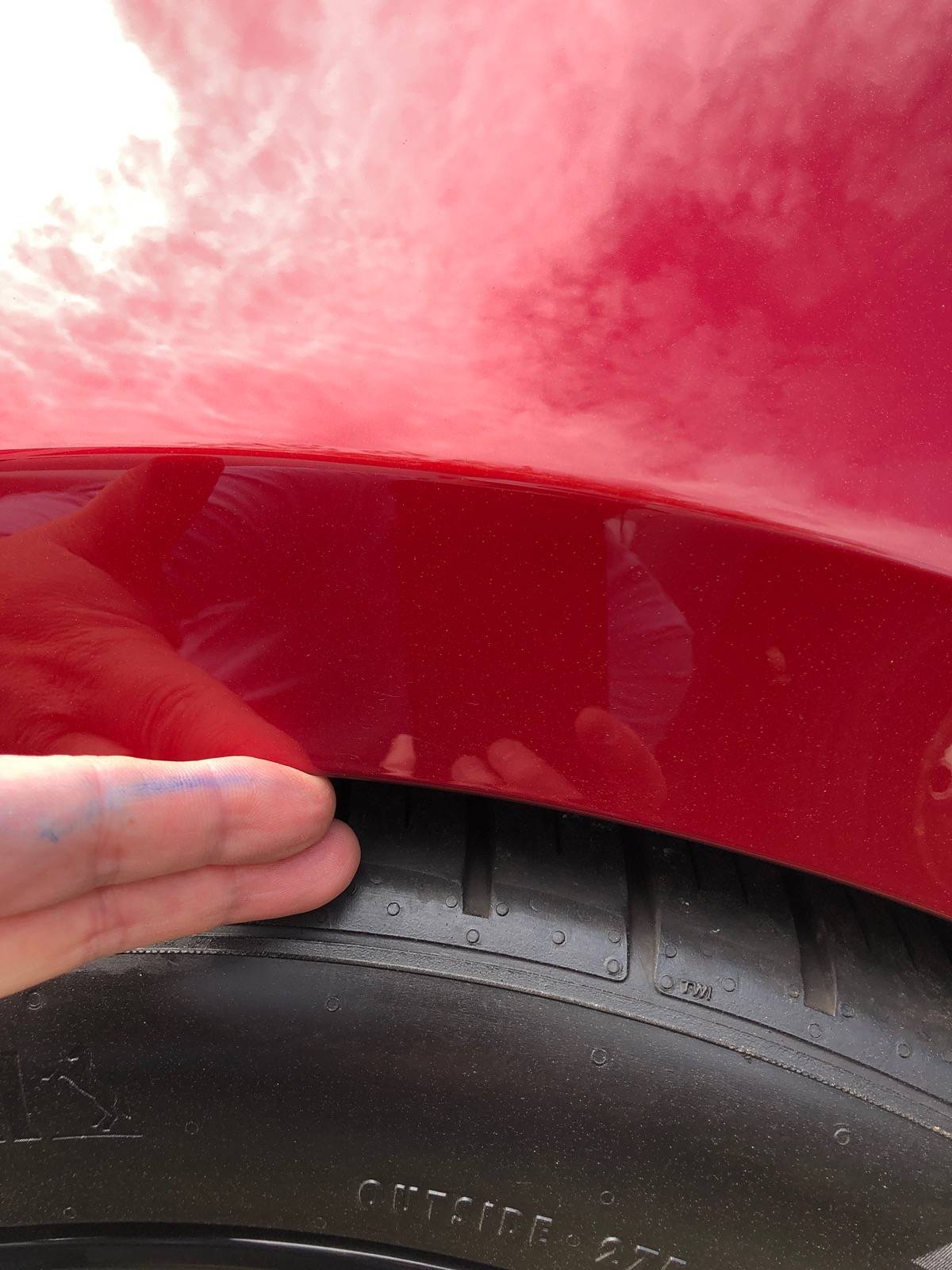

I have the factory PP1 19x9.5 275/40s on all 4 corners with 25mm spacers BMR min drop springs FP track shocks. No issues up front. BMR min drop springs are the perfect drop for what I wanted
How much is car lowered in the rear ?

Maybe a little more than 1/2 inch. Here is a pic. Less than 2 fingers with a 275/40
Hope that helps
