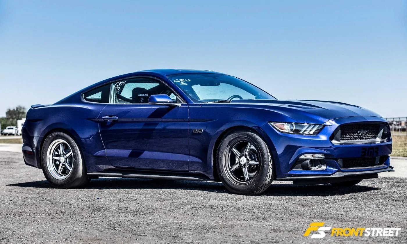

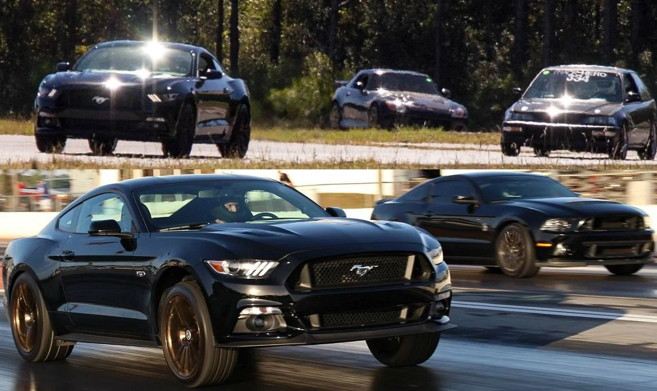

I spoke with Aerospace (or someone selling their stuff?) at the drag event at Commerce and they said these are intended for drag cars, not someone like me who road courses. These, I assume, are not on the car you road course - right?
PP Brembos on the black car, Aerospace on the Blue car. ;)
