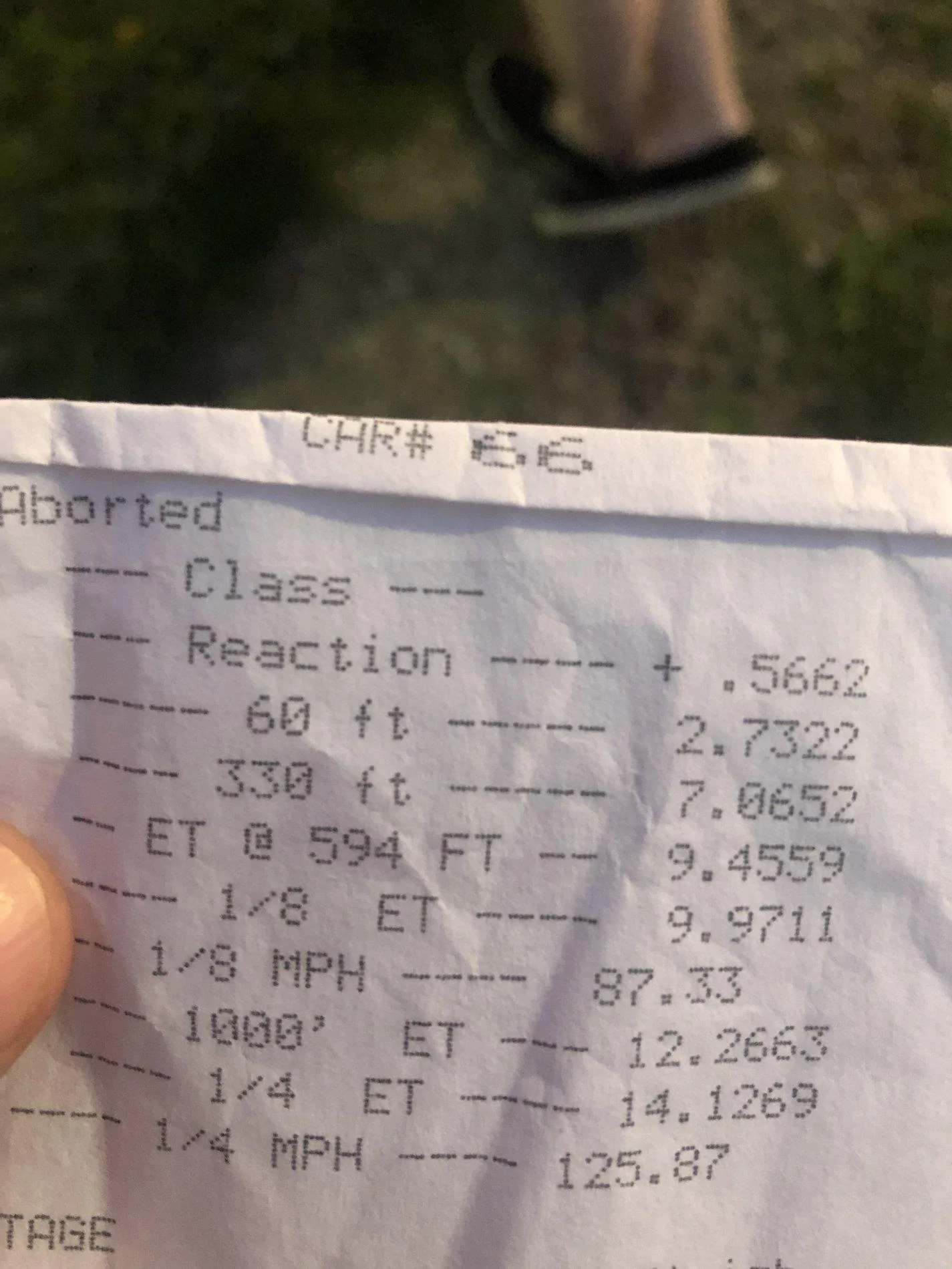

I know that MPH can be a good indicator of horsepower but at what point do both ET and MPH level out?
Last night went to the strip and only goal was get some good WOT data logs for my tuning of my P1X install. I knew my ET was going to be horrendous being on my thrashed Pirelli’s. Knowing traction was going to be useless I started rolling out in first pedaling it through rpm range and then shifted in to 3rd knowing 2nd would be useless as well. Car went pretty straight soft shifted to 4th and rode it out. Results a whopping 14.1 but @ almost 126mph.
With that when I do actually get a better tire and the ET’s drop how much more MPH would you speculate? Back to when do ET and MPH reach a leveling point? Thanks for the input.

A lot of people will claim only mph is good indicator of power, BUT et plays a huge role in mph. So if you spin on the line, or like your case baby the shit out of it mph will suffer big time. Think about it. By not applying maximum acceleration you are effectively shortening the race track. Our small tire heads-up car if the 60' goes from say 1.11 to 1.15 it will lose 3-4 mph on the exact same top end tune.
You have to run hard early to run big mph. Given how soft you were and skipping 2nd and soft otherwise with a manual I'd say 126 is pretty damn decent. I trapped best of 139.** spinning lightly in 1st, and heavily in second with an auto. P1X on E85. Abysmal 1.52 60' or something like that, but the most spinning was 2nd gear right after the 60' blocks.

With that 2.7 sixty. Its impossible to guess what the car will run with traction.

Car picked up almost 40mph in the second half and I imagine there is alot more in it.
Probably the worst 60' I have ever seen...lol

Yeah wasn’t caring about any of that. Was thinking some data logging on the track versus Mexico was a safer bet. Until I got the car sideways at 60mph on the second run. After I unclenched my ass cheeks at gotten straightened out still trapped 122mph.

As said , you can't extrapolate any useful data out of a pass where you baby the car for 330' or more. Go back with a proper tire.

from other supercharged stick cars I've seen your gonna mph 130-133 and et from 12.5 to 12.0 you will be fast but not quick
