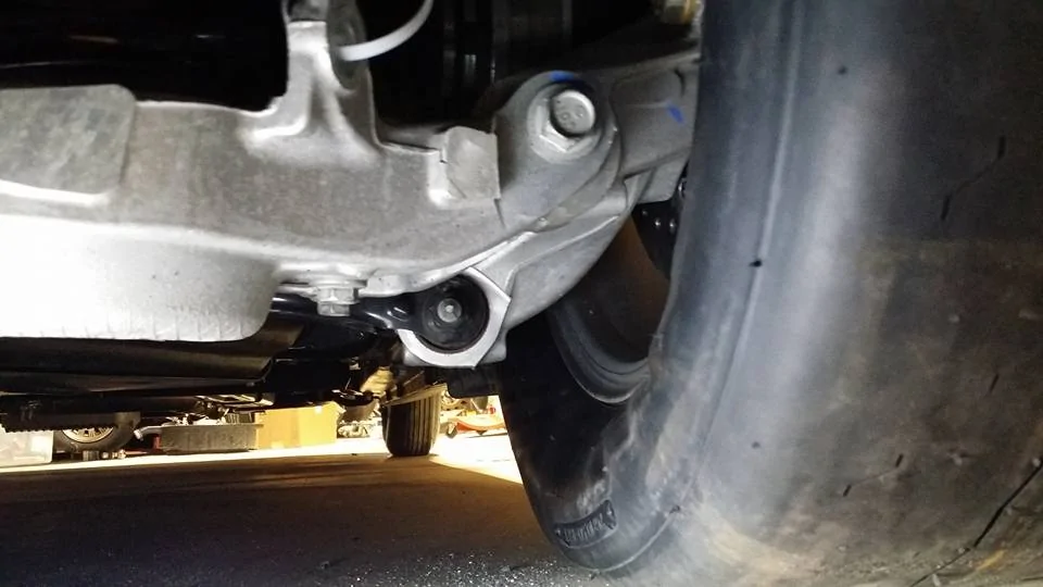

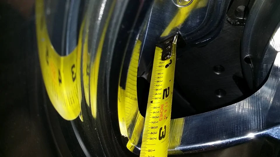

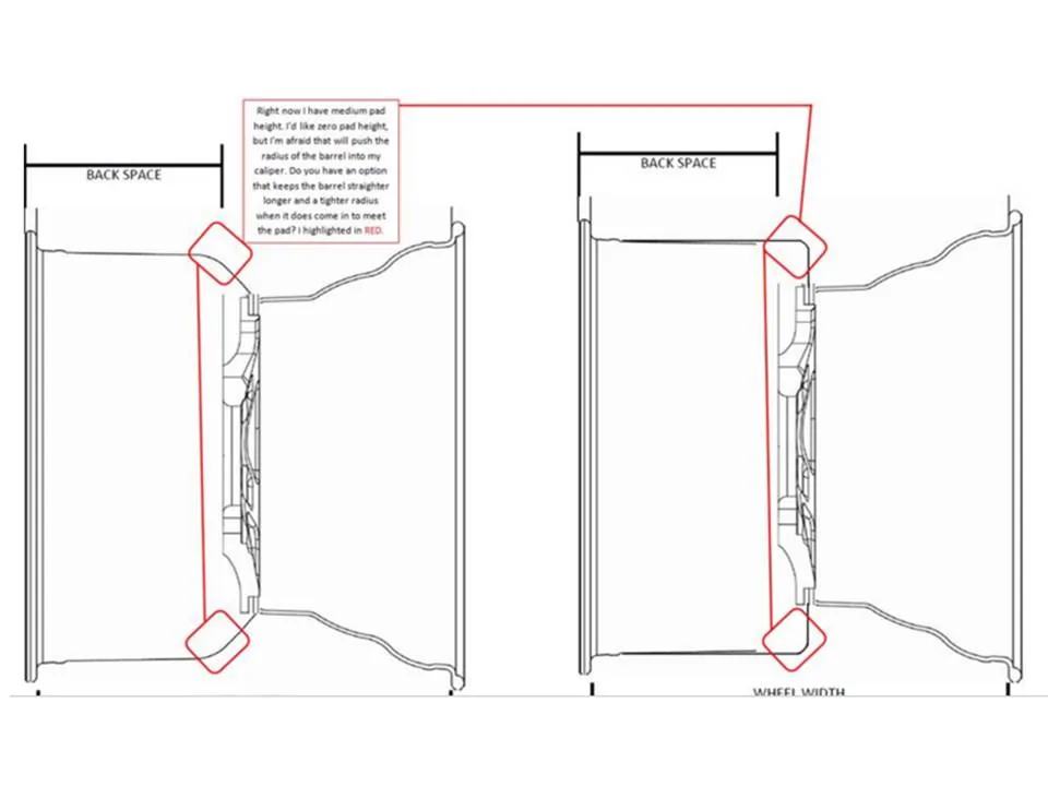

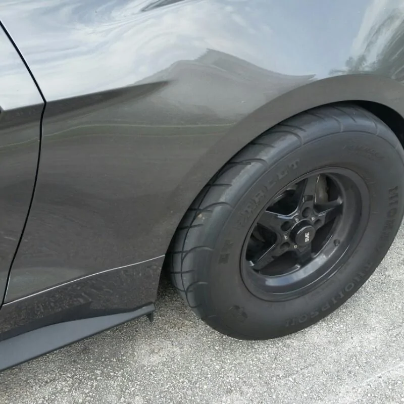

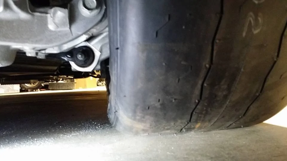

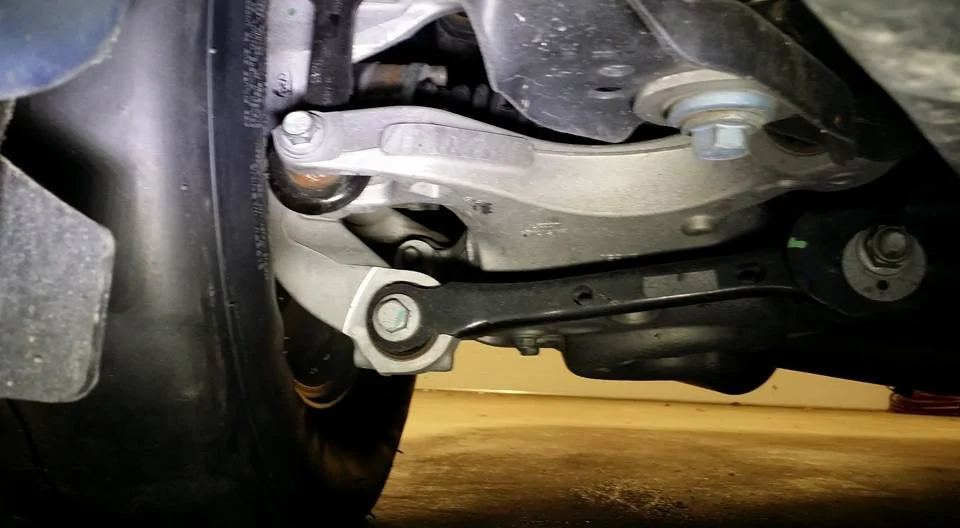

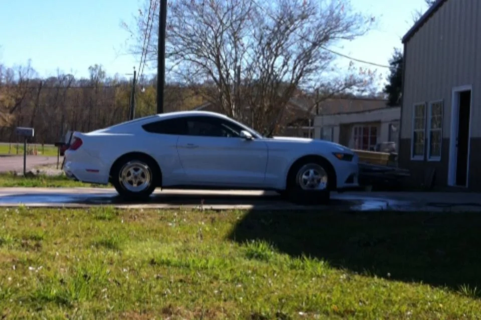

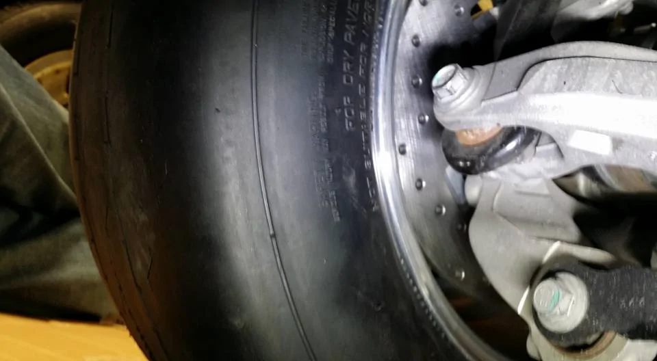

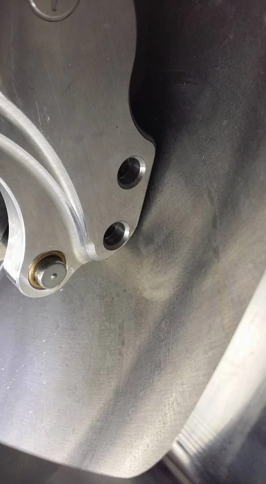

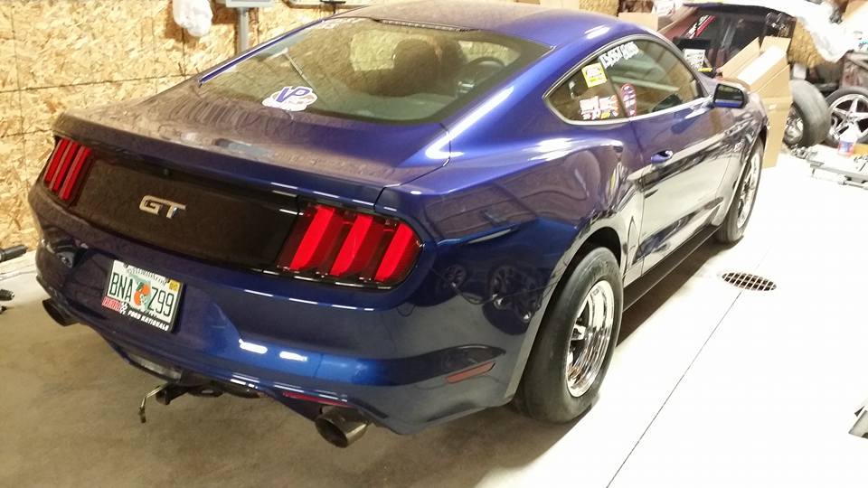

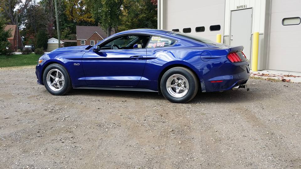

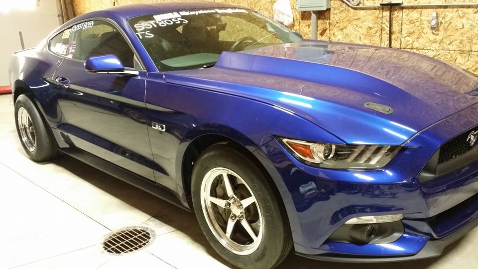

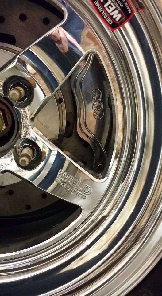

This post is more to give a fellow forum member an idea of what is involved in getting 15" wheels on an S550. Keep in mind this was a first try and I'm going to a 1" wider rim, with 1" more BS in the near future(15x9.33x6.5BS), this is a total of 2" inward movement from the pics shown below, I may need a small spacer and some grinding. Due to the barrel(inner dia. of the rim) slowly tapering inward, it is necessary to use a "Medium Pad" when using Weld RTS's to clear the caliper. The following pics should help show the problem areas. And the link below is my install of the Aerospace Components brakes, for Drag Racing. I will also be going to a 28" tall tire and 3.31's to keep my rpm's close to my 3.15's, this will give me just a couple more hundred rpm's at the Big End. In the pics those are 26" tall.
