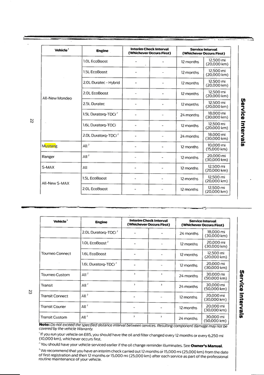

Shame they don't give you 24 months since the EB won't likely be serviced again in the next year.
Are you sure as the Ford Service Portfolio booklet states 10K miles service interval for ALL engines.
