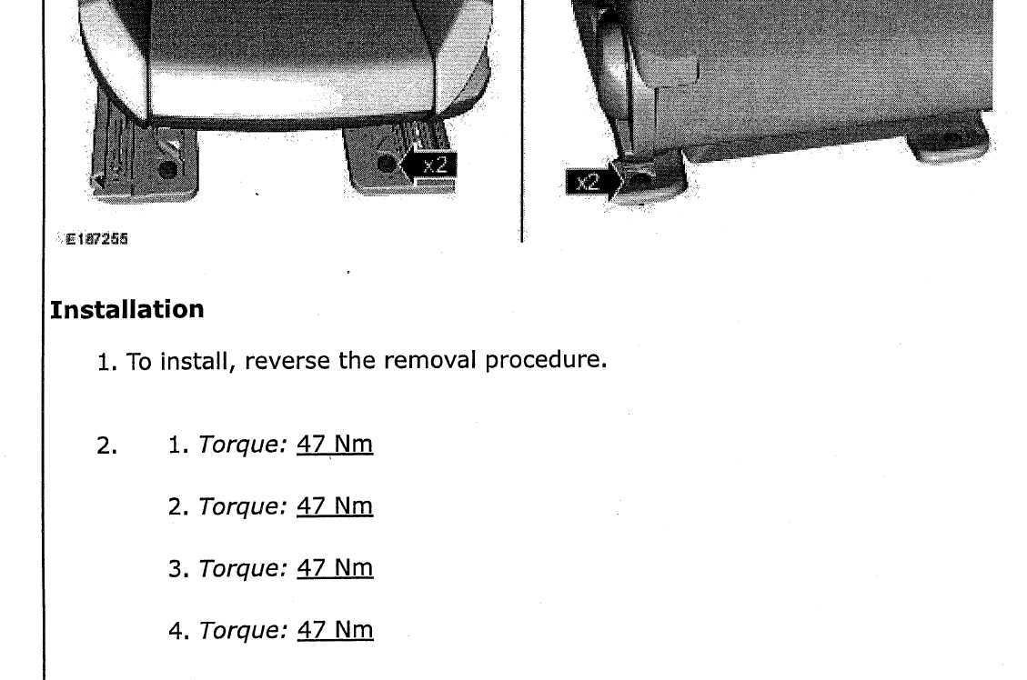

Do you happen to know the TQ specs for those bolts?
I have a similar issue that I've not had it looked at yet but I can easily check the TQ on the bolts myself.

Ford provided me with this :
