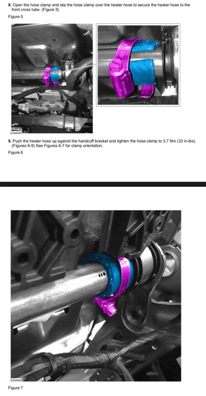

So, back on topic, I took a look at mine and bulletin number 20-2171 applied to my car, and I verified the problem addressed by it is occurring on my seat. Lateral movement / clunk when cornering. If you look under the seat at the front mechanism cross tube and apply force sideways back and forth (lateral) you can see it move about a couple millimeters each way. The fix, I shit you not, is to put some heater hose on the tube and hold it on with a hose clamp, effectively making a soft end stop so the clunk is either less noticeable, or so it doesn’t move as far. I’m not going to take it to ford to do this retrofit, I’d rather do it myself. Since it’s not a broken part and not likely to get worse, I’m in no hurry. I’ll get to it soon enough.

Heard from dealer today, they contacted Ford tech, result since tsb did not fix Ford is sending both seat tracks, seat to be disassembled and minimum 6 hours, wants me to leave it but I am 30 miles away and looks like I have to hang around as Ford me not supply courtesy vehicle or rental. Hopefully they will put everything back together properly and it works.
