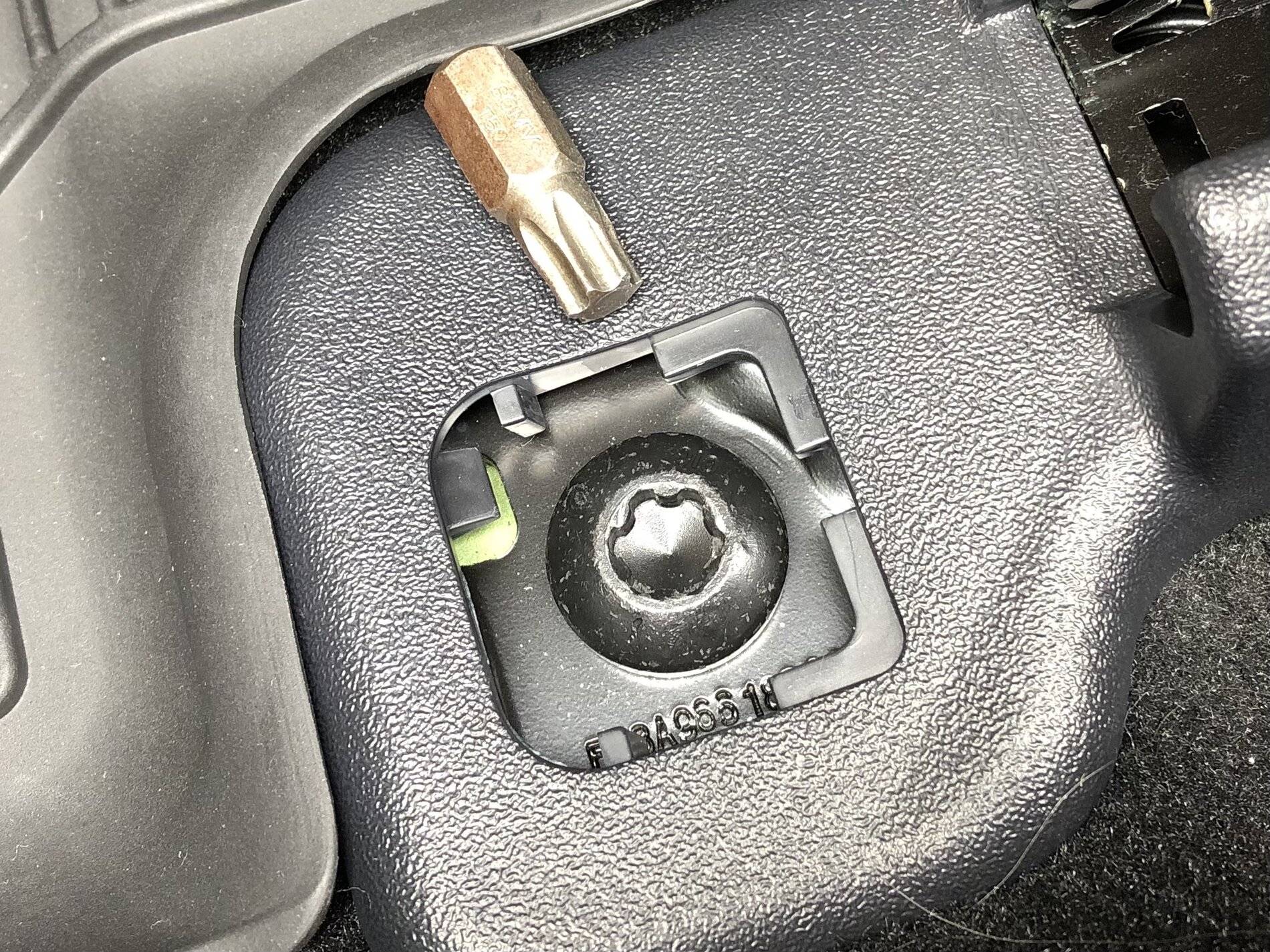

Hi, Does anyone have an update on this ?
I've gone to strip my 2020 drivers seat out and ford have changed, it’s not T50 anymore … It’s bigger with a more square profile :
Any idea what this drive type is called and what size it is ?
Cheers,
WD :like:
edit : looks like it might be ‘torx plus’ in size TP55

It seems Ford changed the front seat bolts at some point, because everyone on here who has a 2015, all thread responses point to the standard Torx T50…. So not sure if that remained a T50 up to 2017 or what….
What is seen in your image is definitely a Torx Plus star pattern. Don’t try using a standard Torx, as it’s too sharp of a star and won’t seat correctly into the TP star… you’ll either round the TP head (which will suck) or twist/snap your standard Torx bit.

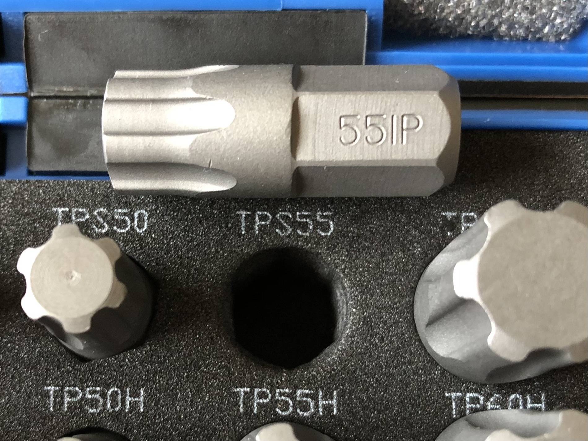

I had convinced myself it was a TP55 size as it measures 11.3mm across the recess and have already ordered a set from Amazon U.K. which should arrive today.
The only trouble is, if they don’t come before midday I won’t have time to do the job I wanted (new seat cover for the base).
I will confirm the updated size when I know for sure :like

Confirmed, ‘Torx Plus’ size 55 :
Also appears to go by the names of ‘55IP’ and ‘TPS55’ :like:
Hopefully this info may help someone else in the future and it might save them what should have been a well planned weekend … :facepalm: :giggle:
