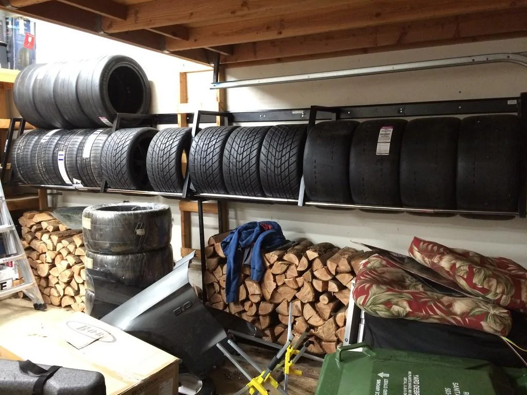

i have forgestar cf5 +56 18x11 w/ 315/30R18 hoosier A7 and enkei pf01 18x10.5 +38 w/ 305/30R18 hoosier H2O
that said, they've been collecting dust for a few months waiting for my MCS struts/shocks and vorshlag plates to arrive (next week i'm told, finally!!!!!!). for one, with the camber bolts i'm currently running to max out at -3.5, even with a 20mm spacer up front there is tire interference with the strut body. regardless, there's waaaaaaay too much roll and pitching/diving on eibach springs that can't be controlled with the stock dampers, and i'm not willing to sacrifice a sticker set of tires as a result!
however, i have been taking the car out to local events on my old S197 FS 19x9 +36 w/ 295/30R19 a6 setup; not ideal, but they mount up fine, with occasional rubbing at full lock under load:
if you're looking to keep costs down, 18" hoosiers are cheaper than 19", but you'll struggle to find any 18" wheels to clear the 6pots, other than going with custom/pricey options. at this moment, the only other off-the-shelf option that has confirmed clearance, other than the cf5/pf01, is the HRE FF15. forgeline and ccw will build you a $$$$$$$$et though :)
if you're new and want a square setup with some stick for fun, i'm sure you could run a stock 19x9.5 rear up front (maybe with a small spacer) and 295 hoosier takeoffs from somebody like john berget tires (or your local road racers) at very reasonable prices.
