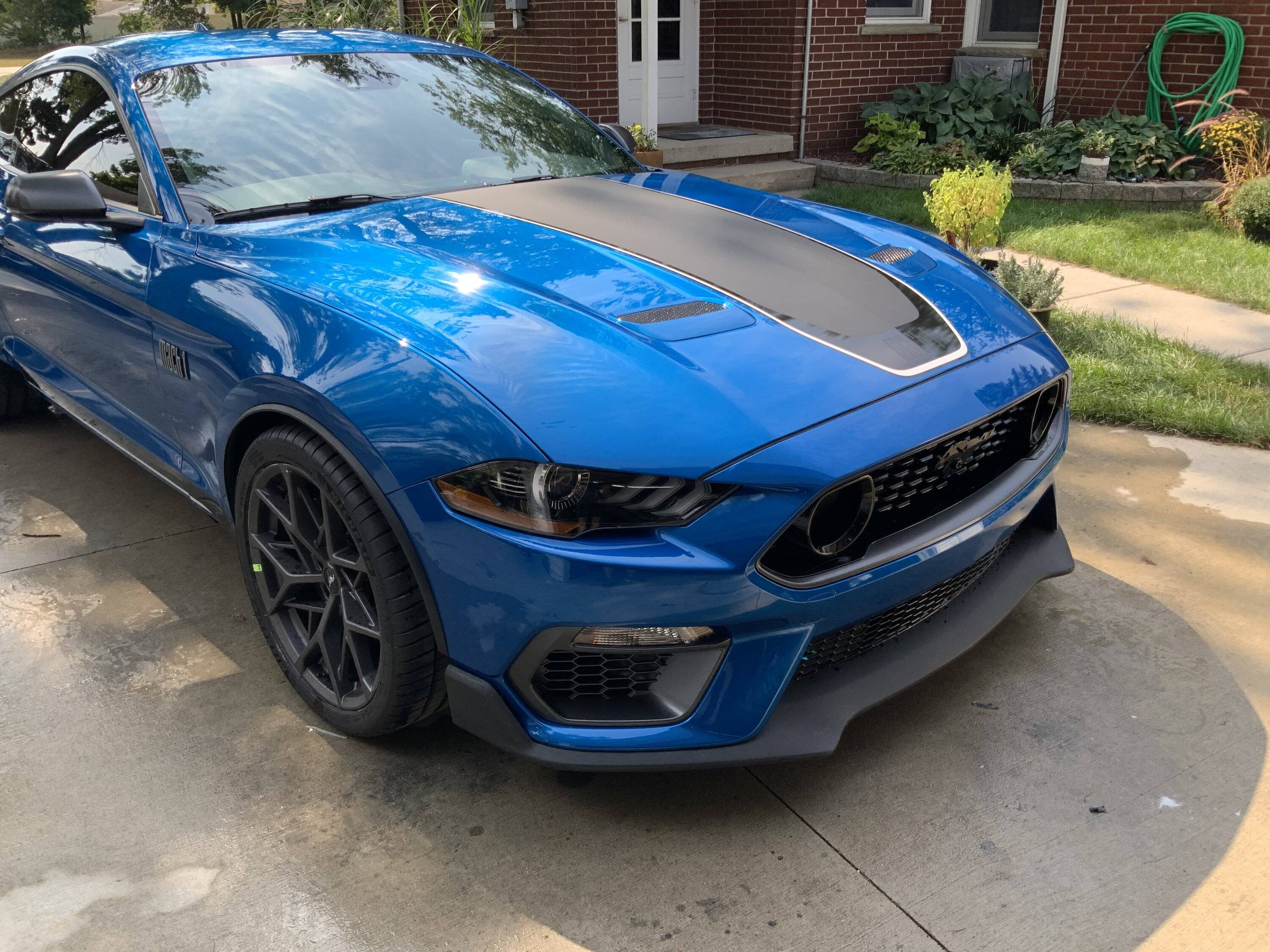

Huge progress, super cool. Have you been able to start the engine yet?
Thanks and yes, engine fired right up and sounds great which was a welcome relief. We’ve installed the new radiator/fan assembly and let idle for a while to fill with coolant, no drama so far.
The only damage I didn’t anticipate was the bent strut and those are on back order so I haven’t been able to drive it yet.

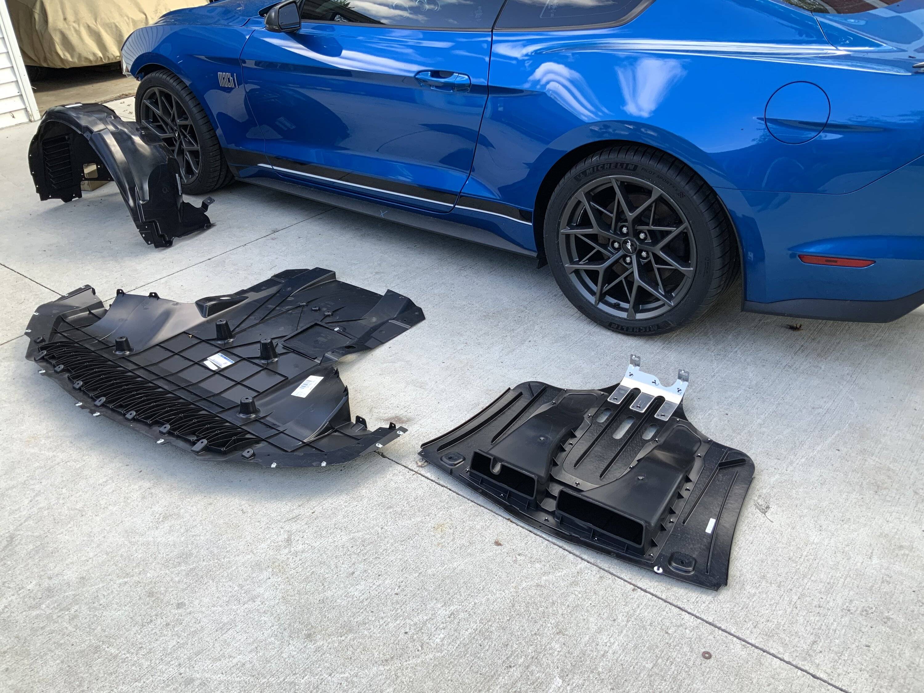

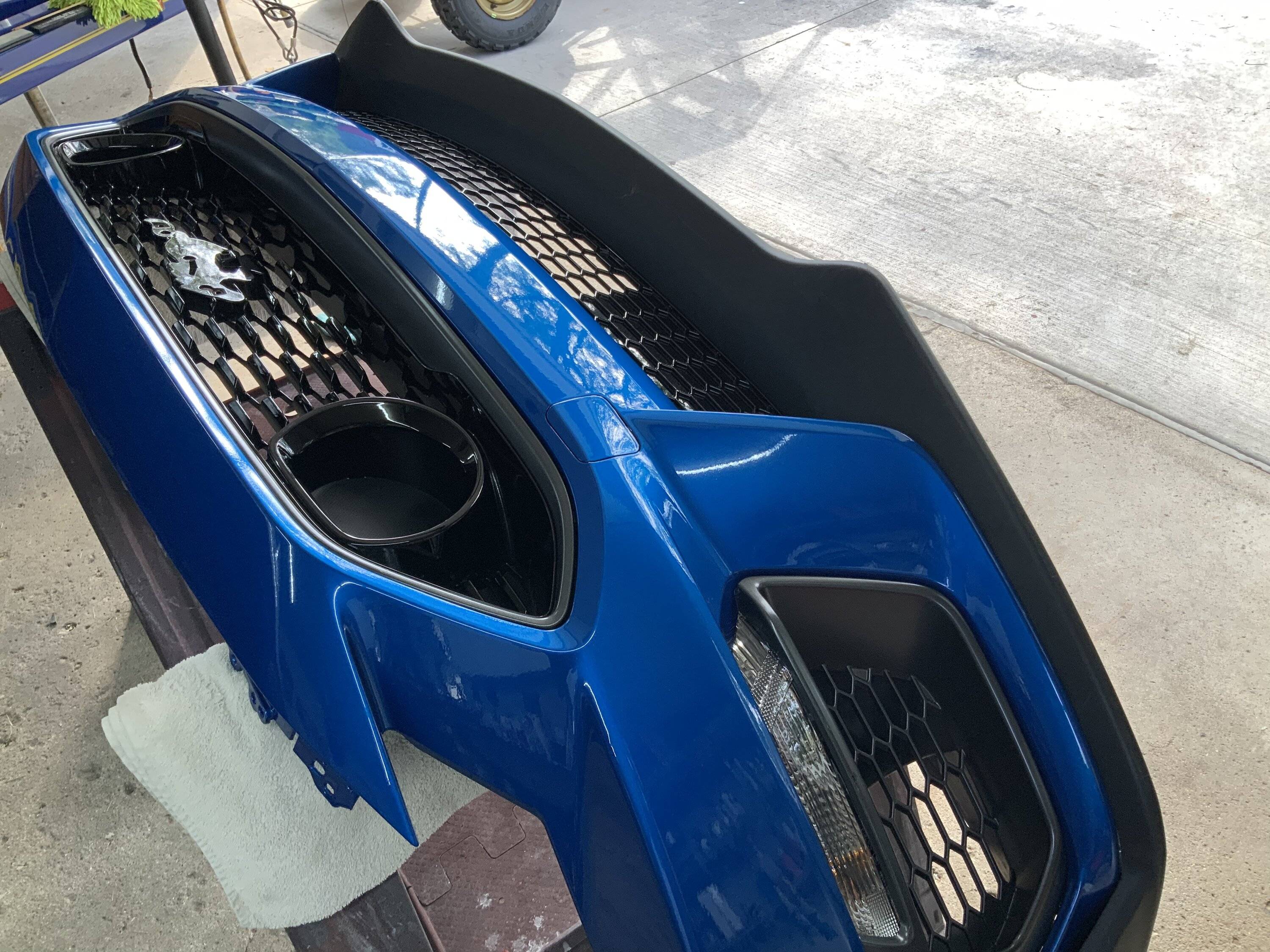

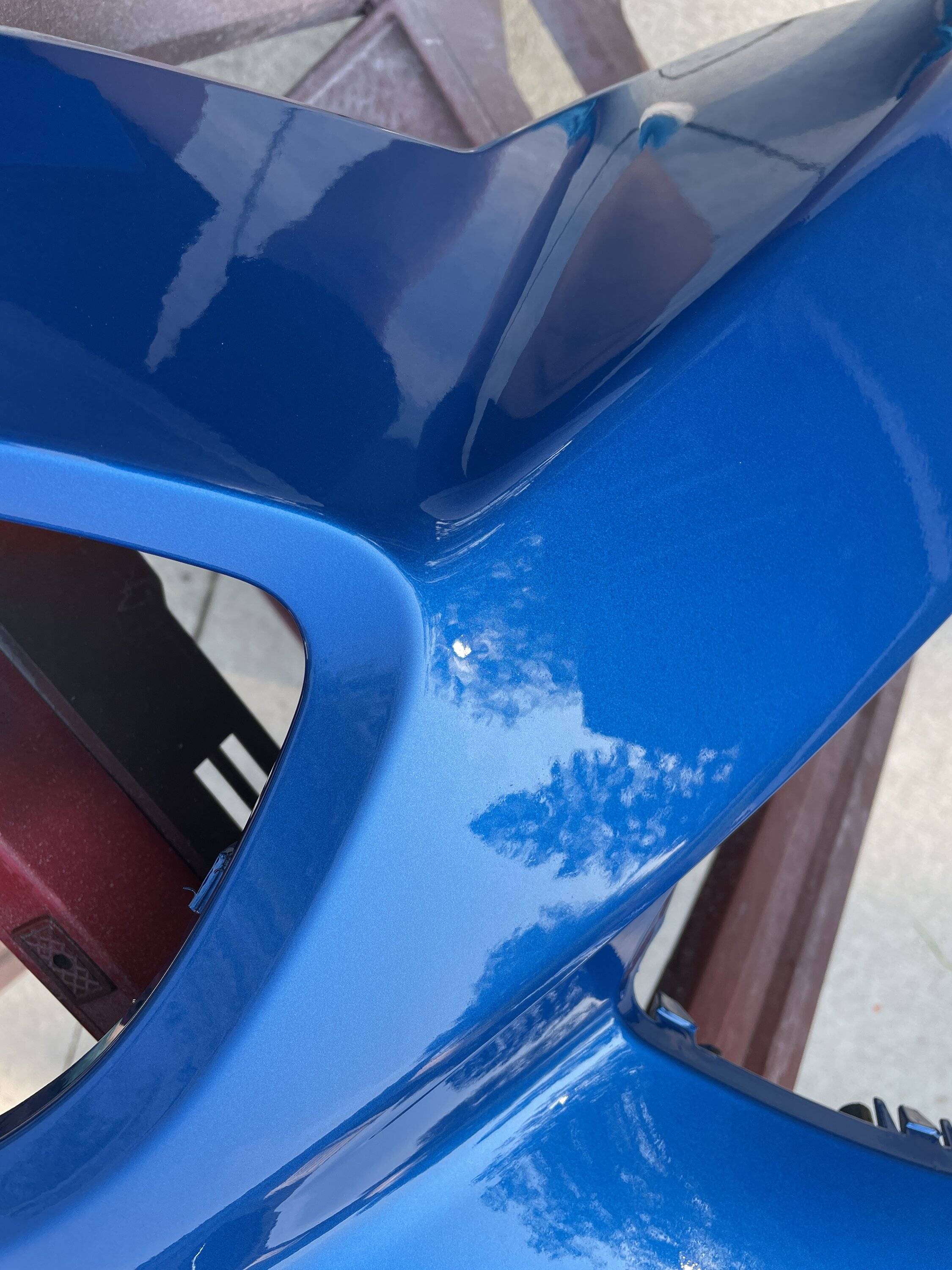

Picked up the last couple parts today to get back on the road. Plan to spray the front bumper cover this weekend and then make an inspection appointment.

Oh what the heck…. I haven’t added up my receipts yet but I’m sure I’ll be well under $40k all in. All parts replaced are new OE ford with the exception of the two bumper cover assemblies. Those were a low mileage take off and a new plant reject for paint scratches which I needed to paint anyway for color matching. I do all my own work including paint so that helps tremendously.

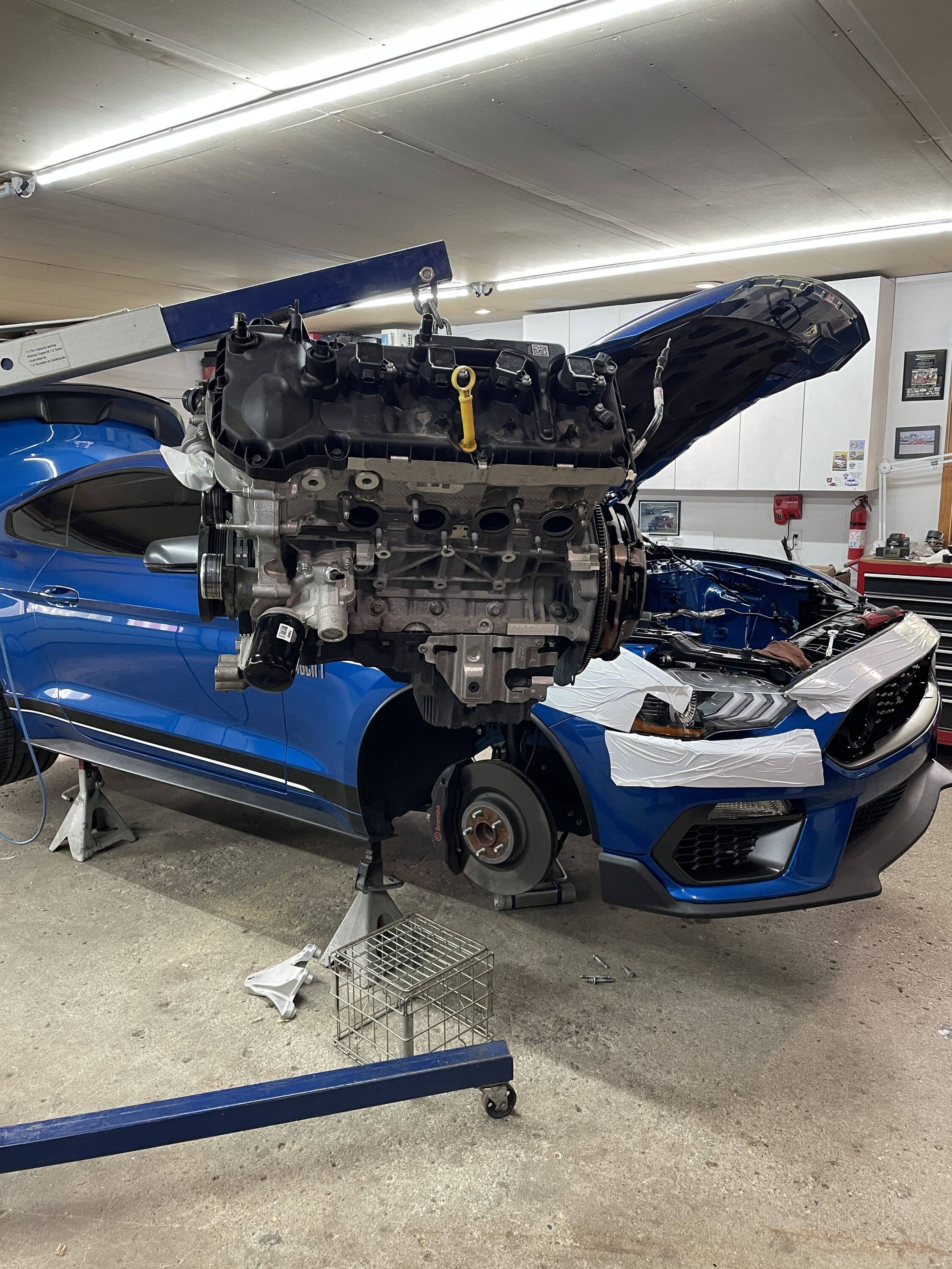

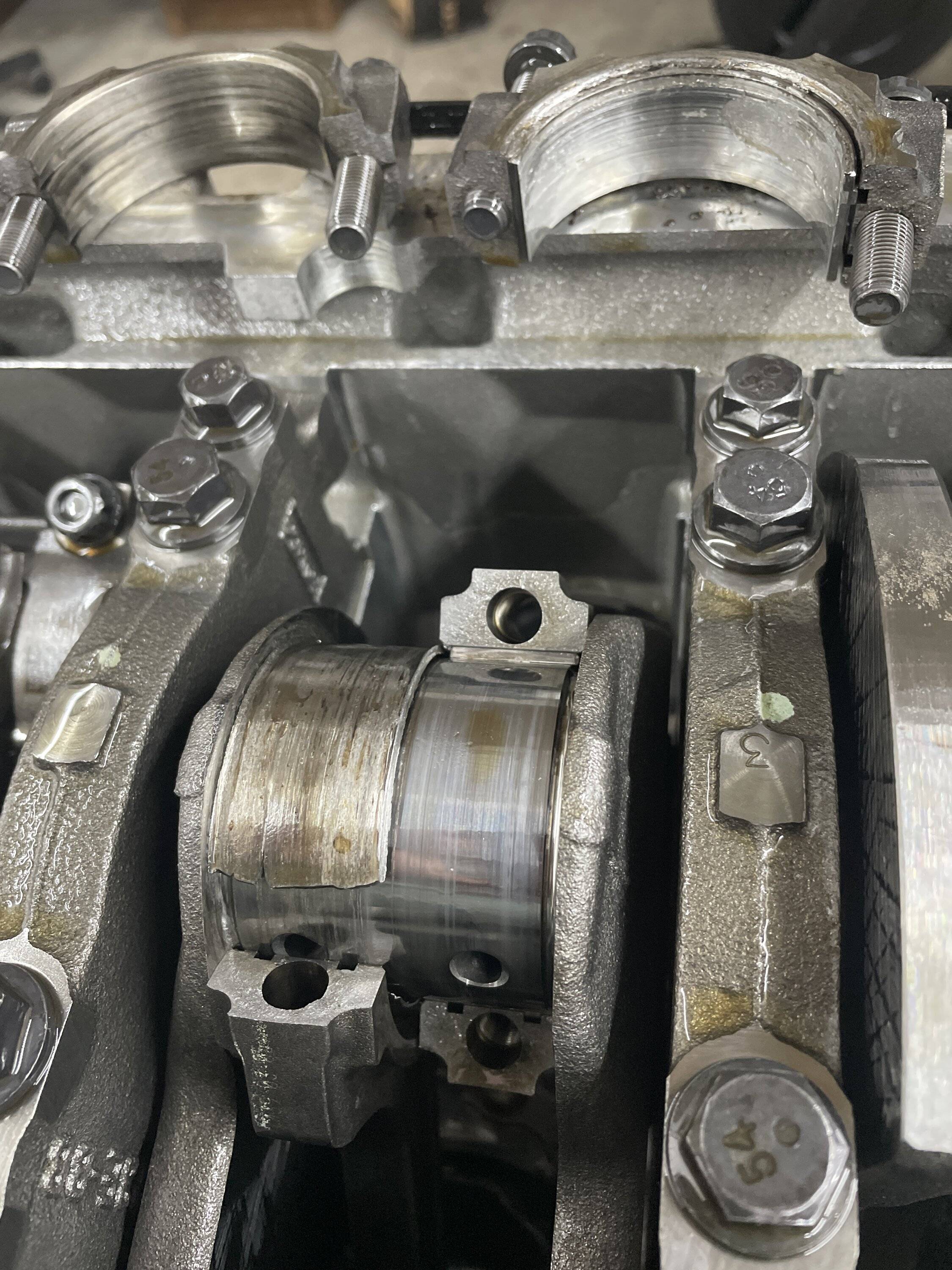

Way overdue for an update, lots has happened both good and bad….

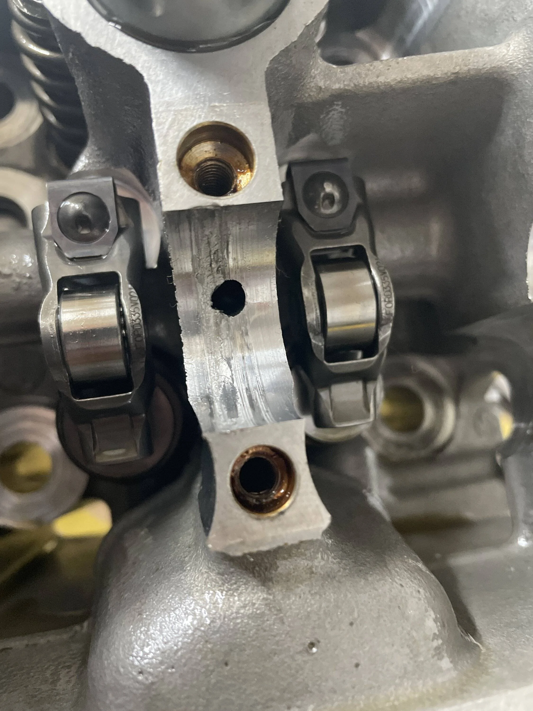

Got the car all together, state inspected, title signed off as good to register and plate. No issues went smooth. Got to drive it a bit, wife drove it once, my 16yr old son and I drove it a bit more. Car ran great, very fun, I was pleasantly surprised in its performance. That’s the good….
We put about 100 miles on it and then it developed a sudden engine noise, obvious rod knock. Drained the oil and found bearing flakes. That’s the bad.
Im not too shocked, thought I got lucky but knew it was a very possible expense when I bought it. So out comes the motor.

Appears to be an oil starve, is that the only rod bearing affected?

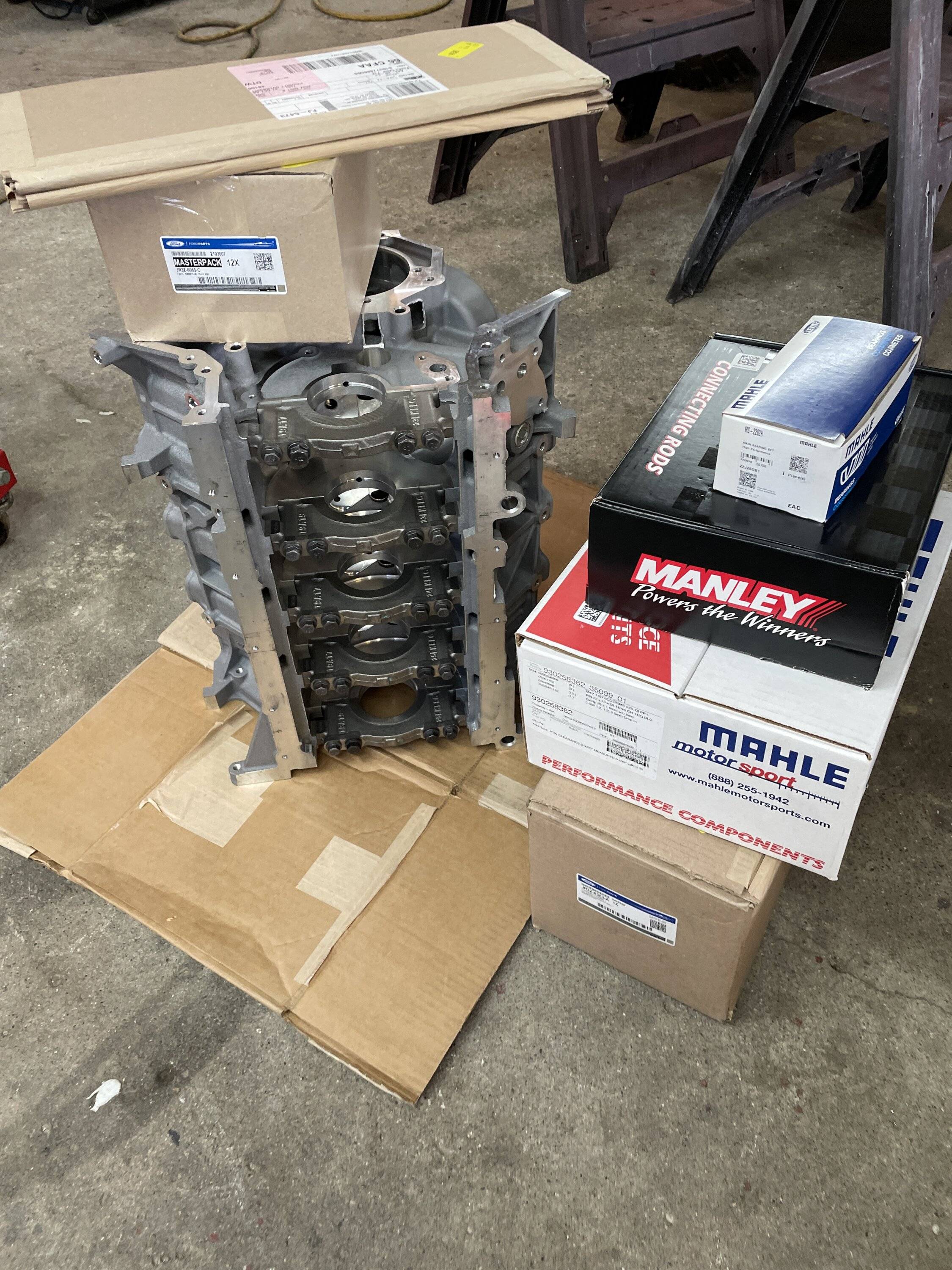

So here’s the plan for the motor…. Since i do plan to track it a bit we are going down the ā€œwhile youā€˜re in thereā€ rabbit hole, and I love building engines.
The crank could be turned and the block is definitely good but of course would need a touch hone for new rings. Since I’m a Ford employee and get a respectful discount, and the parts are surprisingly reasonable to start with I bought a new block and crank. I’m also going to upgrade the rotating assembly into an Aluminator clone using the good Mahle pistons and Manley rods. Will also do the usual oil pump and other minor upgrades.
So more stuff to post about coming, car isn’t done yet….
