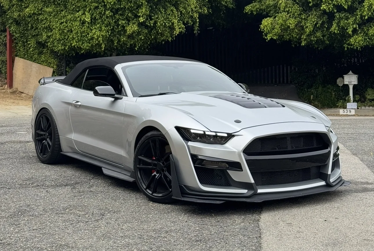

I’ve completely built mine out, including the KDT953 and Kelltrac diff bushings. I’ve listed below what I’ve done, very minimal NVH, daily drives like a dream and handles like it’s on rails.
I highly recommend the Kelltrac diff bushings, especially if you’re trying to stay low NVH/daily the car.
  • Front GT500 20x11 305/30/20 Continental DWS
  • Rear GT500 20x11 315/35/20 Continental DWS
  • Front 1" Mishimoto hub centric spacer
  • Front BMR SP089 Minimum 1” Drop Springs
  • Rear OEM base springs (ride quality and clearance for larger rear tires)
  • Both front and rear Eibach bump stops
  • Front and rear Steeda Comfort/Active shocks and struts
  • Ford PP front control arms
  • SR Performance strut tower brace
  • 6 Piston Bullitt Brembo brakes
  • Whiteline KDT953 subframe bushing replacements
  • BMR BK081 LCA Bearings
  • Ford Performance toe link bearing
  • Ford Performance toe link arm
  • New OEM vertical links
  • New OEM away bar end links
  • GT350 front and rear sway bars (non-R)
  • Kelltrac rubber/billet differential bushings
  • OEM convertible rear subframe brace
