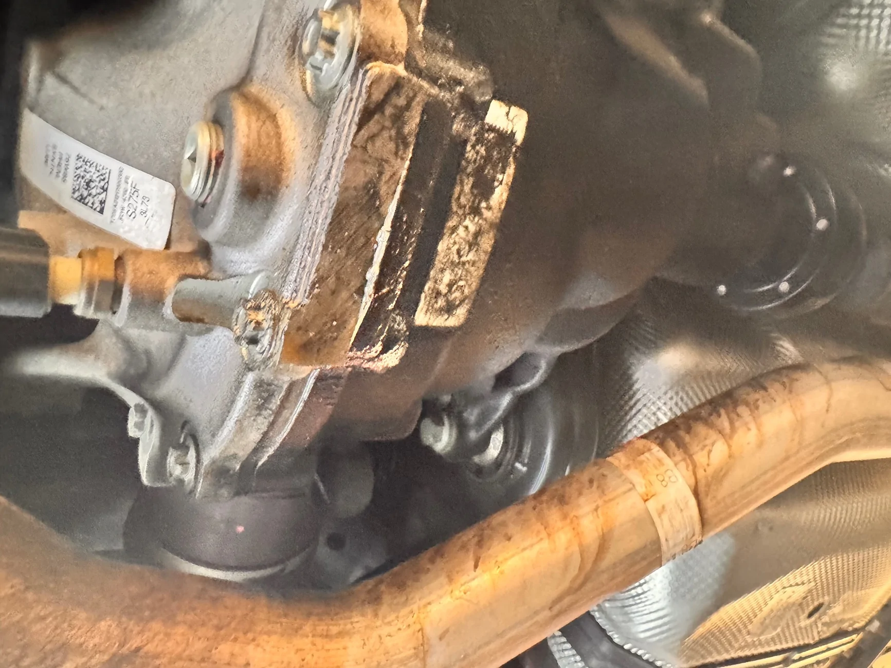

Is this just the pinion seal or also axle seals leaking? If it was just the pinion seal I’d expect it to not be coated that high up

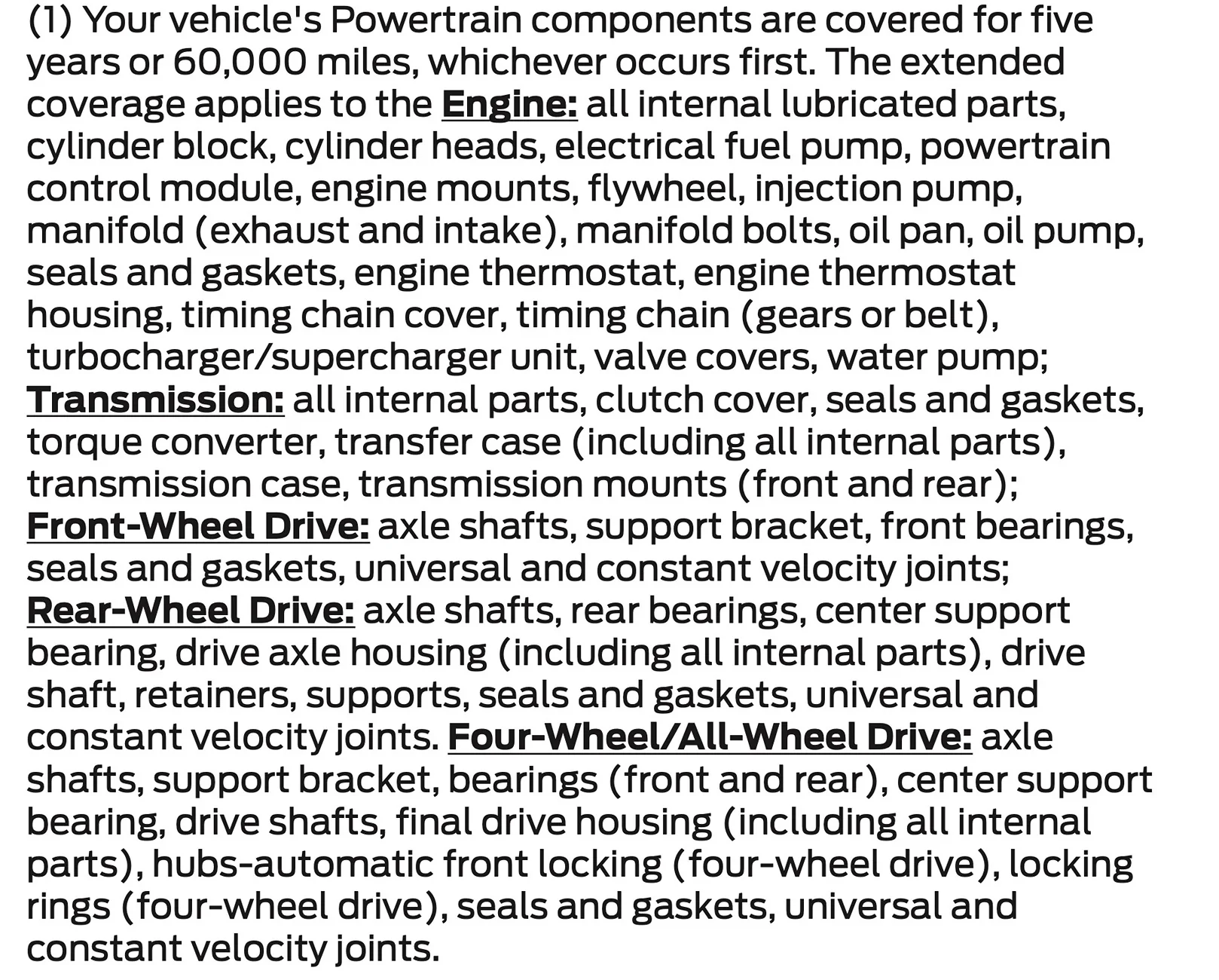

Also is this covered under the powertrain warranty? It’s a 2021 gt with 55k miles

Appears to be the pinion seal. The half shafts are dry.
Attached is an excerpt from the 2022 Warranty Guide. "Seals and gaskets" are covered. :thumbsup:
