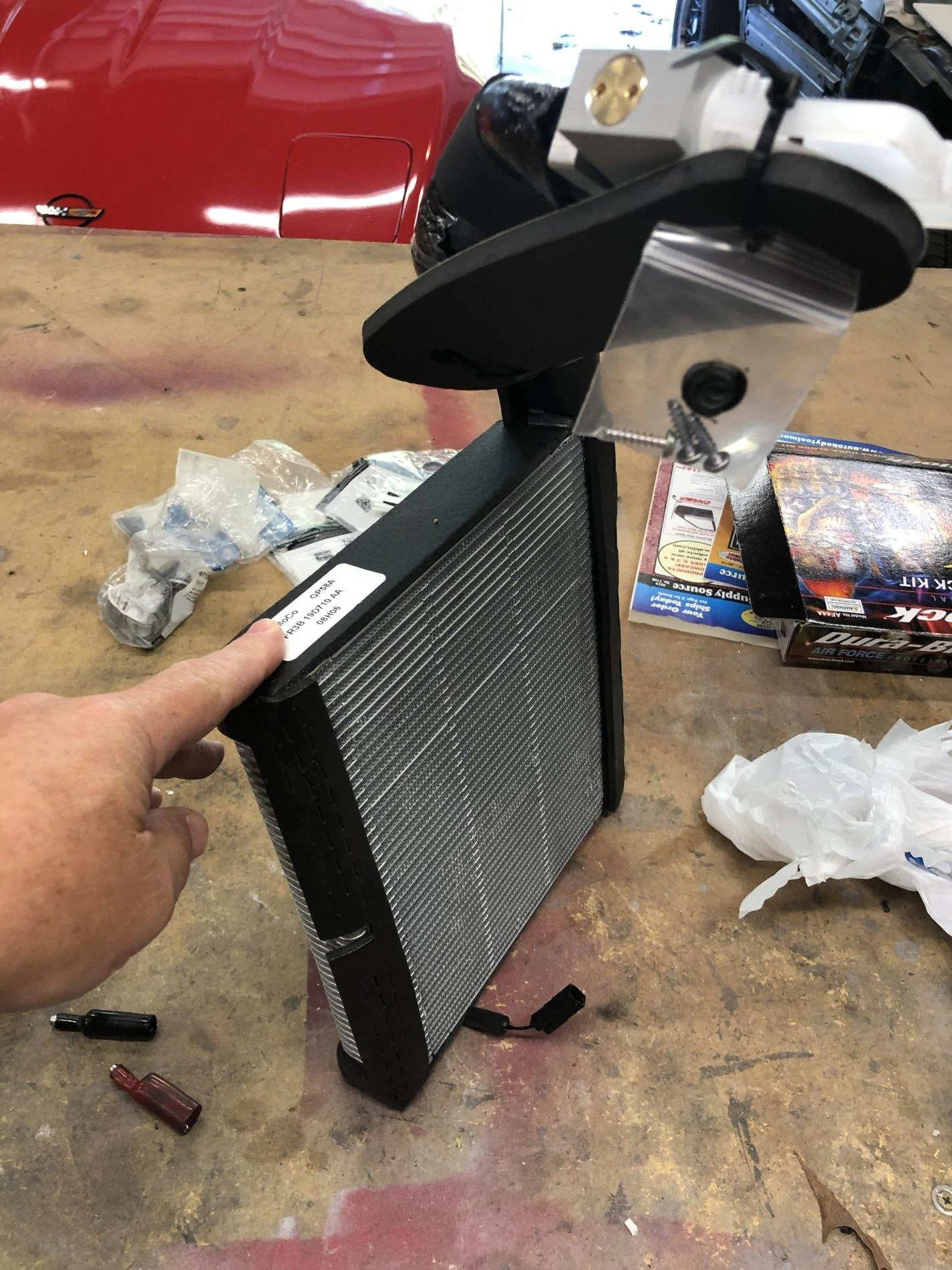

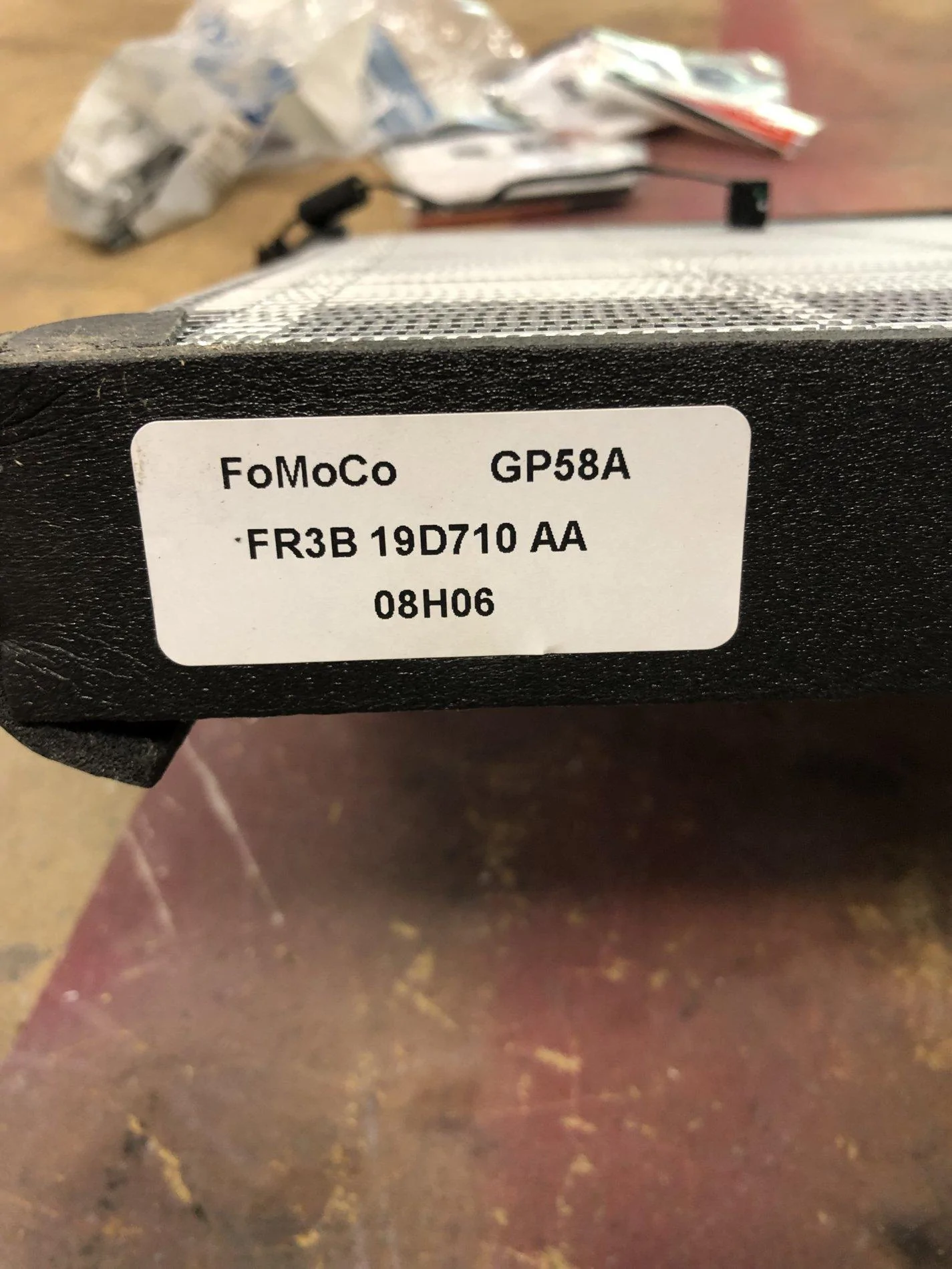

Just curious since you have purchased a new one:
If you have opened the box, is the new unit manufactured by Valeo (any manufacturer marks or stampings)? Is It also aluminum?
I do not see any markings that would indicate who manufactured it. It does appear to be aluminum. All four edges are wrapped with foam seals, so any markings may be covered up......
