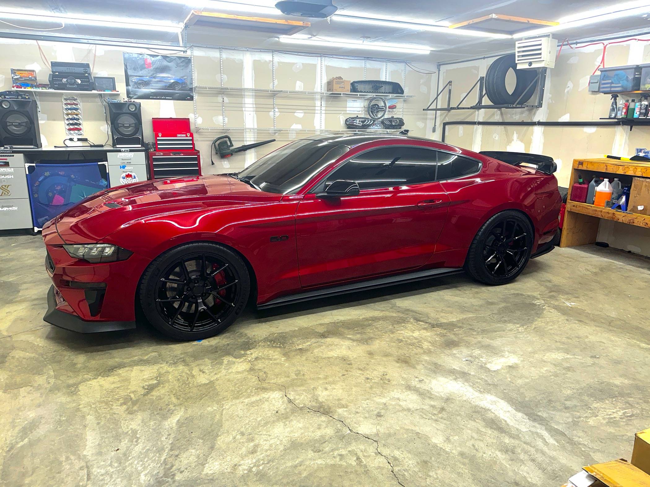

making about 700 whp on my ess just got my drag wheels with some nt555r2 tires.
what alignment should i run if i want to have grip in the straights but also be able to carve some corners with some spirited driving what still having grip as well? i assume -1.0 to -1.5 camber in the front but i have no idea what to run in the rear as far as camber and toe based of the way i was to drive with this power and setup.

Don't have a comment on the specs. But your GT looks 🔥 Looks like a fun ride. What front end is that, looks like the Mach 1 front kit? and the wing on the back? Either way :like:

Nice ride. Are those S650 headlights?
