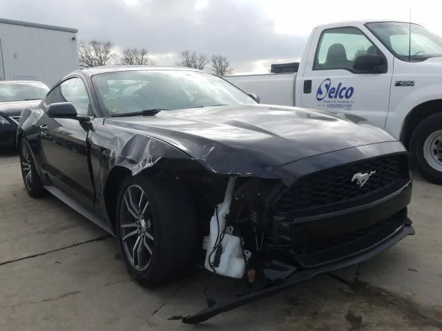

I recently got a 2015 echoboost mustang with 80k miles on it. I live in Mexico and got it from someone who purchased it salvaged through copart. As you acn see in the picture below it was crashed on the front passenger side.

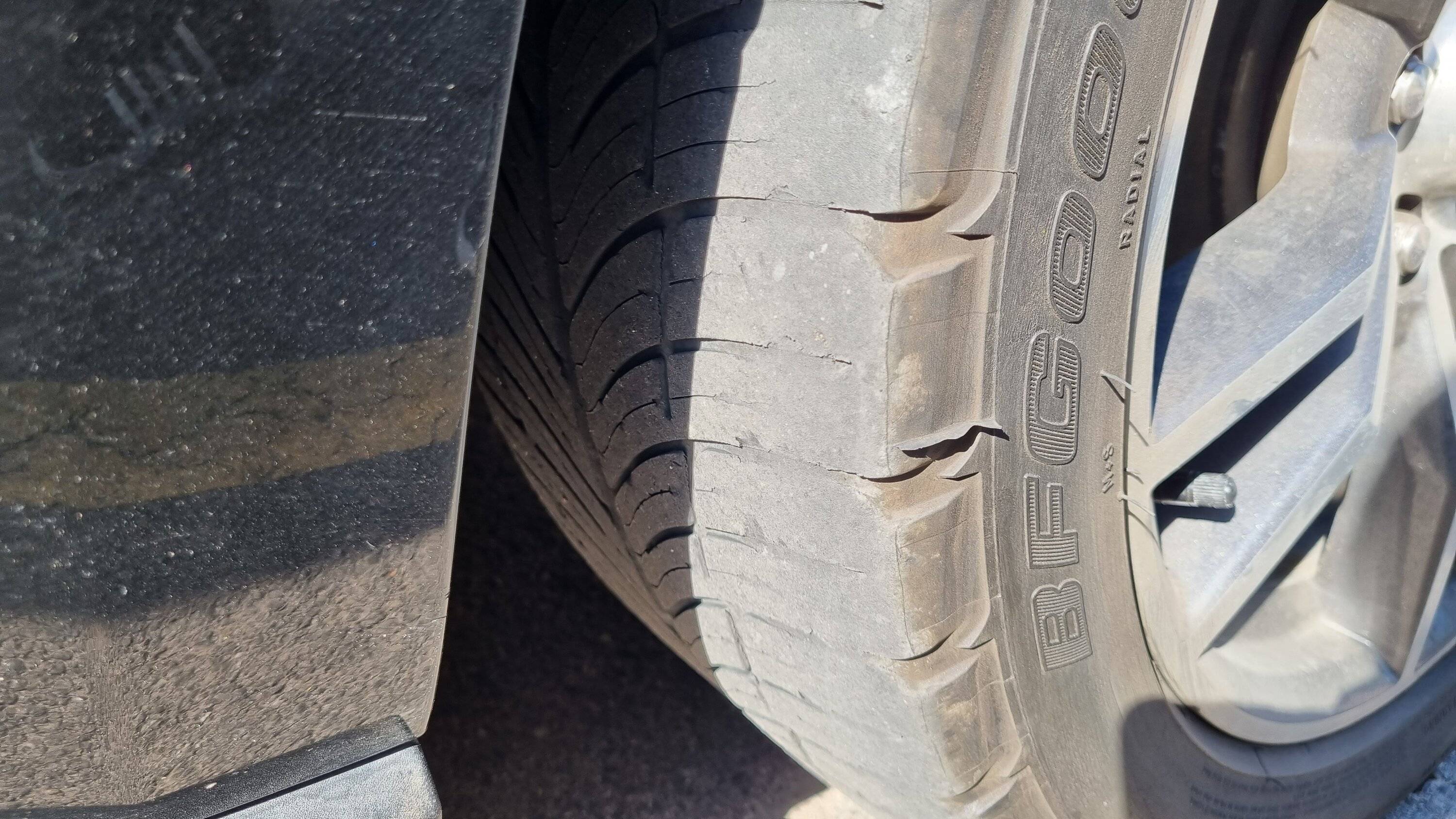

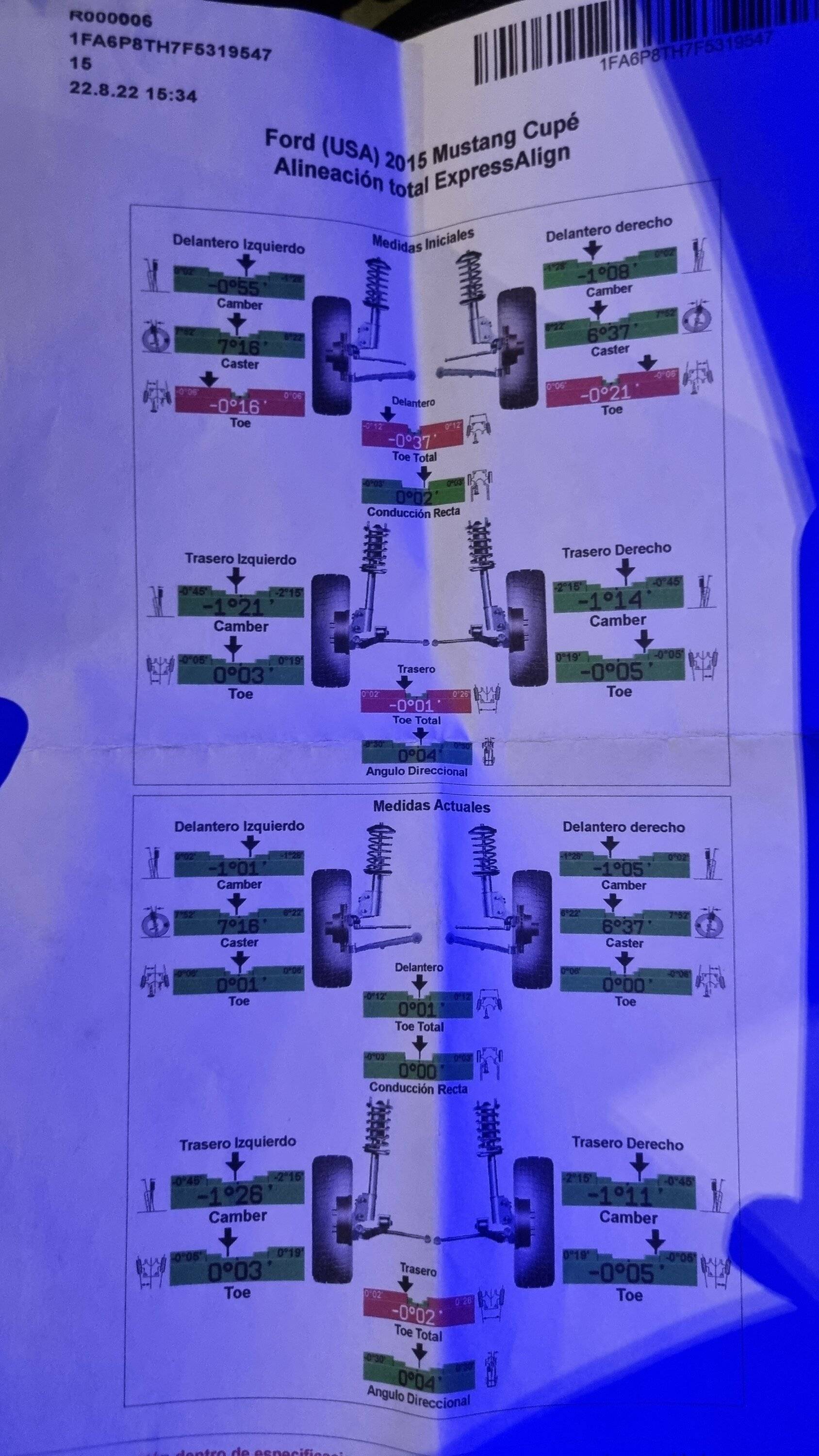

I have around 5 months with it and the tires were at least 90% of their life, but the front tires got wear on the outside but not inside. So i took it for alignment and got the results as shown below.
My question is, do you think the outside wear is due to the previous alignment? I want to get new front tires but i dont want to spend if they will wear so fast. The rear tires keep a 80% life and now they are at the front.
I was told by the shop that the caster couldn't get the same due to the crash, theres around 1 degree of difference.
